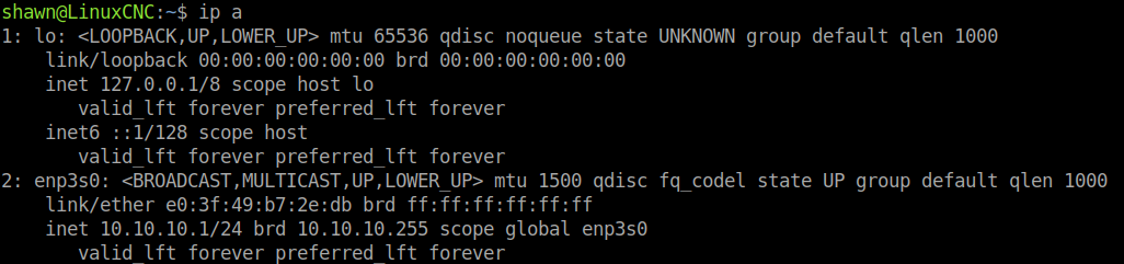

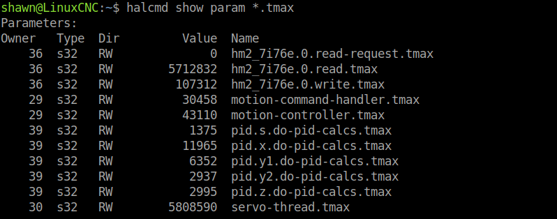

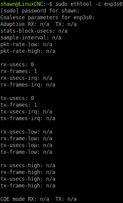

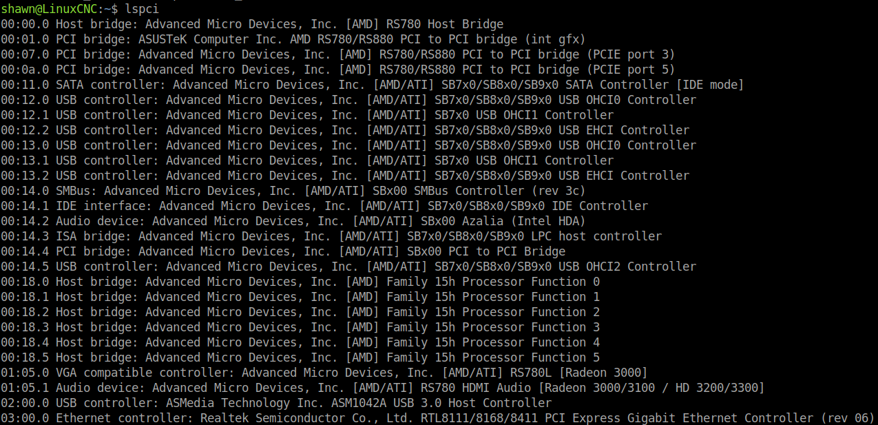

06 Mar 2023 23:50 #265990
by Sray69
Replied by Sray69 on topic Guidance Needed! Initial LinuxCNC/PncConf setup
FINALLY got all axes HOMED!!!! Since then I have been working through different errors.
This is the most current error I am getting. It seems to pop up randomly. The last time it popped up the machine had been sitting idle for 20-30 minutes with the Machine Power toggled ON. When it happened it triggered the amber light again.
I read in other threads where people were asked to provide the following info. I hope this is helpful.
I have already changed my SERVO_PERIOD to 2000000 as suggested earlier in this thread for other NIC related issues.
BTW, when the amber light is triggered, I have to turn the CNC cabinet OFF and back ON, and I have to reboot my computer. Is there a way to clear this without rebooting my computer every time? I am having to do this umpteen times per day while working through these issues.

Replied by PCW on topic Guidance Needed! Initial LinuxCNC/PncConf setup
There is no reason you should need to cycle any power or reboot after this error.
What happens if you just exit/restart LinuxCNC?
Also your 5712823 read tmax value is likely the reason for the fault
(This is in CPU clocks, so need the CPU clock frequency to determine exactly how long this is )

- Posts: 18115
- Thank you received: 5334
07 Mar 2023 00:49 #266003
The error indicated by the LED is a watchdog bite,
This is cleared when LinuxCNC starts. Sounds like it bites
again due to latency issues.
