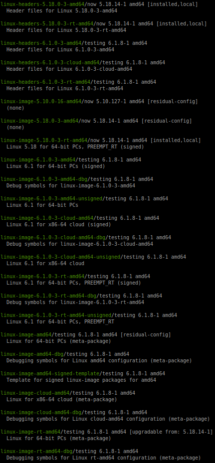

You might want to try a different kernel to see if that helps or not. I have had issues with 5.10.xx-rt and upgraded to 6.0.0-rt.
sudo apt search linux-image*
I am on 6.0 (bullseye).
linux-image-6.0.0-0.deb11.6-rt-amd64/now 6.0.12-1~bpo11+1 amd64 [installed,local]

sudo apt install -y linux-image-6.1.0.3-rt-amd64 linux-headers-6.1.0.3-rt-amd linux-image-6.1.0.3-rt-amd64-dbg

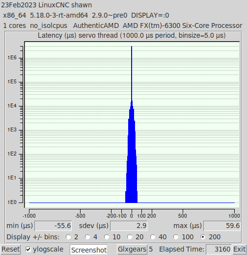

I have updated the kernel and reran the tests. The latency test appears pretty much the same as above and the network latency test is right around the same as well.
So what does that mean? Is the biggest concern the network latency? Or do both look bad?
What can I do to fix this? Add a network card?

In my experience the kernel network issues started past kernel 4.19.x.
The issue is quite hardware dependent and the 6.X kernels work acceptably
on most of my test machines (6.2 seems a bit better than 6.1)
What Ethernet hardware is on your motherboard?
Also your latency histogram shows only one core. why is that?
That will likely make your network latency worse...

Yeah I noticed the single core on the histogram. I am not sure why it is only running one core. Any suggestions on how to fix that?
