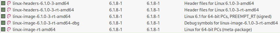

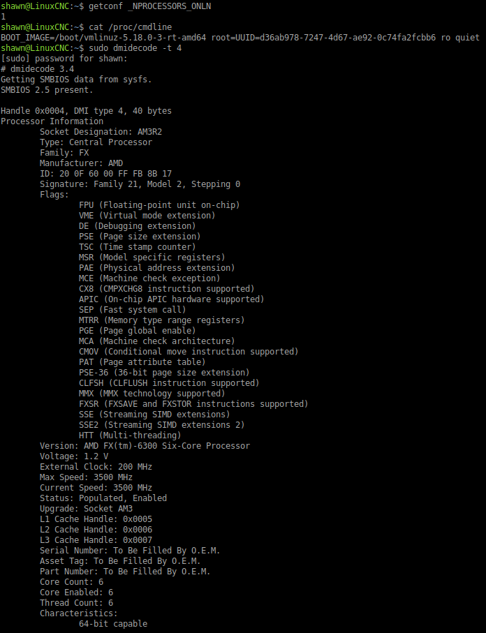

OK so I'm stumped, Kernel built with SMP disabled?
- Sray69
- Posts: 255
- Thank you received: 13
24 Feb 2023 21:55 #265283
by Sray69
Replied by Sray69 on topic Guidance Needed! Initial LinuxCNC/PncConf setup
- Posts: 18115
- Thank you received: 5334
24 Feb 2023 22:13 - 24 Feb 2023 22:22 #265284
Replied by PCW on topic Guidance Needed! Initial LinuxCNC/PncConf setup
if you boot the older kernel, does is show all 6 cores?
Answering my own question by looking at your original
latency histogram, not it does not. This suggests a BIOS
setup or perhaps hardware issue.

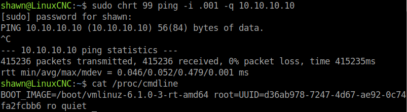

24 Feb 2023 23:53 - 25 Feb 2023 00:02 #265291
That seems a lot better (no multi ms delays)
Note that the "max" value (0.479 ms in this case) is the main one of interest
Last edit: 25 Feb 2023 00:02 by PCW.
The following user(s) said Thank You: Sray69
- Sray69
- Posts: 255
25 Feb 2023 00:07 - 25 Feb 2023 00:08 #265292
by Sray69
OK. So I should be good to go?
I only ran the test for like 10 mins. But I noticed with all my prior testing, the results were always pretty much the same whether it was an hour or 10 mins.
I also noticed no packet loss like prior ones.
Last edit: 25 Feb 2023 00:08 by Sray69.
