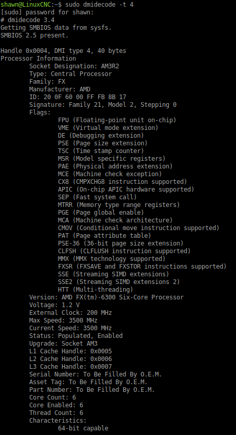

24 Feb 2023 17:51 #265255
by Sray69
Replied by Sray69 on topic Guidance Needed! Initial LinuxCNC/PncConf setup
Well I have researched this issue and have come up with no solutions.
I thought maybe I had implemented the isolcpus command at some point but I could not find any evidence of that. I wonder if I were to use that to enable all cpu's at boot if that would turn them on?
Can someone tell me how to add this to my boot process?
If not, I wonder if wiping the computer and doing a fresh install will fix this?

24 Feb 2023 19:01 #265264
Replied by PCW on topic Guidance Needed! Initial LinuxCNC/PncConf setup
Sounds like all cores are enabled
latency histogram does this:
set cores "1_core"
catch {set cores "$procinfo(cpu_cores) cores"};# item may not exist
catch {set cores "[exec getconf _NPROCESSORS_ONLN] cores"};# could fail?
I don't have procinfo on my test machine but the second succeeds:
Does that work on your machine?
set cores "1_core"

24 Feb 2023 20:37 - 24 Feb 2023 20:38 #265272
by Sray69
Input:
Result:
1
What does this mean? What do I need to do next?
Result:
1

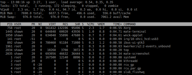

What happens if you run top and hit "1" ?

24 Feb 2023 21:11 #265277
by Sray69
- Posts: 18115
- Thank you received: 5334
24 Feb 2023 21:17 - 24 Feb 2023 21:25 #265279
Only one CPU is running, weird....
what does
cat /proc/cmdline
print?
