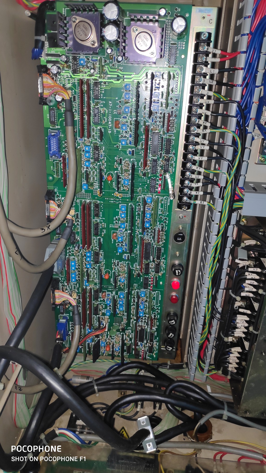

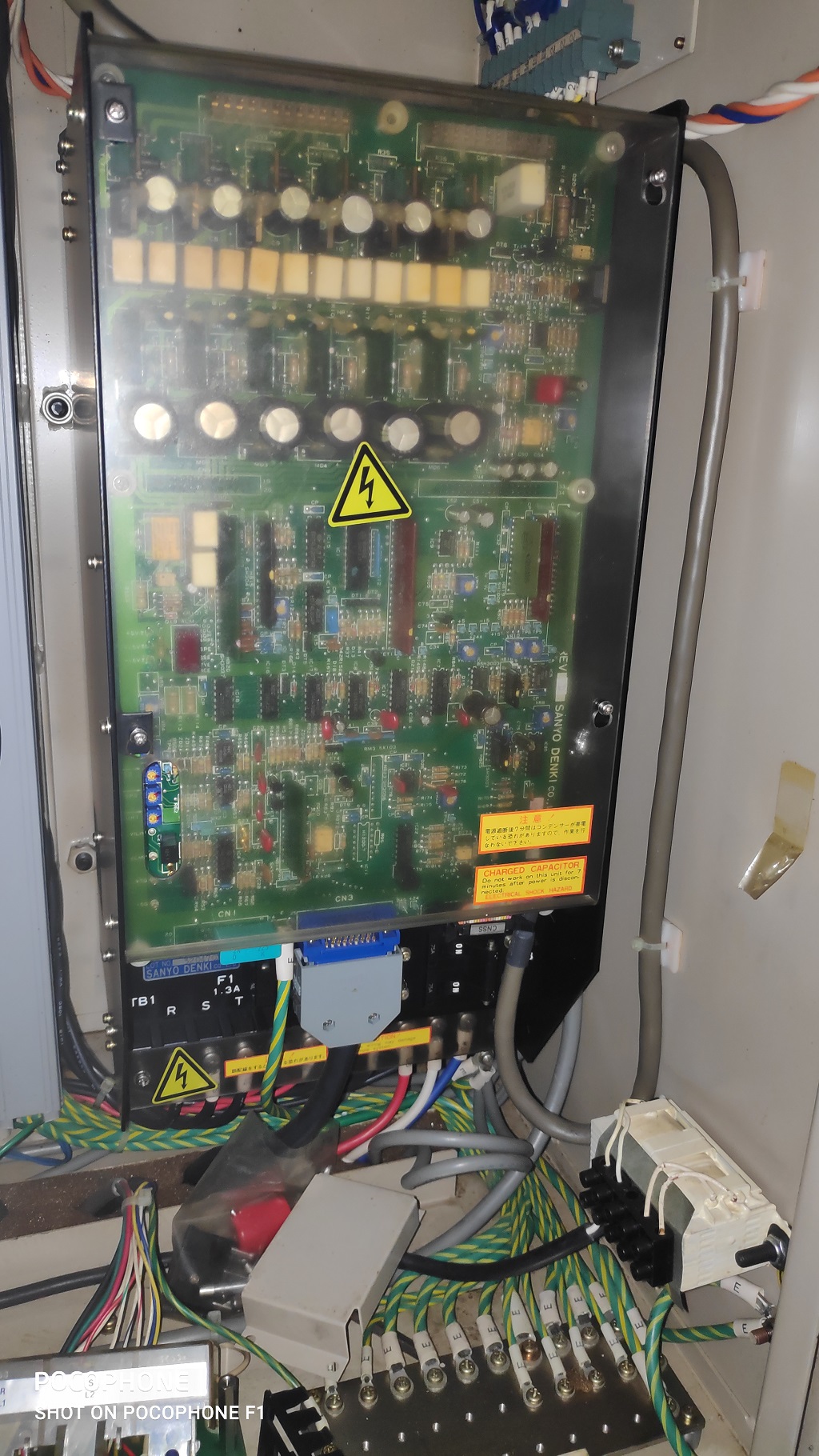

Hello everyone, my name is Aleksandar from Serbia.
I am new to the world of Linux and I would like to learn from you who are doing serious projects.
Last month I bought Brother TC-221 1986.year.
Currently reporting an error on servo drive for xyz(A7-1-10047-1D Sanyo Denki) and for spindle drive is uses 20BA150FFWB0D REV D from Sanyo Denki.
- I want to replace the old controller, which mesa cards to choose?
- I have a desire to try to run existing drivers if any of you have documentation and want to help me.

18 Nov 2020 12:12 #189700
by ihavenofish
That's the same drive i was using in my tc225 (or very similar). i would just remove it and buy delta B3 motor and drive kits. you will have a very hard time getting the original drive to behave. If the drive is working you can sell it for good money, and be far better off.
Replied by ihavenofish on topic Brother TC-225 / TC-229 adventure!
