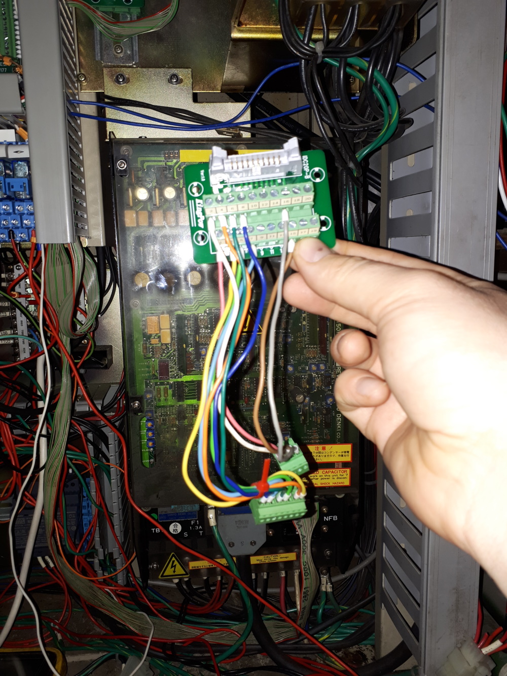

03 Apr 2020 07:54 #162542
by rmu
If you put a voltage of 10V between pins 1 and 2, the motor should spin at highest speed, i.e. 6000rpm. -10V should result in spinning in the other direction. +-5V should equate 3000rpm and so on.
Replied by rmu on topic Brother TC-225 / TC-229 adventure!
tell me more about the adaptor..
all I need this time is to make the motor spin ...not to orient the spindle ...just to rotate with the analogic signal. .
for that I need to know what signal is recommended and their position on cn2

- IceBear
- Posts: 11
14 Apr 2020 13:57 #163950
by IceBear
Replied by IceBear on topic Brother TC-225 / TC-229 adventure!
Hi!
10 days ago we purchase TC-215....so I would like join your Adventure
Amaizin that after 30 years machine is in perfect condition...all electronic still works fine.
Our plans:
- replace CN boards with mesa and make a pin compatible convertion board to use existing cables.
- will keep spindle
- keep servopack and X Y Z for a while ( in future probably replace with Yaskawa 5 servopack with 400 wh motors)
- probably will use Xplore C5 as contorl pc and touch screen (probably will make some additional buttons panel)
I have some experience in electronic, progaraming and mechanics. Open to share all info thet we have.
At this moment I
- draw electrical scheme of my TC-215 ( hope it's pretty similar to 225?)...
- have gdoc tables with all connectors and relay
- using info from this foum (MANY THANKS!!!!) I connect to drive and can move axis motors.
Have some questions at this moment and will appriciate any advices
1. could You please advice (with some explanation) best mesa set for our task. I thought ablut:
a) 5i25 + 7i77 with pci comp and monitor (benefit ti use ready project form github.com/laserK3000/tc215RetrofitlaserK3000]laserK3000
b) 7i93 (or 7i80) + 7i48 +?? ( can use Explore C5 with ethernet connection)
c) or any other....new....?
2. for some reason spindle driver don't work (come to SV error?) from my 20 pin test cable. axis drives work fine (I short enable to ground and put +-10 to 1pin) Spindle itself work fine from CN board. Could You give some advices please.
Thanks and hope You will accept me in youe Adventure
