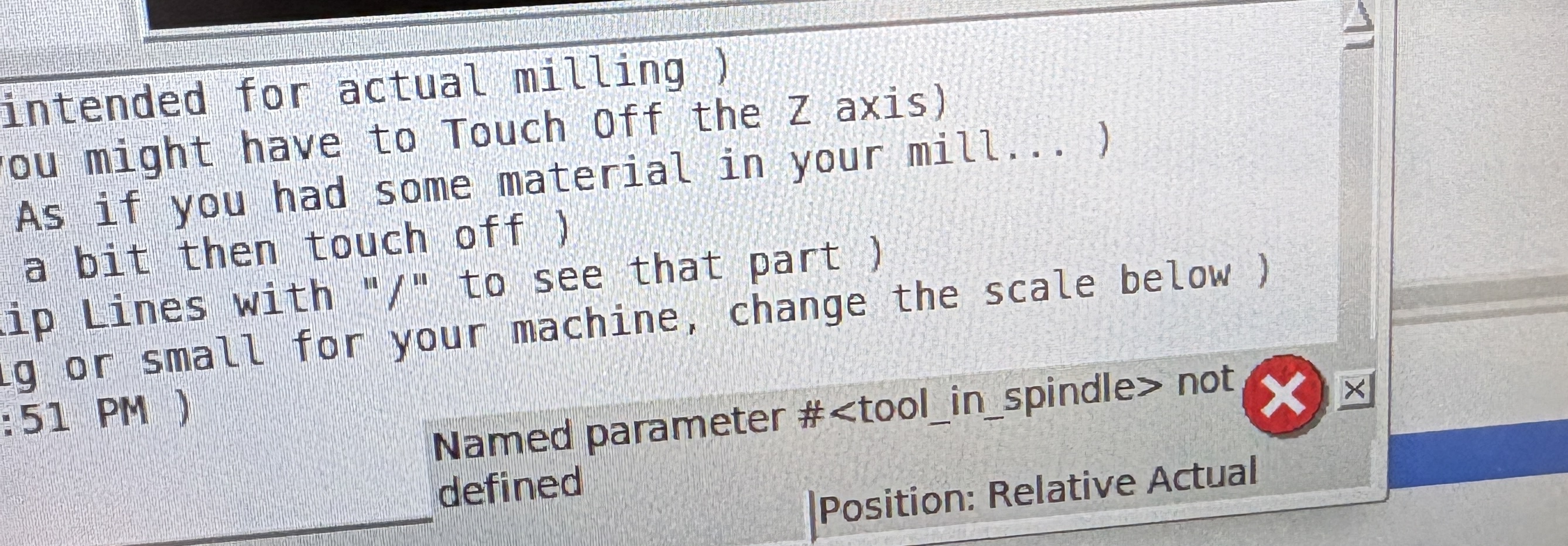

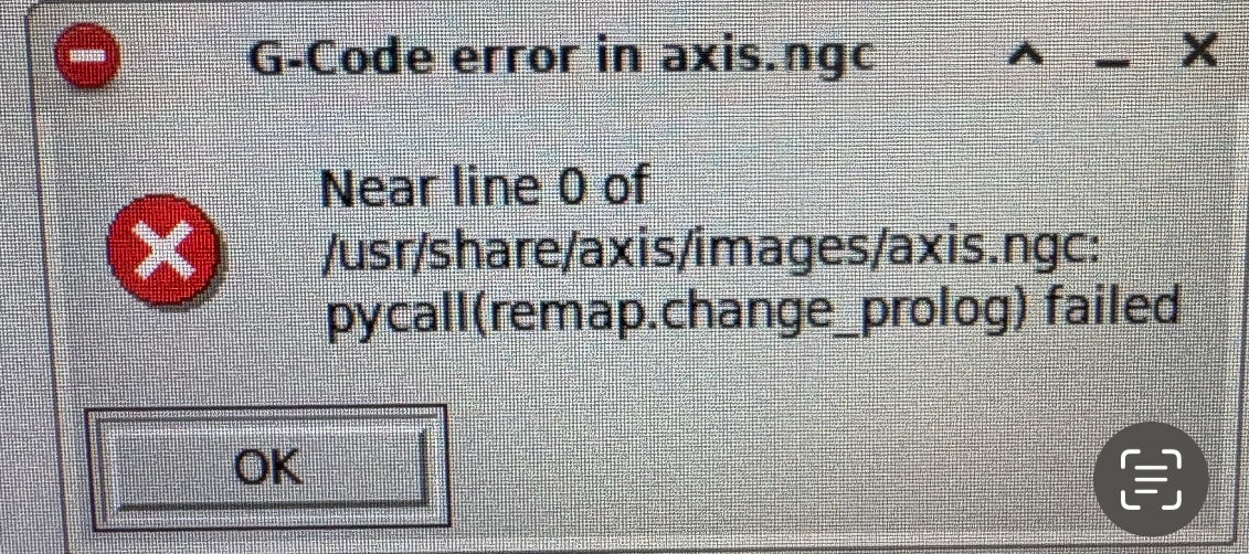

I replaced the optocoupler, and the output is working again.I attempted to set up the tool changer. Unfortunately, I keep receiving the following error messages when starting LinuxCNC. Attached is my .ini file.

26 May 2026 01:54 #346640
Replied by tommylight on topic Hurco BMC 30 AP
Those seem like two separate issues, one remap is not doing OK and the other complaining about gcode, are you running the default "Linux CNC" gcode?

10 Jul 2026 18:39 #347666
Replied by Aciera on topic Hurco BMC 30 AP
Re: forum.linuxcnc.org/30-cnc-machines/42689...0-ap?start=80#346618
1. These two errors are connected. The parameter #<_tool_in_spindle> is not defined because 'change_prolog' cannot be found.
2. Looking at your ini file it seems that your paths are messed up. TOPLEVEL should point to the file 'toplevel.py' not just some folder:
Since we don't have your complete config folder there is no telling where you have the relevant files but if you compare your setting with the built in 'sim/axis/remap/extend-builtins/' you might get some ideas.
(You will find the [PYTHON] section at the very bottom of the ini file below):
github.com/LinuxCNC/linuxcnc/blob/2.9/co.../extend-builtins.ini
