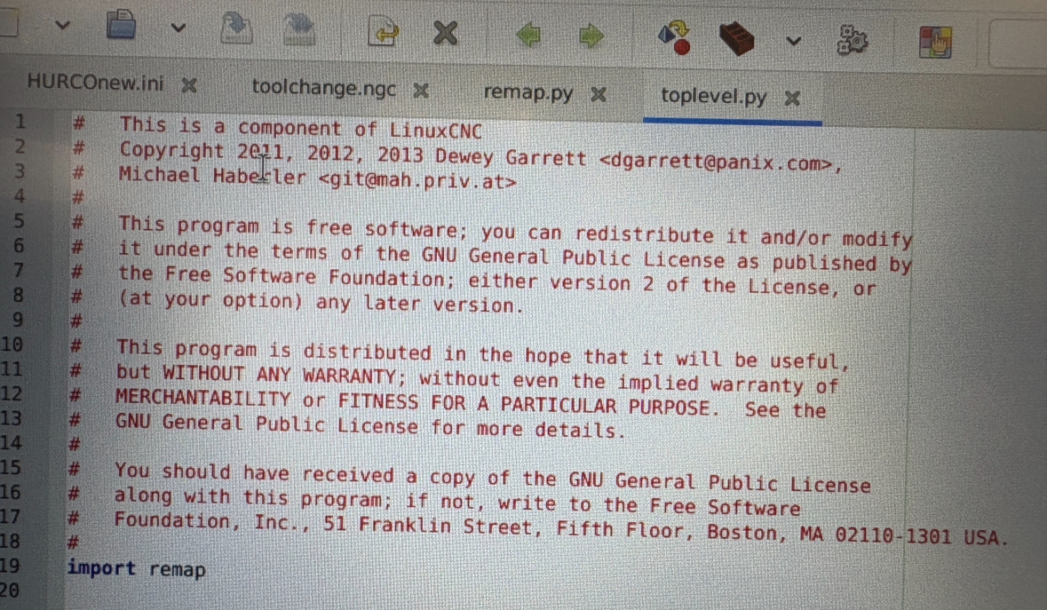

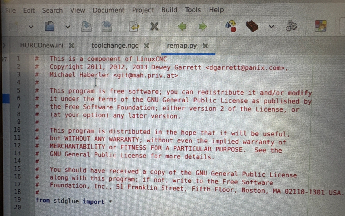

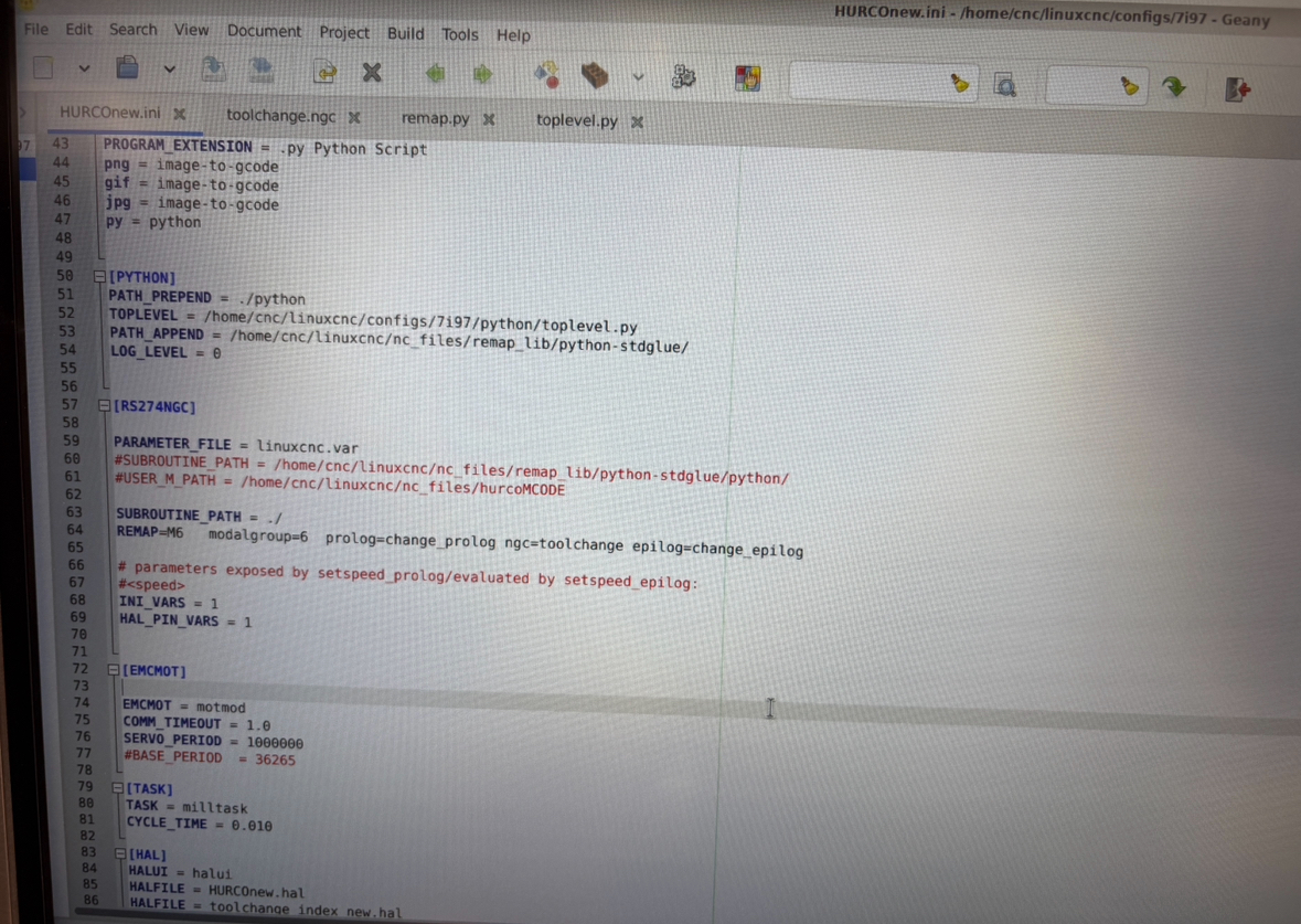

Try this:
1. in your config folder create a new folder named 'python' and put the two attached files 'remap.py' and 'toplevel.py' into this new folder
2. replace the entries in your [PYTHON] section of your ini file with this:
PATH_PREPEND= ./python
PATH_APPEND= /home/cnc/linuxcnc/nc_files/remap_lib/python-stdglue
TOPLEVEL= ./python/toplevel.py
LOG_LEVEL = 0 Please Log in or Create an account to join the conversation.

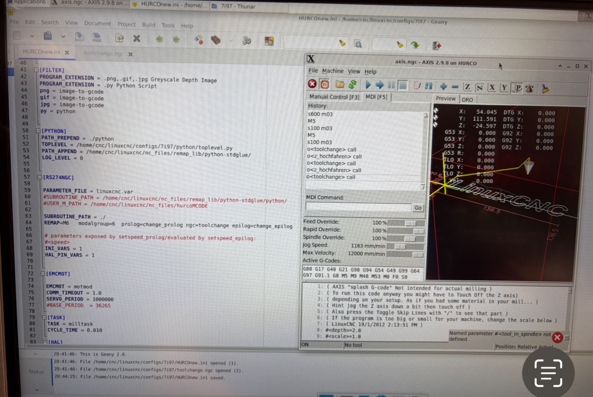

We tried your suggestion, and the error message "G-Code error in axis.ngc" is now gone.
I did, however, forget to add the "TOP_LEVEL = 0" command. I'll add that now.
I wanted to execute the command "o<toolchange> call" in MDI mode. However, I received an error message referencing the tool change program sequence: "Named parameter #<tool_in_spindle> not defined." It seems to me that this parameter hasn't been declared yet, so the system can't locate it.
Perhaps you have a solution for this problem.

Thanks for the help.I’ve now implemented everything just as Aciera described. The error persists. I think a directory is still missing here?

I just noticed that the file I attached had a date appended 'remap_2026-07-11.py', this date needs to be removed.
So make sure you go to your 'python' folder inside your config and rename that file to 'remap.py'.

I checked the folder name again today; it was correct—without a date. I also have the latest Python3 version, 3.13.5-1. The error persists.

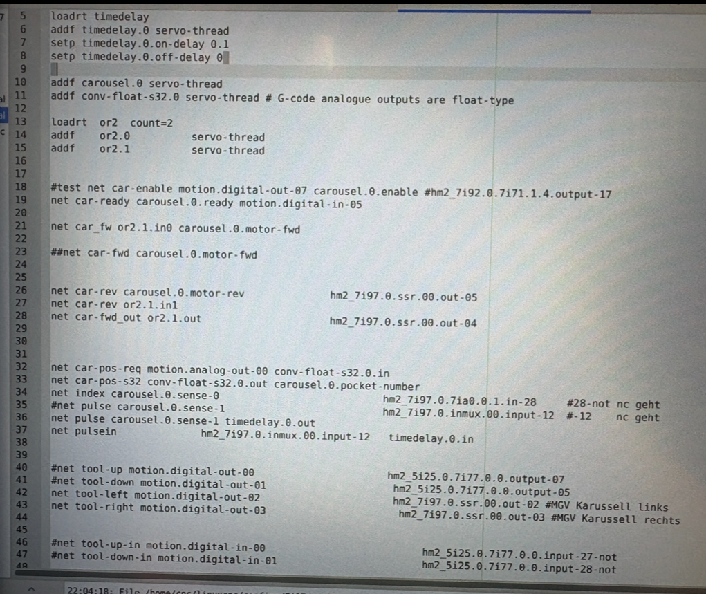

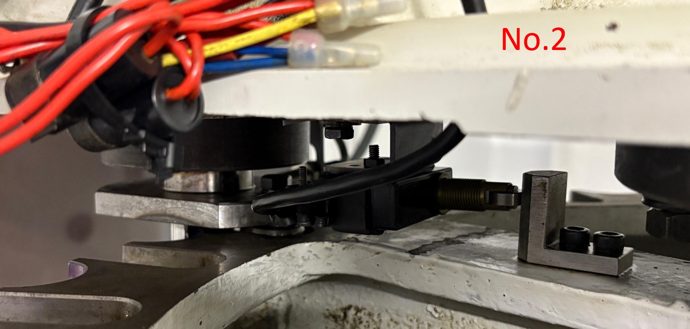

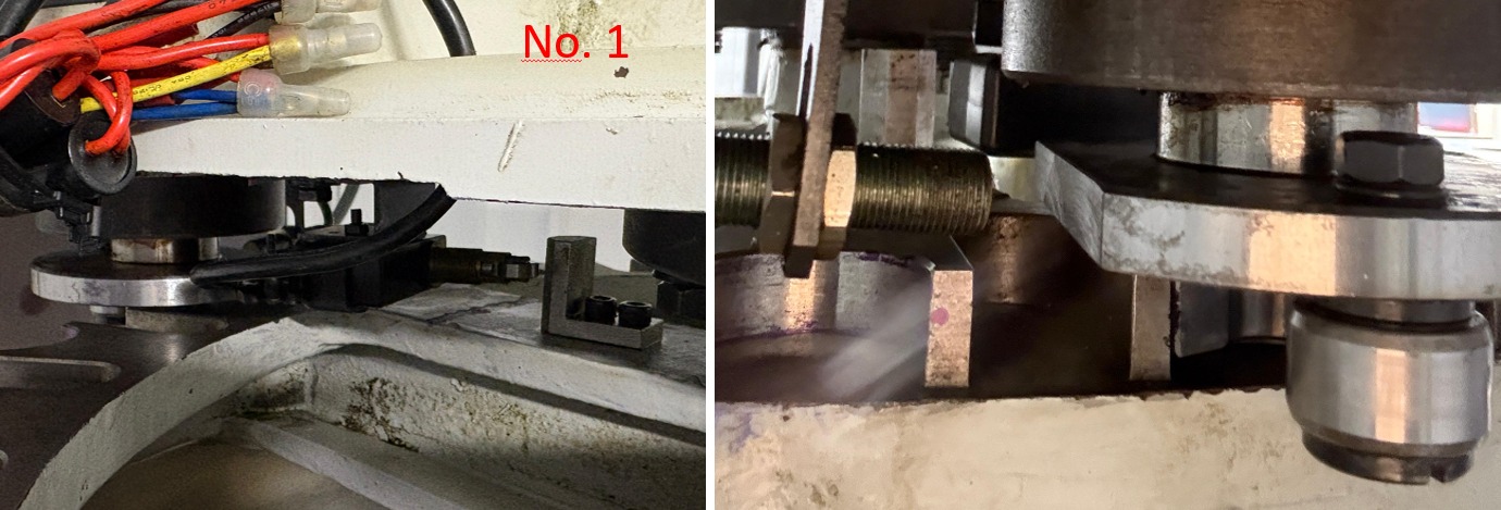

Hi everyone,I’m persisting in my efforts to get my machine finished using various methods.We’ve been trying to work with `carousel.comp`, but we’re running into issues with positioning the carousel. The cam limit switch is connected to Pin 28; it indicates the home position and is wired as Normally Open (NO). Pin 12 is connected to the proximity switch used for positioning the drive motor. It’s an NPN sensor: the contact is inactive when the cutout (missing material) passes by, and the sensor activates when material is present. Image 2 shows the program sequence as displayed in the screenshot. The problem arises when the cam limit switch (Pin 28) is triggered: the motor shuts off, but the carousel ends up positioned between two pockets. The motor needs to rotate another 180° so that the cutout aligns with the sensor. Image 1 shows the correct position—with the cutout aligned to the sensor (Pin 12)—even though the limit switch (Pin 28) has already been cleared.Can anyone suggest a solution for getting the positioning right?We’ve tried using "NOT" commands within `carousel.comp`, tried to wired as NC but haven't been able to resolve this specific issue.

Settting decel-time and align-dc should activate this behaviour.
linuxcnc.org/docs/stable/html/man/man9/carousel.9.html
If the sense of the index marker is wrong, then you can typically connect to the inverted HAL input signal that most drivers support.
For example Mesa cards have pins like hm2_5i24.00.7i64.0.0.input-00-not which is an inverted version of hm2_5i24.00.7i64.0.0.input-00
Replied by andypugh on topic Hurco BMC 30 AP
Which version of "carousel"? The newer version supports a slow-speed search for the index marker.The problem arises when the cam limit switch (Pin 28) is triggered: the motor shuts off, but the carousel ends up positioned between two pockets. The motor needs to rotate another 180° so that the cutout aligns with the sensor.
