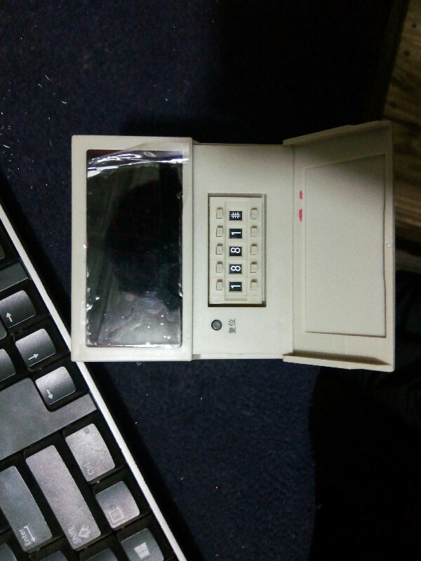

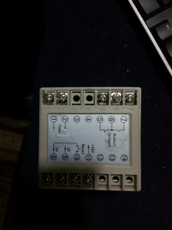

- sxyuklad
- Posts: 85
18 Aug 2016 12:47 #78988
by sxyuklad
Replied by sxyuklad on topic Urgent help required with EMC please
cncbasher
No, you did not get my point. The counter is a digital counter externally. See images attached. Not within the linuxcnc.
You can see, it has nice display. I can easily fit this inside my exterbal cabinet where my other external buttons are going to be. For now I have a few button at work, like estop. You can see it has a reset pin and pulse pin. The number of pulses it receives, it shows the number. So the idea is I want to send out exact number of pulses as to what the current tool is. So I hope you better understand now why I want to show tool no. It is for a nice looking machine cabinet.
