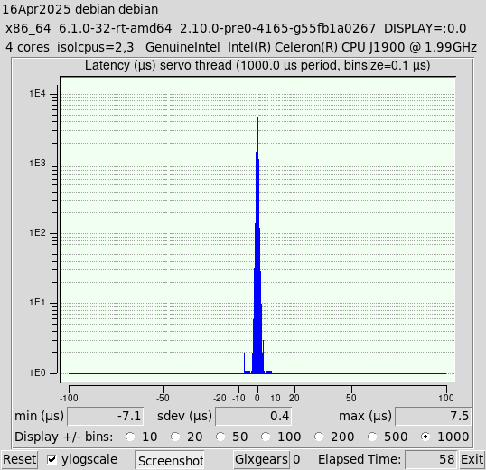

the latency debian 13 is very bad.
We have to come up with an idea to
solve this.
solve this.

Latency or network latency?Hi,
solve this.
- Grotius
- Posts: 2419
- Thank you received: 2349
15 Apr 2025 14:30 #326377
by Grotius
Replied by Grotius on topic LinuxCNC S-Curve Accelerations
HI Rod,
A tester send me this :
Debian 10 : jitter max 45200
Debian 12:jitter max 29000
Debian13:jitter max 522000
Ir looks very bad.
Ir looks very bad.
- Posts: 21980
- Thank you received: 7481
15 Apr 2025 17:05 #326385
Replied by tommylight on topic LinuxCNC S-Curve Accelerations
Debian 13 does not seem to be using an RT kernel, based on the numbers, but it just might be, i know i had worse on a new PC back in 2020, with RT kernel it would not do anything under 6000000 (yes 6 million).
That was an outlier as i have used over 50 PC and laptop from then, but never that terrible.
I do have a Dell laptop that does that, even with RTAI kernel, if anyone is interested.

15 Apr 2025 17:19 #326388
by Grotius
The used kernen in debian 13 :
linux-image-6.12.21-rt-amd64
I havent done the latency myself so far.
For the tester i will make a debian 10 with his current kernel.
But somehow we need a better kernel for debian 13. This looks not usable at all.

15 Apr 2025 17:50 - 15 Apr 2025 17:53 #326389
Replied by rodw on topic LinuxCNC S-Curve Accelerations
I think something is wrong with his setup. He needs to review my Google drive doc to optimise the performance.I thought I had Debian 13 running here at home but it is on my work computer.But even so, his Debian 12 latency seems high. Ethercat is installed on this PCHI Rod,A tester send me this :Debian 10 : jitter max 45200Debian 12:jitter max 29000Debian13:jitter max 522000Ir looks very bad.

15 Apr 2025 18:01 #326391
Please ignore the custom kernel here but follow all other optimisations
docs.google.com/document/d/1jeV_4VKzVmOI.../edit?usp=drive_link
There are many new features like energy efficient Ethernet that need setting for best latency
