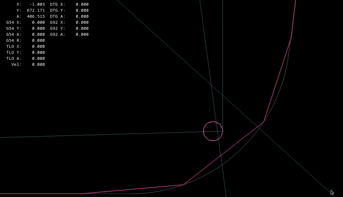

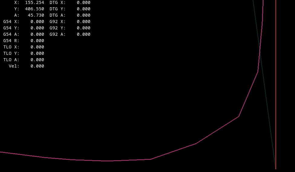

I think there is much more to do and to finish because there are great jitters during running cloud of point... it can not approximate it and the computations last too much time(sometime mills and more) to finish ...
for signle G2 G3 it is working well ...
I have talked with Michel, he said, he ends with lcnc and tp at all ...
Now it is on us ...
Now it is on us ...

if calculations are fitted in the servo thread time(which should be 250u as industrial standard) it should be nice to see or try something new ... for 7 phase generator is lcnc waiting many years and it is step to its adulthood
Michel told me to update his code but from my point of view If anybody on anyhardware will want to use it .. it will me close to imposible create a rt stuff for calculations ... I think it has to be splitted to rt and non rt part which will buffering each other for reaching as small as possible servo thread times
I am not expert in that at all...

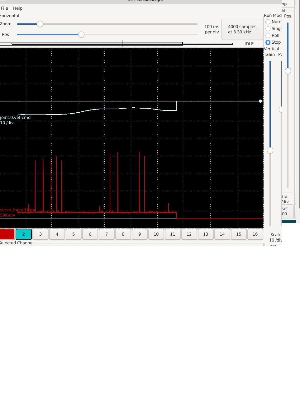

wow it works pretty well!
great job
there is some peaking but much less then I expected ... servo period is 250 000ns
I reduced BASE_PERIOD down to 50000 ns and peaking is weaker ...
Testing at real setup isolated last core is with cold system latency 12.37us
great job

your job is amazing ... i am watching the scope curves without the breathing ....
conculations of polynomes of 5th grade probably take some power ... for more axis at same time can introduce jitter and at cloud of point it will be most visible ...
I am actually testing it at 1000us 500us and 250us which is most commom industrial scan time ... intel core duo, i5 and i7 ... every has different computation capacity but jittering are present during clouds
I will take some more time and I will post outcome
thank you for your job! is very interesting
Last edit: 01 Jan 2026 21:28 by endian. Reason: editor messing
