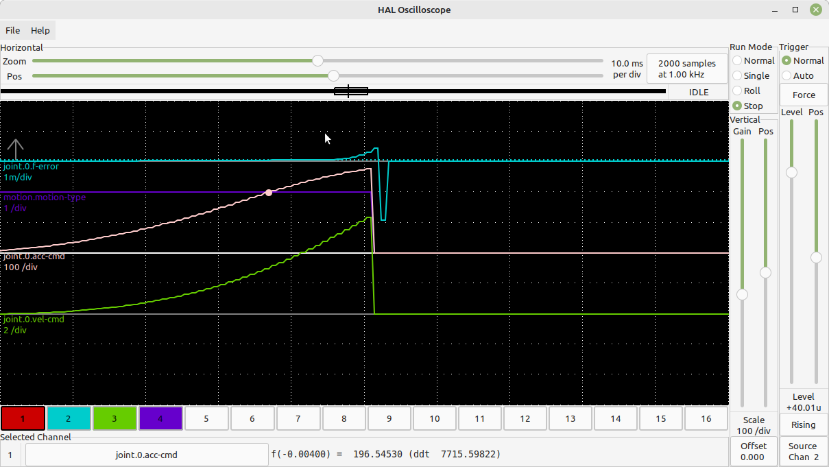

27 Apr 2025 03:28 - 27 Apr 2025 03:31 #327125
Replied by PCW on topic LinuxCNC S-Curve Accelerations
I looked at the sim config an edited a mesa config to add the new TP, but it does
show major acceleration spikes (~500K) lasting 1 servo period. I needed to set
large following error limits to avoid the spike triggering a following error.
Note that this is not hardware related but may have a relation to scaling so I can try again
by modifying the sim config to make sure everything else remains the same.

29 Apr 2025 20:57 - 29 Apr 2025 22:25 #327314
OK it does work, my test configuration was missing the
default/max velocity and accel settings in the TRAJ section
of the .ini file. This (missing values) seems to work with the
standard TP (maybe it has some kind of working defaults)
but fails with the S-Curve TP.
Note that I can still trigger following errors with actual
hardware as the S-Curve TP does not seem to obey joint
acceleration constraints.
The TRAJ and joint accelerations are both set to 200 here:
But that acceleration is exceeded (and trips a following error when
it exceeds the hardware's accel limit of 240)
Last edit: 29 Apr 2025 22:25 by PCW.

30 Apr 2025 10:18 #327333
by Grotius
Replied by Grotius on topic LinuxCNC S-Curve Accelerations
Pcw,
Thanks again for your effort.
What do you advise at this moment?
You can tune the planner with scurve jerk value in the hal section. This changes the accelation profile.
This jerk value is not integrated to the .ini file so far.
I assume you could tune your ini config to run without following error? Or is this not the case?
Indeed if you set acceleration to 200, the scurve max acceleration will be 400 at inflection point.
Exceeding your max acc off 240.

30 Apr 2025 16:25 #327365
I will try this, note that this is a difference from LinuxCNCs standard TP where the
acceleration bound in the ini file is obeyed at all points.
(unless you have backlash compensation enabled)
- Posts: 18111
- Thank you received: 5330
30 Apr 2025 19:24 #327378
I get the same error even if all accelerations are set to 100 in the ini file

01 May 2025 12:12 #327419
by Grotius
@Pcw,
Thanks for reporting this. For now i will keep this in mind, and will test this later on.
The [TRAJ] section is responsible for setting the planners max-acceleration values.
The planner doesn't look at the individual joint max acceleration values. Maybe that is causing trouble.

01 May 2025 13:08 #327428
I did set the acceleration in the TRAJ section, it does affect the acceleration
but the scaling seems not to be correct. The Acceleration/Velocity bounds are important
since they are per joint physical limitations.
(sorry if I am getting out the sandpaper when construction is at the chainsaw stage)
It is great so see a jerk limited profile working with LinuxCNC as it fixes the inevitable
following error at the start/end of motion due to the impossibility of having instant force
application in any real drive system.

06 May 2025 17:35 #327868
by Grotius
Hi Pcw,
Can you try once more with Mesa?
In the repository :
git pull
cd cmake
./build_cmake
Added pins to monitor at runtime:
tpmod.hal_component_max_cycle_time_ns
tpmod.hal_component_max_cycle_time_scurve_ns
Param to start with, also influences max acc :
tpmod.hal_max_jerk = 5
Then the above pins must stay below ~50000 nanosec at runtime.
Everything above 1000000 ns is bad.
We have now 3 configs wich run scurve. 1 is in Slowakia and runs like a rocket on delta servo's.
My ethercat steppers run, but not optimal as my desktop pc has bad latency. Base thread & ethercat apptime = 80000
Another machine is in Italy and had bad .hal config wich broke the scurve at runtime. Now that is fixed, it run's.
