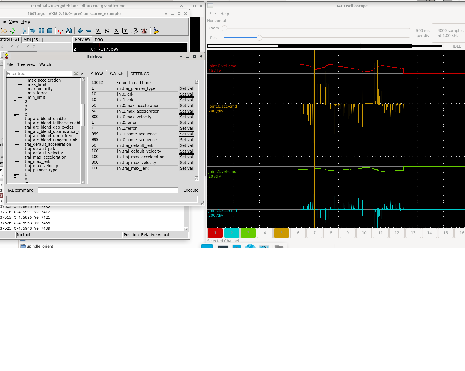

09 Jan 2026 07:46 - 09 Jan 2026 07:55 #341197
by endian
Replied by endian on topic LinuxCNC S-Curve Accelerations
next testing round in 3d contouring, 25k line and later are critial and we can observing high accel-cmd peaks ... I am not expert, I need to ask you guys before create any outcomes... I can chare gcode file but here it exceeding limit
Last edit: 09 Jan 2026 07:55 by endian. Reason: editor messing - picture of scope was not present

09 Jan 2026 08:40 #341199
by grandixximo
Replied by grandixximo on topic LinuxCNC S-Curve Accelerations
Short segments seems to have some bug, might be next week for a fix...

10 Jan 2026 11:44 #341231
by grandixximo
@PCW
try with
setp ini.traj_max_jerk 3000
and
setp ini.traj_default_jerk 3000
I do not get acc violation with these values, can you confirm?
try with
and

10 Jan 2026 12:29 - 10 Jan 2026 12:31 #341232
by grandixximo
@ruediger123
at the moment jerk-cmd are debug pins, they are not to be used for machine control, because the current calculations try and do best we can to calculate and blend quickly in realtime, there are knowm spikes in the jerk-cmd, please look at vel-cmd and acc-cmd everything looks very good to me there, there are no violations there, if we were to respect jerk cmd strictly the interpolation would not be able to run as fast as it does, but we could look at making a stricter mode viable as an alternative, or possibly the default if that's what the community needs.
