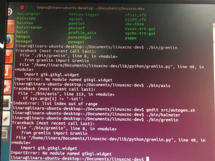

thank you sir.I try it but still have other error.

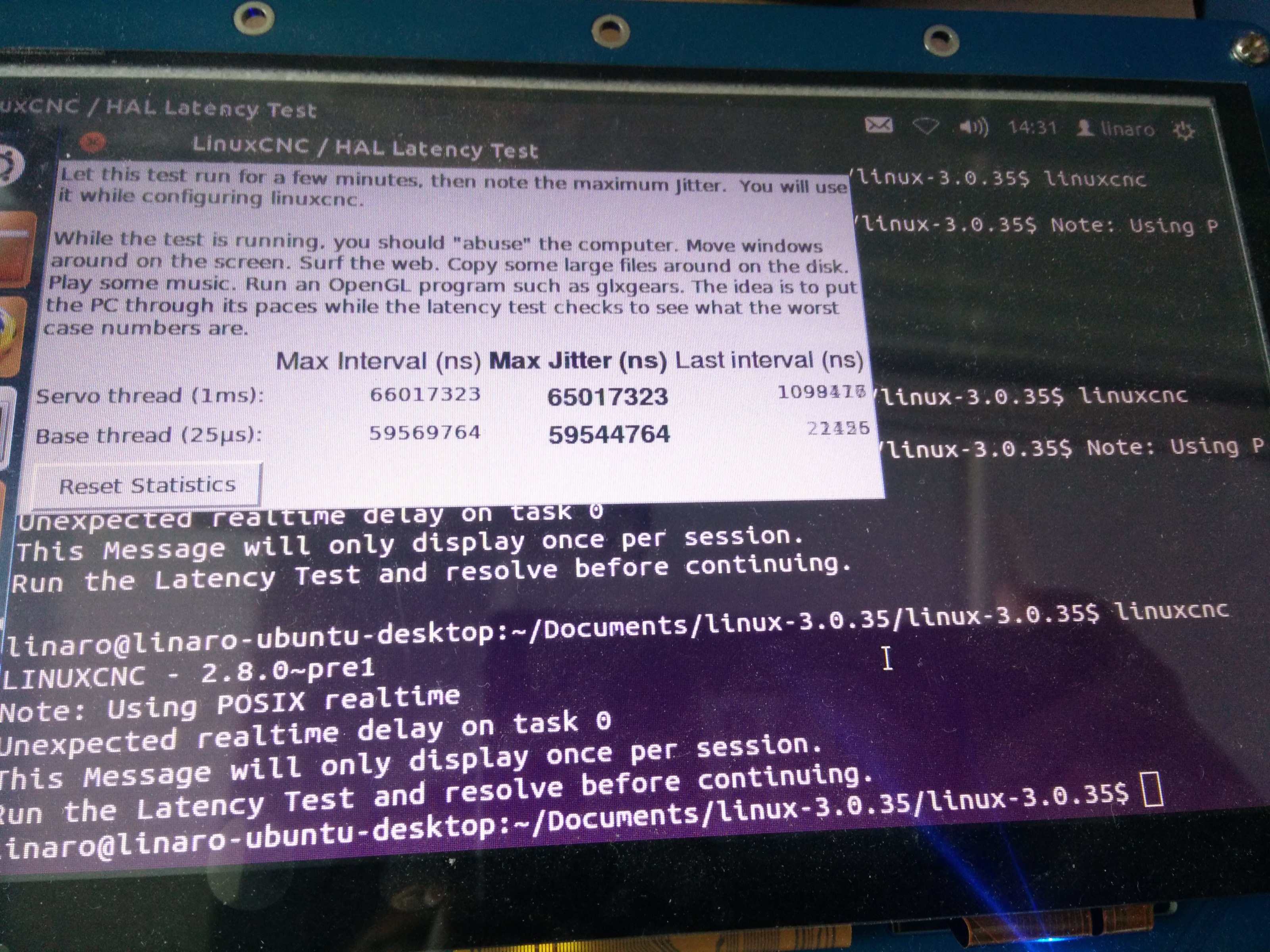

That's good news.
The question now is, does it still say "Using POSIX non-realtime" or is it now "POSIX realtime"
Replied by andypugh on topic LinuxCNC/Machinekit on i.MX6 board
finally,sim -> axis running successfully in my i.MX6 board.
That's good news.

it's "POSIX realtime"

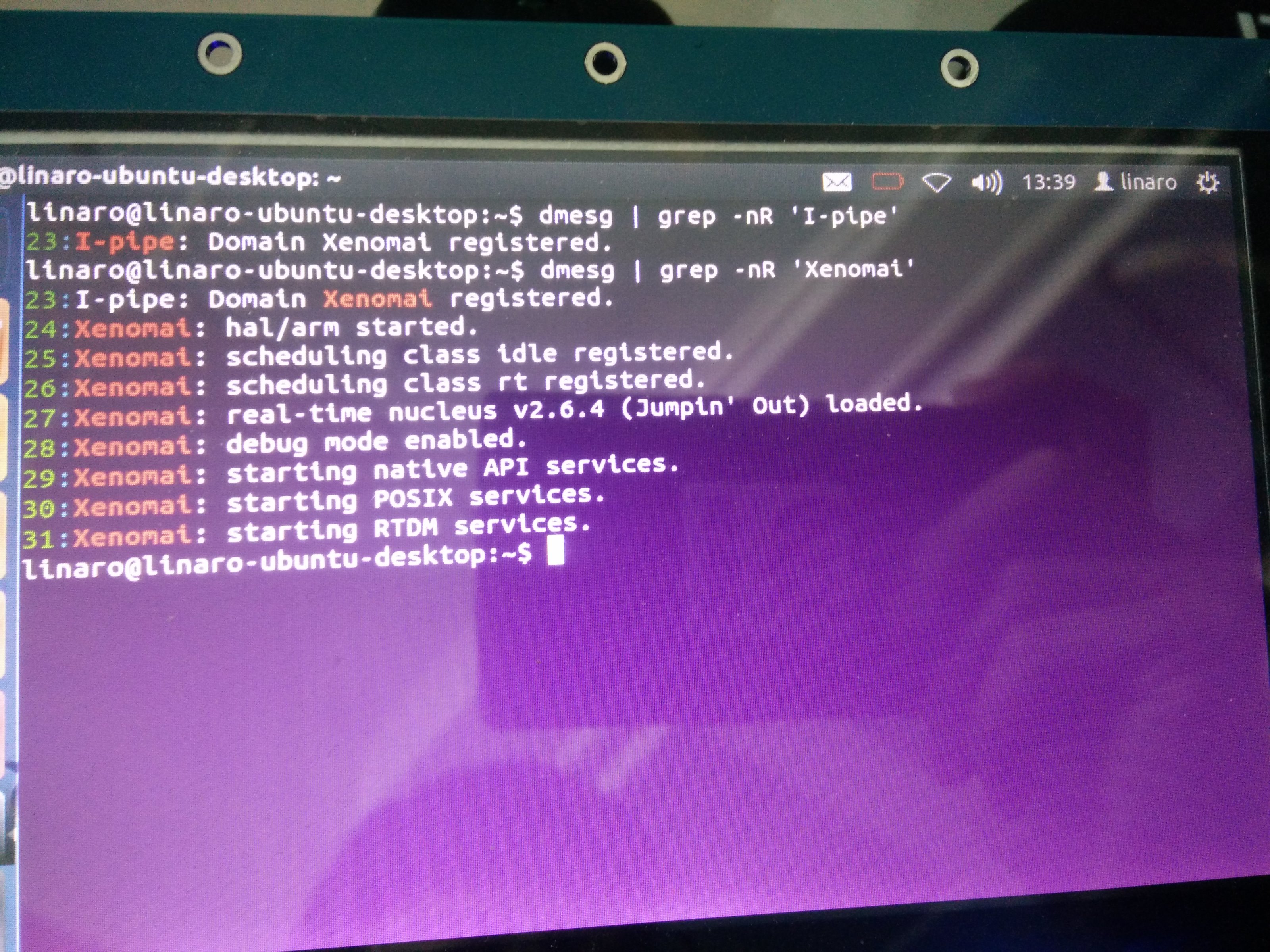

Interesting. After a bit of a look at the code I would have expected "XENOMAI (posix skin)"
github.com/LinuxCNC/linuxcnc/blob/af15a4...pace_xenomai.cc#L171
