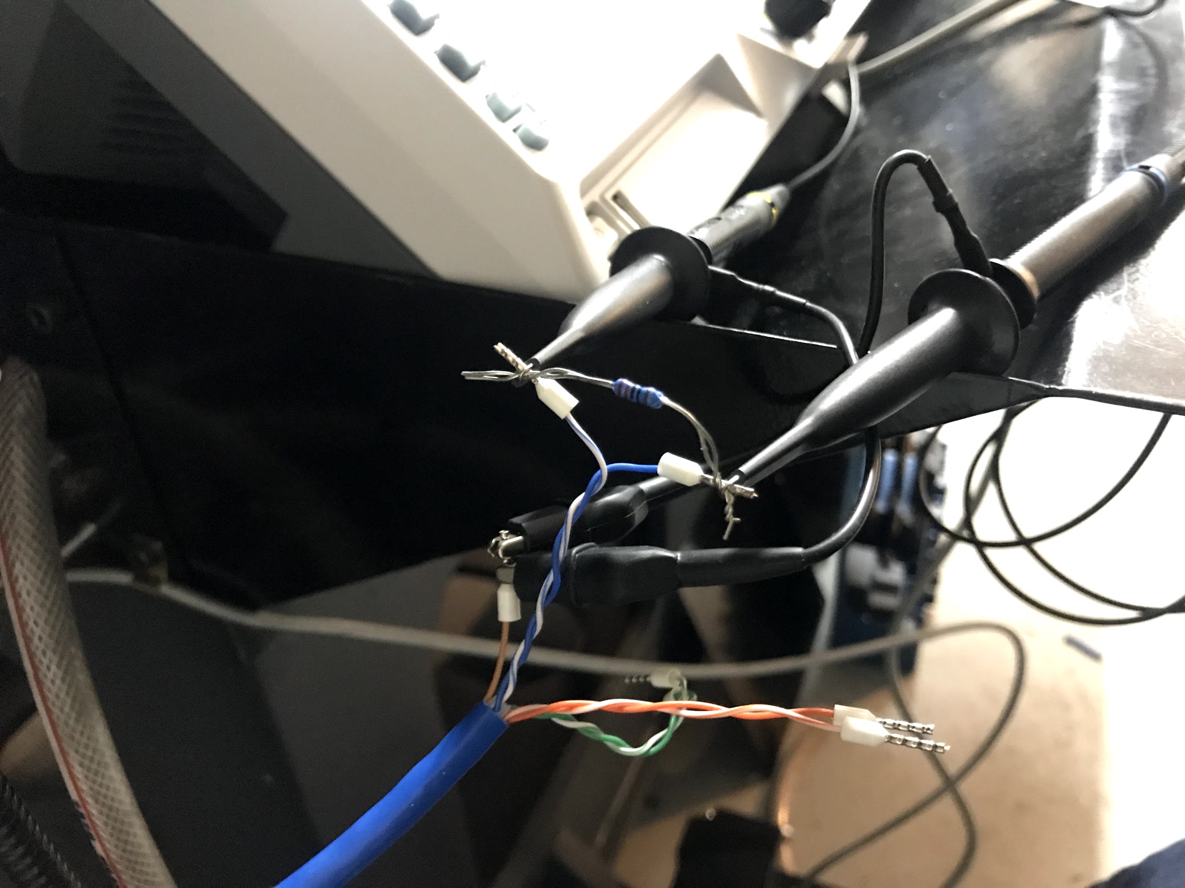

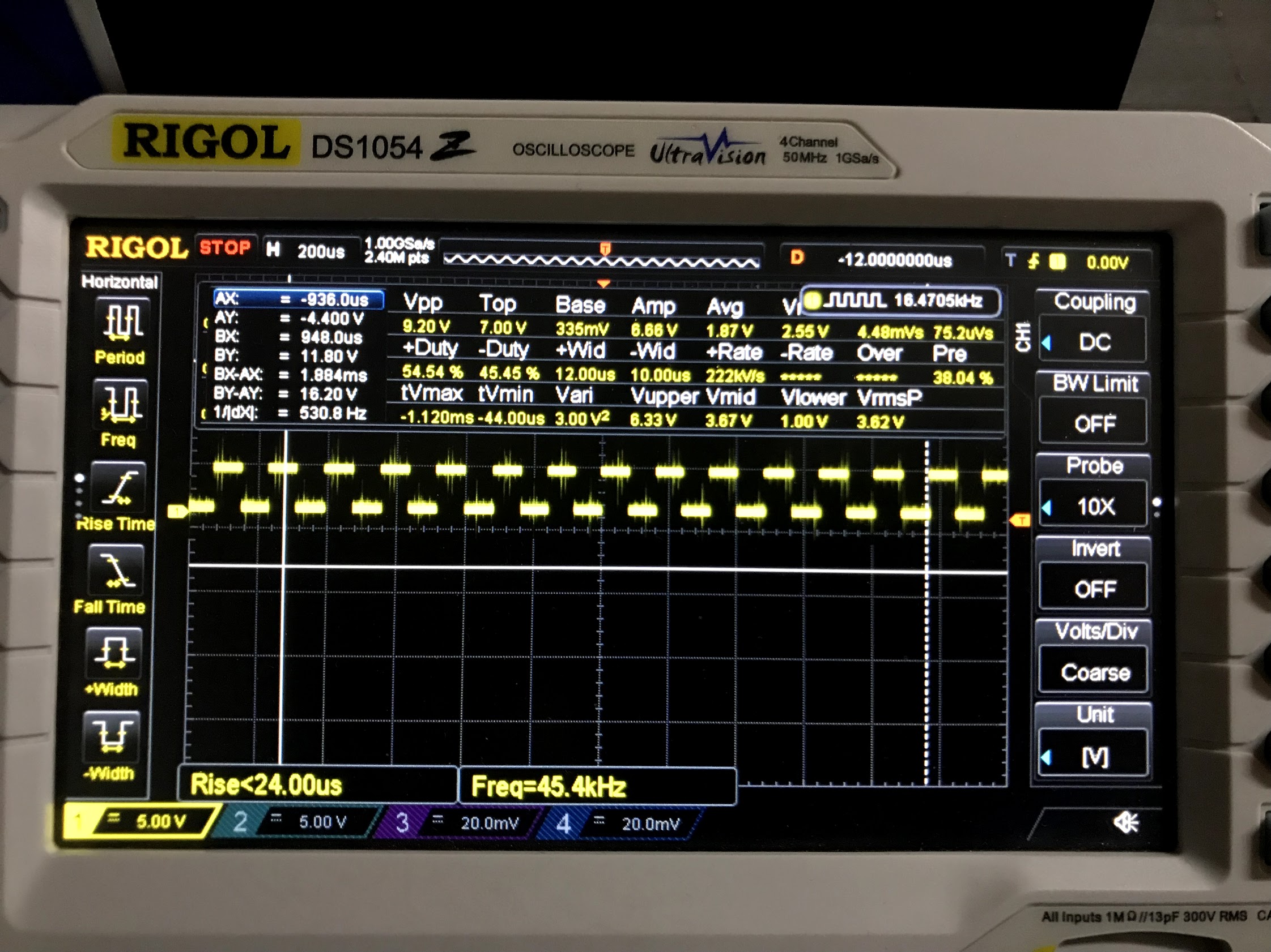

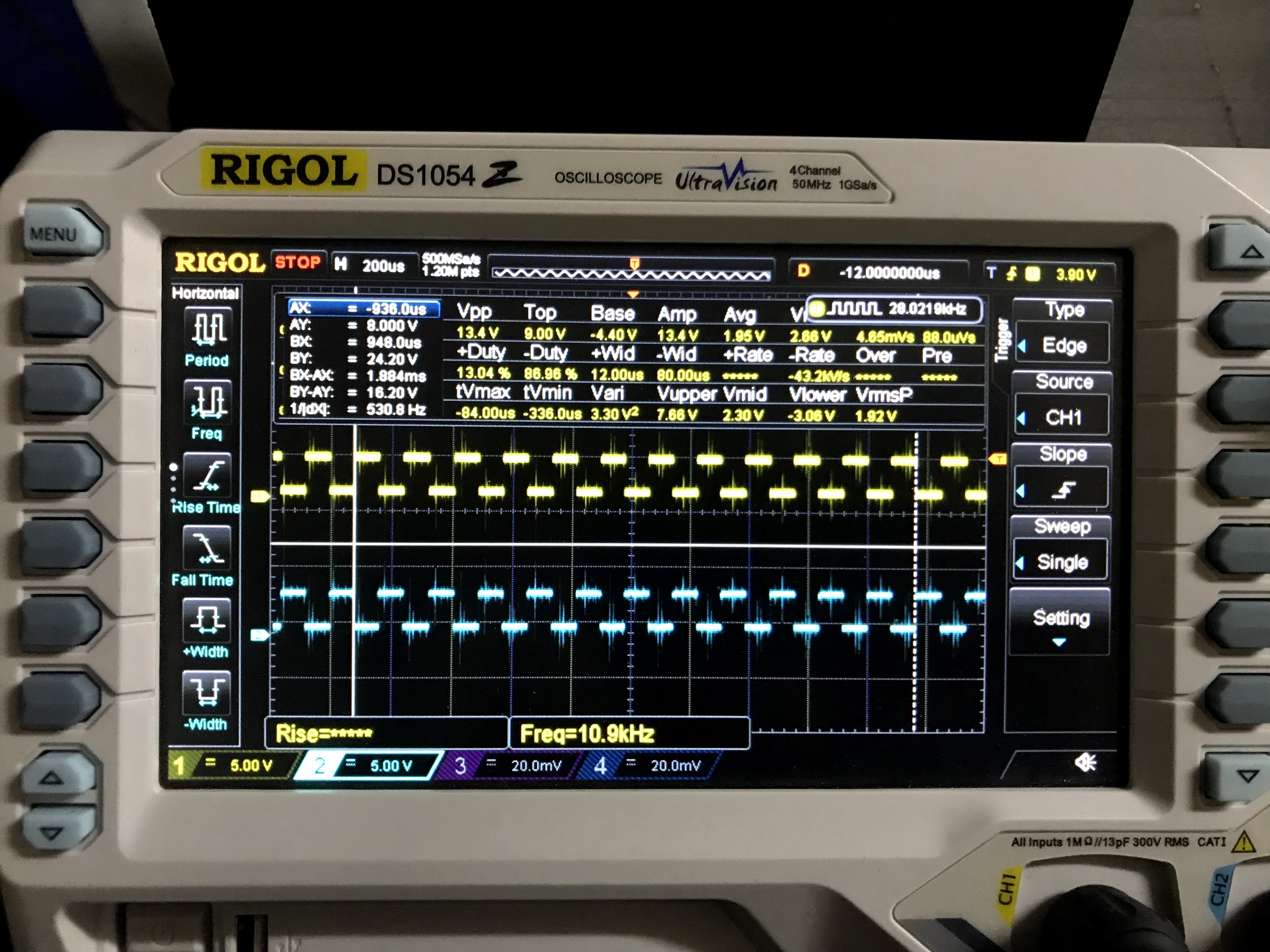

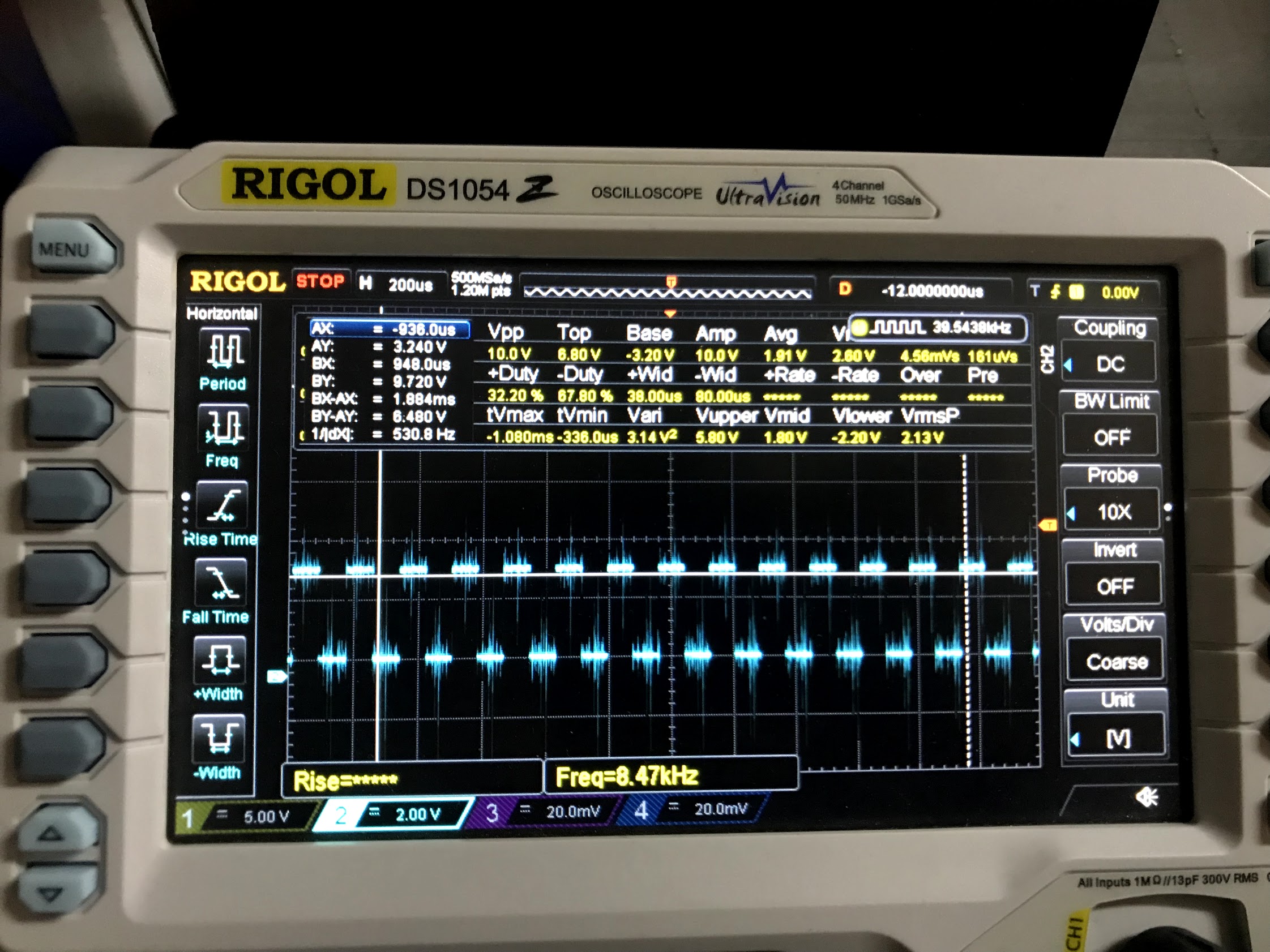

10 Jan 2019 21:52 - 10 Jan 2019 21:54 #123924
by vmihalca
Replied by vmihalca on topic Pairing up Mesa 7i76e with VFD Delta C2000
I have made today some measurements and some tests. I have discovered that the encoder board has a SG pin that I assumed it comes from 'signal ground'.
I have connected the ground of the probes to the ground, and then connected the probes to the A and A' with a 110ohm resistor between them to simulate the internal resistor that mesa has.
See the measurements in the pics below.
I am wondering if the noise that appears in the signal can get out of the -7/+12v range and if this could affect the mesa board.
Given how the signal looks now, do you think its safe to connect the wires to the Mesa's encoder input?
Also, do I need to connect the ground from the encoder to the GND encoder pin on the Mesa?
Last edit: 10 Jan 2019 21:54 by vmihalca.

10 Jan 2019 22:30 #123926
Replied by tommylight on topic Pairing up Mesa 7i76e with VFD Delta C2000
I would not connect that. You are using non shielded cable for signalling, shielding is a must in such machines, to many devices making to much electrical noise.
BTW, cable shielding should be connected only on one side, not both. Usually on the electronics side.

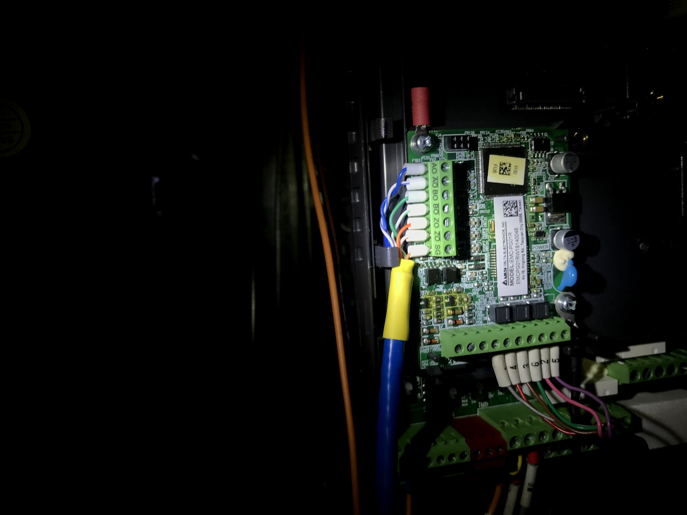

- vmihalca
- Posts: 346
- Thank you received: 22
10 Jan 2019 23:08 #123931
by vmihalca
Do you think a double shielded FTP cable would do it?
You said about connecting only one side; here the sides I have are the Mesa board and this board that converts from the resolver signal.
To which of them should I connect the shielding? Where should I connect the shielding? To ground?
Sorry if I'm asking stupid questions, I'm a very beginner with the electronics.
