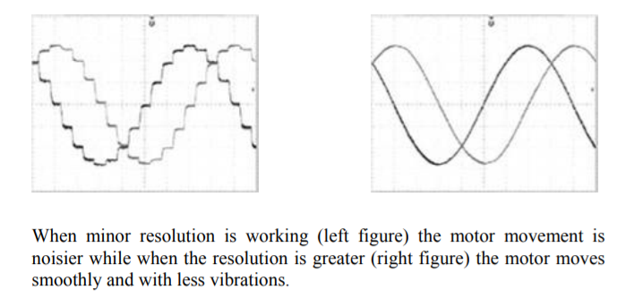

In general, I would use something like 5000,5000,20000,20000 for default timing
numbers. Unless you get a warning from LinuxCNC that the step timing is limiting
your maximum velocity, these numbers will have no effect on your maximum speeds.
You may be able to reach higher speeds by
1. Lowering your acceleration (currently you have 30 IPS/S accel
this means you get to full speed (1 IPS) in 33 ms, that may be asking too
much of your step motors/mechanics)
2. Raising the u step ratio on your drives. This has the effect of reducing vibration
and resonances which tend to cause stalling

Great, thanks for the suggestion!...I have been experimenting the last few hours and got it moving and sounding to please me for now...I did some manual test cuts to get a feel for speed and I feel ok about the max speed now...i tried numerous driver timing settings and landed on 5500 5500 500 500...it was just random settings From a driver on the Linux cnc list...I also settled on x32 microstepping (the highest setting) because it just seemed the smoothest. 20 for acceleration. I worked through several kinks with the home and limit switches, which are working correctly now. Next I guess I need to measure for accuracy and backlash.
