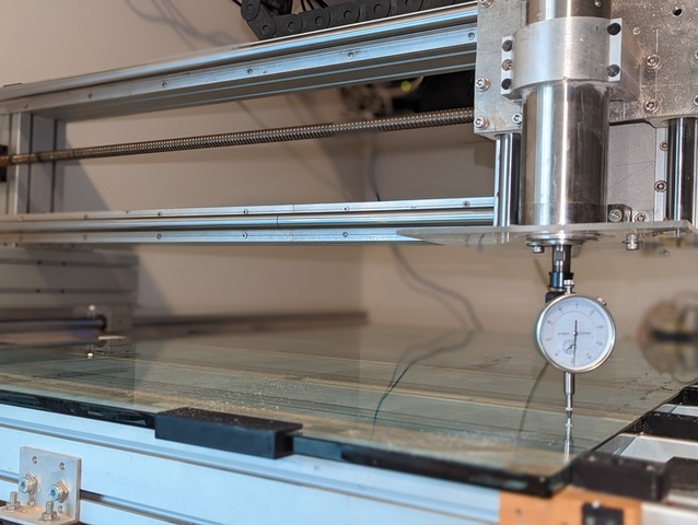

I got it going and it was easy.
Just changed the name of signal line like this-
net xpos2-cmd <= axis.x.pos-cmd => compensation.x-pos
I can see the Z motor moving so its now fine. Now time to scan the table again and get it around the 0 Z level.
Will post again when I cut .1 mm above the glass.
srl
srl

I've now been using it and its great. The dial shows that my table level variance has been reduced from .3mm down to .05. The milled parts come out much better. My next job is to move off VDFMOD to MB2HAL.
srl

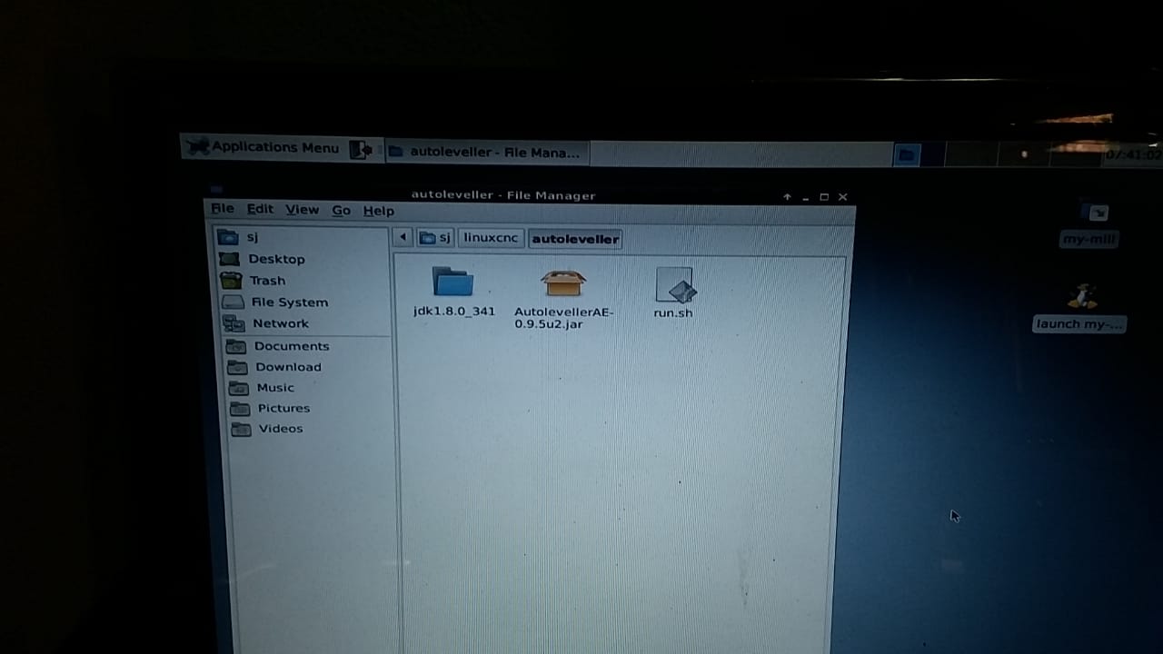

Dear friends,
I tried to use the autoleveller and got the error report as attached.
I followed ds.lithographie steps and did followings:
1. copied compensation folder unzip under the same folder ini file is.
2. Offset added under Z axis and Halfile added in ini file.
3. postgui halfile modified (attached).
4. custompanel.xml changed (attached). I am doubtful If I made any thing wrong.
5. downloaded autoleveller jar and placed as per attached photo.
6. downloaded jdk 8 u341 from oracle www.oracle.com/java/technologies/downloads/#license-lightbox.
My system is 32 bit. Not sure there is any mistake.
tar used and extracted folder pasted in autoleveller folder as per attached photo.
7. created run.sh (attached as test file) and moved to bin folder. Not sure if I typed the address right in the run.sh file, big doubt.
8. error report attached. it says "No module named scipy.interpolate". If any such module needed, please mention the source and how/where to paste/install it.
Thanks in advance for any help.
