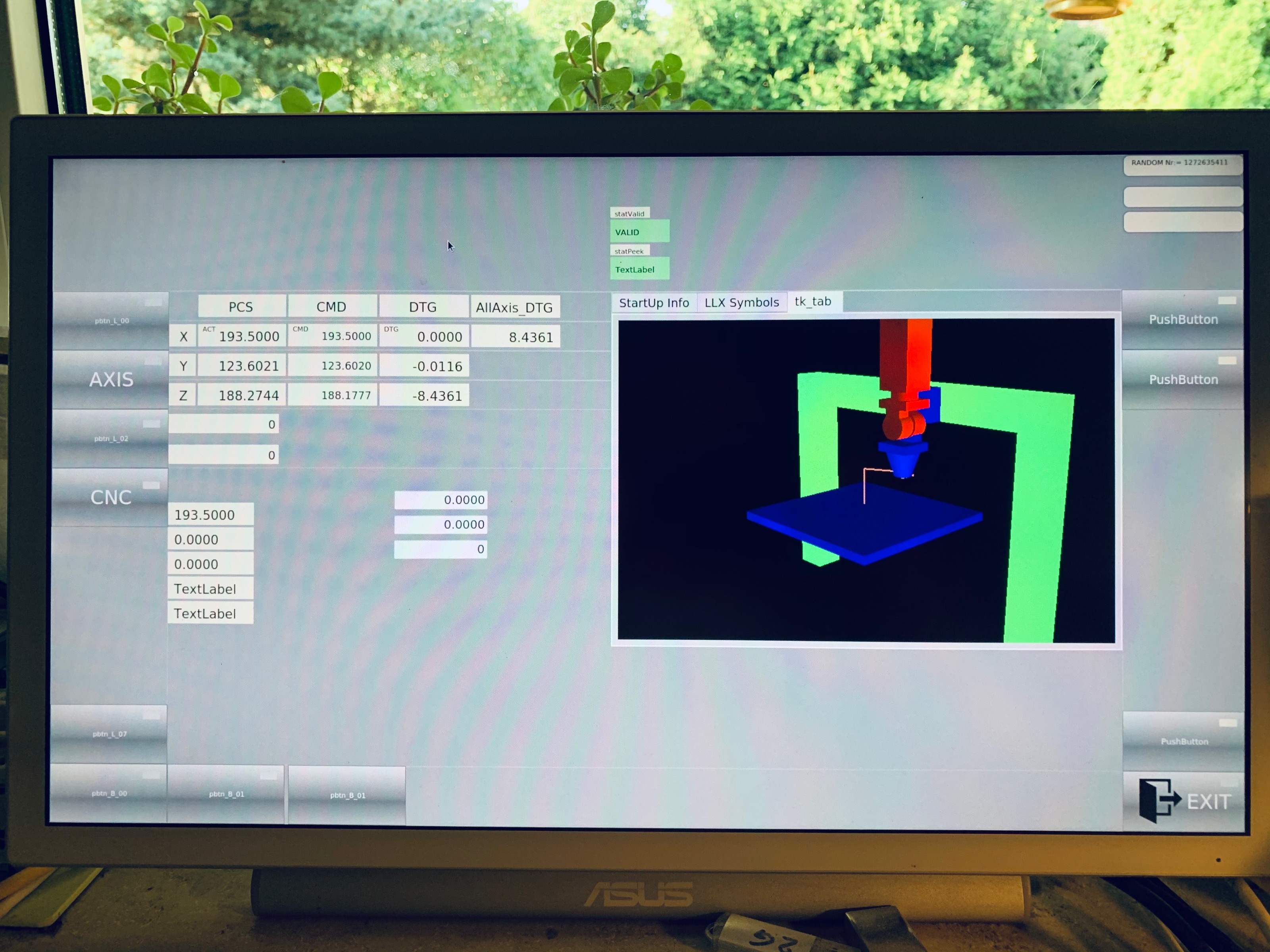

Replied by udoS on topic Building new Full Qt c/c++ HMI (incl. nml and EtherCAT )
Wow now I'v pulled Vismach into the Qt. Makes a nice Path View. No HUD yet.

02 Sep 2021 13:23 #219453
by udoS
Just to see it live.

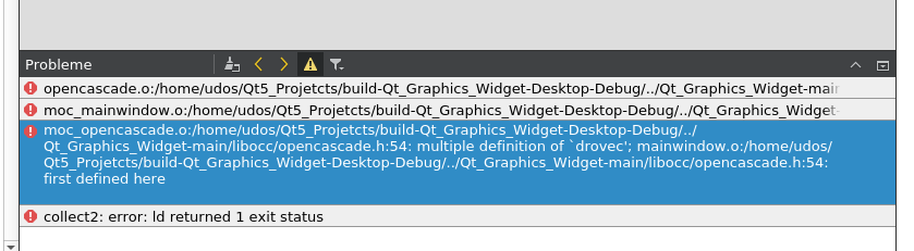

@Grotius
Hi Grotius, did you see those errors while building the Graphics_Widget ?

03 Sep 2021 14:06 #219549
by Grotius
Replied by Grotius on topic Building new Full Qt c/c++ HMI (incl. nml and EtherCAT )
Yes i have seen that. For now you can comment out the drovec and it's function where it's to related until qt compiles.
The drovec is still under construction.
Great job showing the video !! You are quite far in progress. How did you integrate the vismach 3d preview?
If you have video's up to 12mb you can upload them to github. Better avoid using Youtube.

04 Sep 2021 01:02 - 04 Sep 2021 01:16 #219579
by udoS
@Grotius
I attach the code for getting the vismach or
gremlin or halui or any other process into a Qt tab or frame or .. something you like. Just try for more.
Best rgds.
About the Qt_Graphics_Widget:
I was thinking of something more simple like your openGL;
For starters just a window with a coord-system displayed (based on the parameters) that can show the code-path and the actual path. Provide for the ability to load objects like in vismach. The tooltip cone is already there, just needs another shape.
KIS, KIS, KIS !!!
Best rgds.
KIS, KIS, KIS !!!
