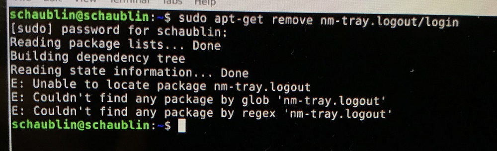

I also have the multiple instances of nm-tray, so I tried your remove, but get:

logout login means you log out and in after removing nm-tray so they should not be on the command line, at least i do not think they belong there.

its just sudo apt-get remove nm-tray
