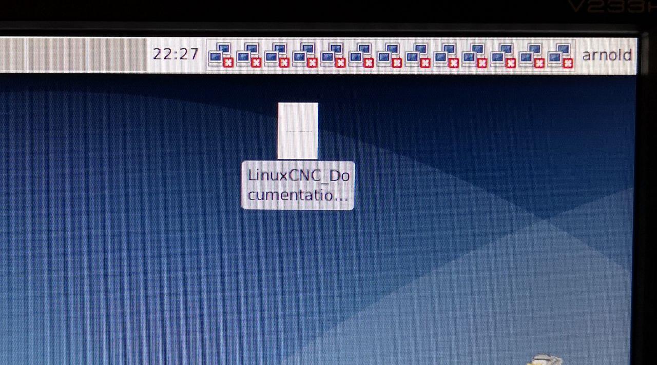

30 Dec 2021 00:05 - 30 Dec 2021 00:06 #230304
by AgentWD40
Replied by AgentWD40 on topic Debian 10 Buster Linuxcnc iso little issues
Thank you for the tip on the nm-tray icon. I was actually thinking it was my fault. I actually had no icon at all to begin with and when I was trying to get a wifi dongle going I launched nm-tray from command line in order to login to wifi. Afterward is when the chaos begin.
I actually had issues connecting to my 7i96 and I assumed it had something to do with me setting off nm-tray. I thought it had something to do with network manager and conflicting ip address settings. Maybe I was wrong?
In regard to the repo, I was able to just modify the existing repo lines in the package manager.
Last edit: 30 Dec 2021 00:06 by AgentWD40.

30 Dec 2021 22:06 #230368
by AgentWD40
1. bashrc needs the dot between the forward slash and b
2. export disply should be a colon instead of a semicolon
There's two very minor typos here that might throw someone off:2. Screen Blanking: by default it blanks screen every 600 seconds xset says.
type xset q in a terminal and you should see DPMS is Enabled
to turn this off type in terminal: cd ~ then sudo pico ./bashrc
edit at the bottom of the file and put these lines in.
export DISPLAY=;0.0
xset s off
xset s noblank
xset -dpms
sudo pico ~/.bashrc2. export disply should be a colon instead of a semicolon
export DISPLAY=:0.0
The following user(s) said Thank You: tommylight, ContinenteCNC, Arnold
