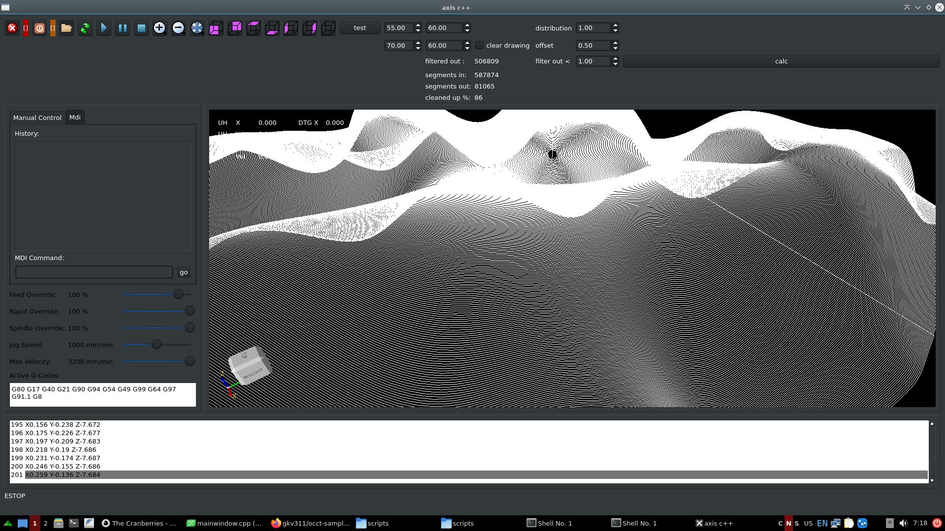

@All.
I got the file with half a milion gcode loaded. It's quite responsive.. haha.
Had to use a old trick in opencascade.
Filtered out 86% of stuff. Then made path G2 continue attaching tri-clothoids inbetween.

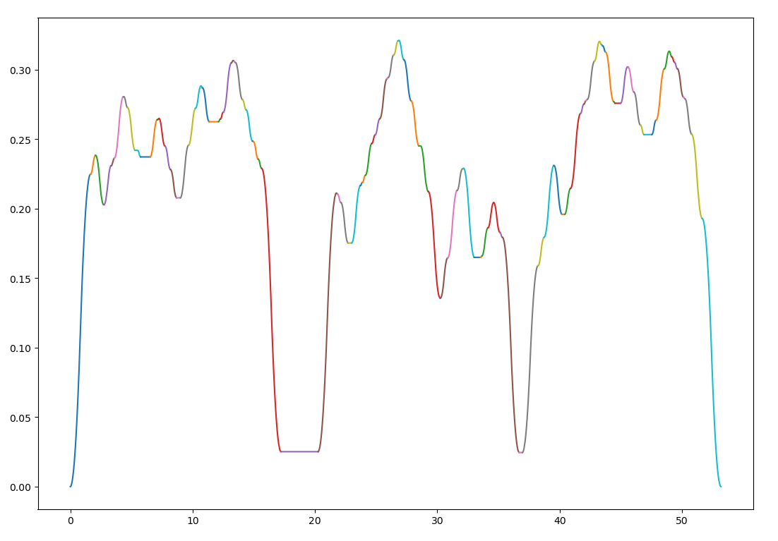

- andrew2085
- Posts: 28
- Thank you received: 42
06 Jun 2024 10:00 - 06 Jun 2024 10:01 #302477
by andrew2085
Hmm, it looks like this is coming to zero velocity and acceleration at the end of each segment instead of getting up to the highest velocity the segment can get to, and the next segment starting from that velocity.
Replied by andrew2085 on topic Trajectory Planner using Ruckig Lib
@Andrew,
Here is the scurve doing 100 segments:
Last edit: 06 Jun 2024 10:01 by andrew2085.

06 Jun 2024 11:05 - 06 Jun 2024 11:06 #302481
by andrew2085
I think I've fixed all the bugs that I know about so far. Here are 100 randomly generated segments. Some places look like sharp edges, but it's just scale. When zoomed in they are all smooth s-curves.
Ahh ok.
I modified the example to do 100 x 1 inch segments without stopping in between.
It works ok.
