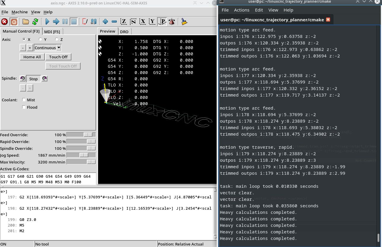

Hi all,
In this topic i want to discuss and keep updated development related to new linuxcnc trajectory planners.
For this there is a fresh repository : codeberg.org/skynet/linuxcnc_trajectory_planner
This repository include the latest source of the original linuxcnc repository hosted at github.
To start coding your own planner, you could use the template branch to get started.
This branch is a clean project.
In the source dir, there is a cmake directory producing 2 libraries (motmod.so & tpmod.so) , involving the trajectory planners code.
These 2 libs, can be compiled and installed to replace (overwrite) the original libs.
Short briefing
Why do we need 2 libraries involving the trajectory planners code:
The motion controller component "motmod.so" wich handles a few things like jogging,
but also call's the trajectory component to add fresh gcode lines trough functions like : tpAddline();
~/cmake/motion
The trajectory planner component "tpmod" wich run's the gcode recieved by the motmod.so component.
The tpmod.so calculates the trajectory and does things like "look ahead", create path's, updates tool position etc.
~/cmake/planner
Repository cmake compile & install rtlib test
Repository linuxcnc run test
Ok so far we are on the right track. Above run's at my pc.
My investegation start's at the motion controller component motmod.so, the related file command.c
~/cmake/motion/command.c
In command.c, the function emcmotCommandHandler is runned every cycle. And check's what needs to be done.
It is responsible for adding lines & arc's to the trajectory planners tpmod.so component.
The emcmotCommandHandler function calls adding lines and arc's several times in the source file at different locations :
- Line 1027 tpAddLine
- Line 1437 tpAddLine
- Line 1088 tpAddCircle
Now i think a good strategy is to change a few tiny things to the current linuxcnc motion command flow:
1. Dont send tpAddLine and or tpAddCircle every cycle. Buffer this info into shared memory.
2. When the emcmotCommandHandler recieves a "run: command to execute the program,
then *optimize the path given the buffer, also optimize the **look ahead for the path.
3. Send only optimized path's, including ***vo's & ve's to the trajectory component tpmod.so
4. The trajectory planners component tpmod.so is now very simple to code. As is no longer is required to do
complex calculations. It only has to have a scurve motion algo under the hood.
*optimize = G64 P.. Q.. remove tiny segments, add fillets, etc.
**look ahead = Run a forward & backward algo over the trajectory to optimize speeds based on curvature extrema, maxvel, maxacc, maxjerk.
***vo's & ve's = velocity begin, velocity end for a line or arc.

Ok i did some coding today.
There is now a new function added to the planner tpmod.so component.
I's called by the motion controller motmod.so.
When the entire gcode is loaded, the motion controller signals the trajectory planner
it can start processing the G64 P.. Q.. stuff for the trajectory.
Above function is now empty, but should start a new thread. This means heavy calculations
will not influence the current program cycle.

Now given the G64 P.. Q.. value's for a gcode line, this is hiding : emcmotInternal->coord_tp.execTag.fields_float[3 & 4];
This can differ along the file. As the file may have multiple of these commands using different values.
1. The motmod.so (motion controller) component loads the file into a vector.
2. It initializes the lines & arc's inside the vector, just as the tpmod.so does written by Rob Ellenberg. Same struct's are used.
3. It trim's the segments given the G64 P.. value for that gcode line. The trim logic is there to produce a nice trim if it can.
4. Interpolation for arc's is used from original lcnc functions. and tested ok.
5. Interpolation for line's i added a new function wich make more sence.
The picture is a print result after loading the entire gcode, simulating a 5 second delay,
and after trimming is done to connect the spline fillets later on.
Next step is to add the spline fillets. But not too fast now.
First create the G64 Q.. (naive cam) filter function. We want to filter out tiny segments first.
