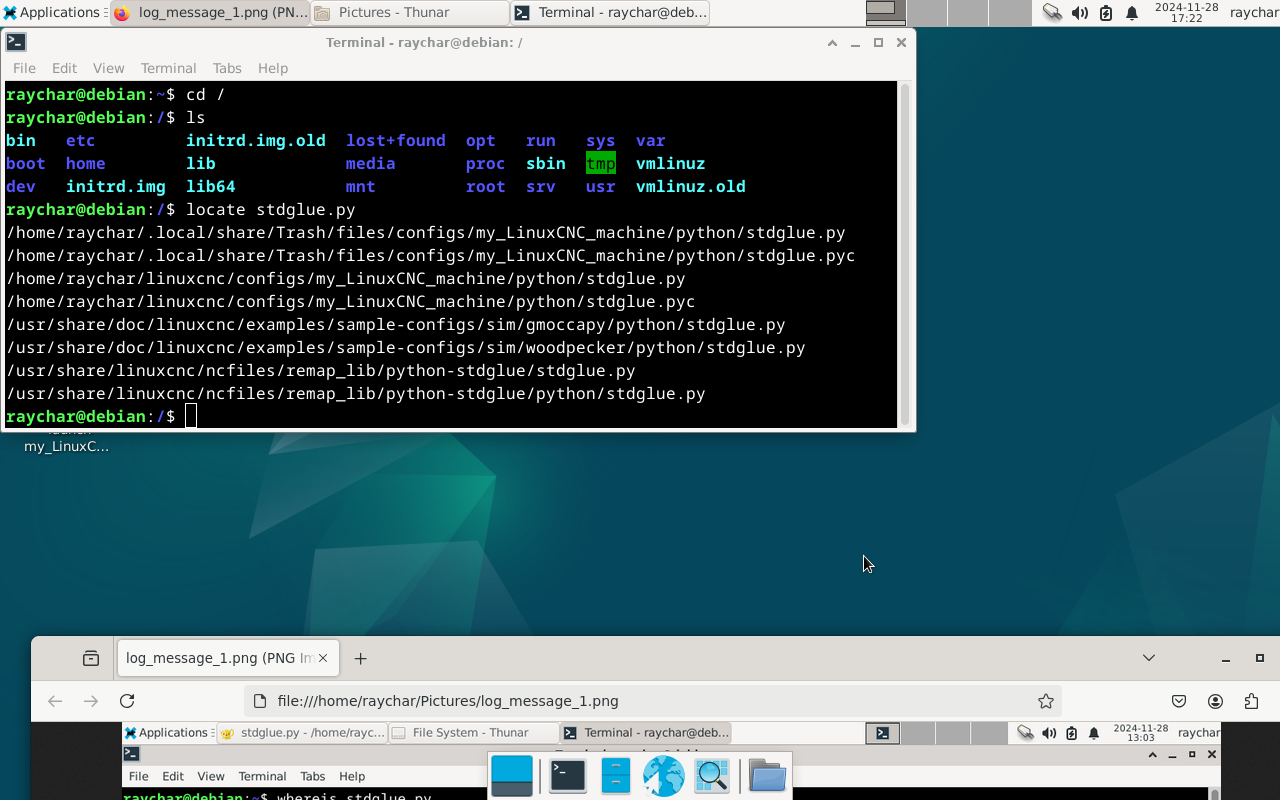

Indeed a python2 vs python3 issue. If you have not customized 'stdglue.py' you can try and replace stdglue.py in your config/python directory with the current file:
'configs/sim/gmoccapy/python/stdglue.py'
Replied by Aciera on topic Original Gmoccopy setting all gone
File "/home/raychar/linuxcnc/configs/my_LinuxCNC_machine/python/stdglue.py", line 59
print "change_prolog: Toolchanger soft fault %d" % int(self.params[5601])
SyntaxError: Missing parentheses in call to 'print'. Did you mean print(...)?Indeed a python2 vs python3 issue. If you have not customized 'stdglue.py' you can try and replace stdglue.py in your config/python directory with the current file:

After deleting stdglue.py in those folders, please see as attachment, and replacing with the one in sim/gmoccapy/python/ for them, when opening LinuxCNC, the Gmoccapy screen still not o.k. (there are stdglue.pyc files, I think they won't have effect, I haven't do anything on them)

Run from terminal again and post the output as there are likely other python2/gtk2 issues..

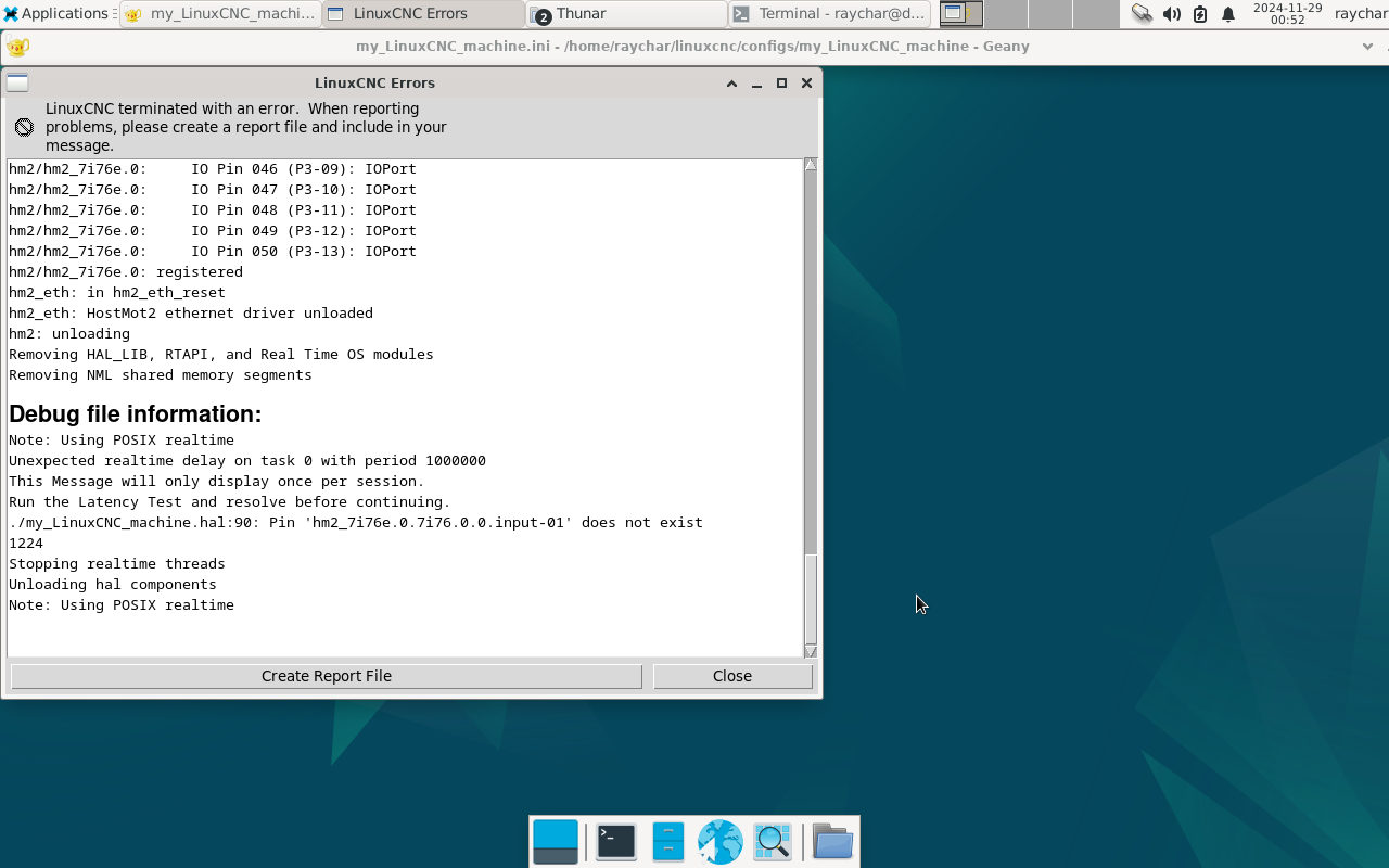

Also, by running linuxcnc -l in terminal, the message found as listed in attachment. However, if I replace the old mSATA drive which has with old version Linuxcnc on this same computer, everything works fine. Don't know why everything goes wrong now including the latency test

As for the config not starting, uncomment these lines in your ini and try again:
You will likely need to update 'gvcp-panel.ui', opening the file in glade and saving again might already do the trick.
EMBED_TAB_NAME = Center_panel
EMBED_TAB_COMMAND = gladevcp -c gladevcp -H gvcp_call_list.hal -x {XID} gvcp-panel.ui

After doing the lines' uncommenting, still not work, as shown in attached error message. Furthermore, i don't know how to opening the file in glade to do upgrading the 'gvcp-panel.ui' file? where is glade ? Also, i don't know why my hardware now runs with the latency problem, this showed in error message and also when I run latency test, previously this did'nt happen.

Attached the ui file, please help to update. Also, after running linuxcnc -l in terminal, the error message is as in attachmentRe: Latency issues with new os:
