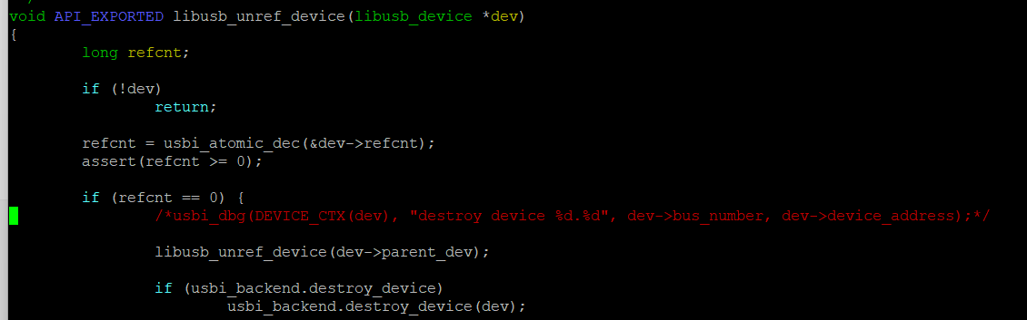

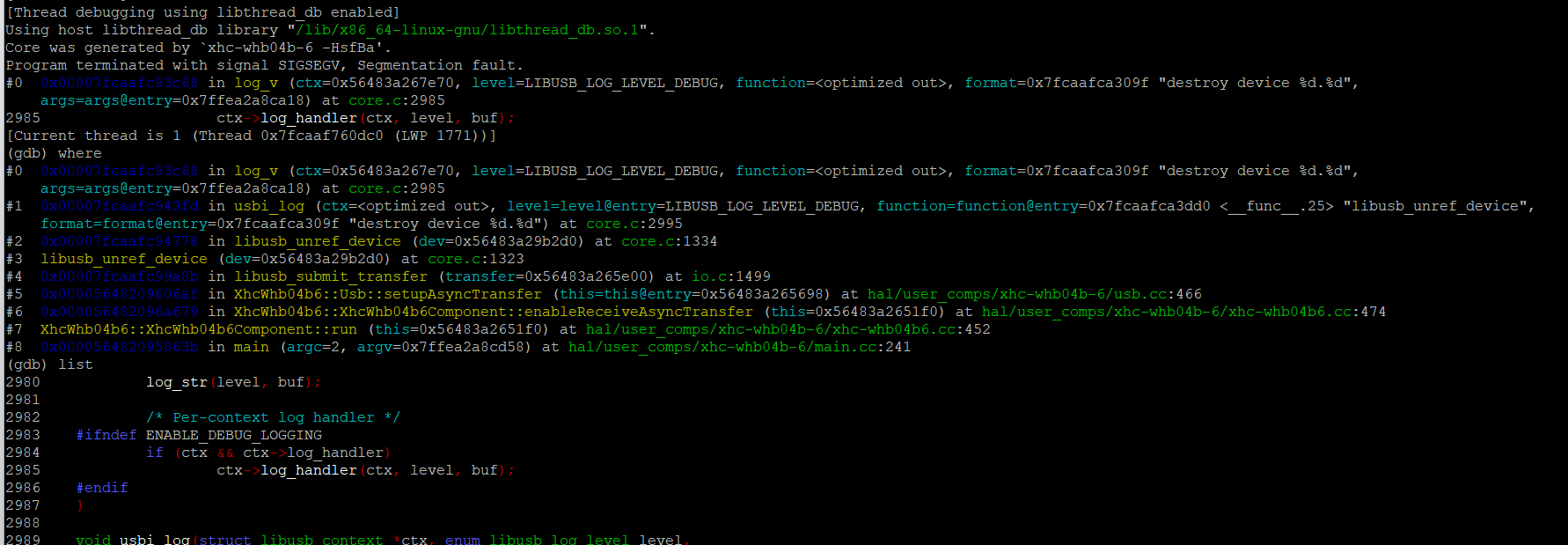

Ok, I didn't find the reason but I found a way around it.
It always crashed for me with "libusb: debug [libusb_unref_device] destroy device 3.109"
I ran it in the debugger and saw it stopped with a SIGSEGV.
After spending too much time figuring out how to turn on core dumps, I got a core dump.
Here is the stop point.
The one wonders what ctx_log_handler is
I commented out this line in libusb_unref_device()
and then the xhc actually restarted.
Here is the log of that.
(gdb) p ctx->log_handler
$2 = (libusb_log_cb) 0xbb343c565cbddc86I commented out this line in libusb_unref_device()

I provoked the xhc a bit. Easily crashes with wrong loop setting. But it now recovers after three seconds.
This is a situation I can live with. It would have been better with no crash. Until then, this is fine.
The modification I made was in libusb1.0.
What I see is that if one setthe problem will not appear, the callback function pointed to by context->log_handler will not be called.
Do you know if this can be done in the xhc component code?
It would be good to use std libusb1.0 libs.

I tried that already, there is no access to log_handler.
struct libusb_context is not defined, only the pointer to it.
I tried with
in process(), but no change.
There was a new message when restarting the connection from
and that didn't crash even if it uses the same underlying log_v function.
I leave it like that.

Yeah, it appears libusb_context is defined in libusbi.h, which is not part of the normal "distribution package". I missed that. There are several compilation defines/options for libusb, which makes a bit more difficult to understand exactly what is happening. But I do think that your libusb_set_log_cb() should have done the trick (unless for some of those compile time options).
It was a little bit strange from the start that it succeeded to print that debug message and only afterwards seemed to hang (which we now know was a segault). I wonder if there could be something wrong with the handling of variadic (=any number of) arguments, which messes up the stack and in the end gives the segfault.
I had a second look at the issue you created a couple of years ago. And yeah, already there you identified libusb as a problem. I don't think really put much thought into that the first time I read it.
Hannes have made a pull request which is waiting to be accepted into LinuxCNC. Andypugh bought a similar pendant and will test the code once he receives the pendant. I guess if he is happy the PR will be accepted. Maybe in 1-2 weeks, is my guess.
I don't think it's possible to switch to manual mode while a program is running or paused. Which is what Hannes version checks for. I presume that if the program is running/paused, it needs to be stopped prior to making the mode change. But I have not verified that. If you are not having a program running/paused, then jogging should change to manual mode.

Normally, you anyway don't want the program or MDI command to stop because you accidentally jog, so I figured this is a good choice, even if it would switch to manual. Which it doesn't do anyway, at least in my case.
I did not read the whole thread in detail. But it seams you have issues with libusb_submit_transfer() and the assert afterwards? According to the manual, this function is allowed to return disconnected: manpages.debian.org/unstable/libusb2-dev/libusb.3.en.html
This should be fine, we should handle the error, cleanup properly and try to reconnect. Worst case, you have to do is disconnect the dongle and reconnect it again. I can look into that.
Meanwhile, do you have a way to reliably get the device to disconnect? Otherwise, it is always hard to see if a fix is really a fix or just the device behaving nicely for a few hours and then failing again.
@Hakan: I see you have Debian 12 (So libusb 2:1.0.26-1 I guess, libusb-1.0 is the package name, not the exact version). Did you try Debian 13?
@Finngineering:
Which Debian version do you have? Kernel version? Libusb version?
I have Debian 13 stock, libusb 2:1.0.28-1
@Finngineering:

The assert statement is setupAsyncTransfer() is the "big" issue. Simply removing that causes the reconnect to be triggered when trying to send a display update. For me that reconnection works without problems. For Hakan, it gets stuck/segfaults in libusb after reconnect. Somewhere along these lines:
forum.linuxcnc.org/38-general-linuxcnc-q...ment?start=80#343687
It would of course be good to get to the bottom of this. But since I can't reproduce this, it's a bit difficult to debug.
Both myself (with the original firmware) and Hakan can trigger the disconnect reliably by using the original component and jogging while a program is running.
On the development computer, I use the LinuxCNC 2.9.8 iso image / Debian 13. That one has libusb 1.0.28-1. I'm not at that computer right now, so cannot check the kernel version. But it's the stock one from LinuxCNC 2.9.8 iso (unless "apt upgrade" has updated it).
