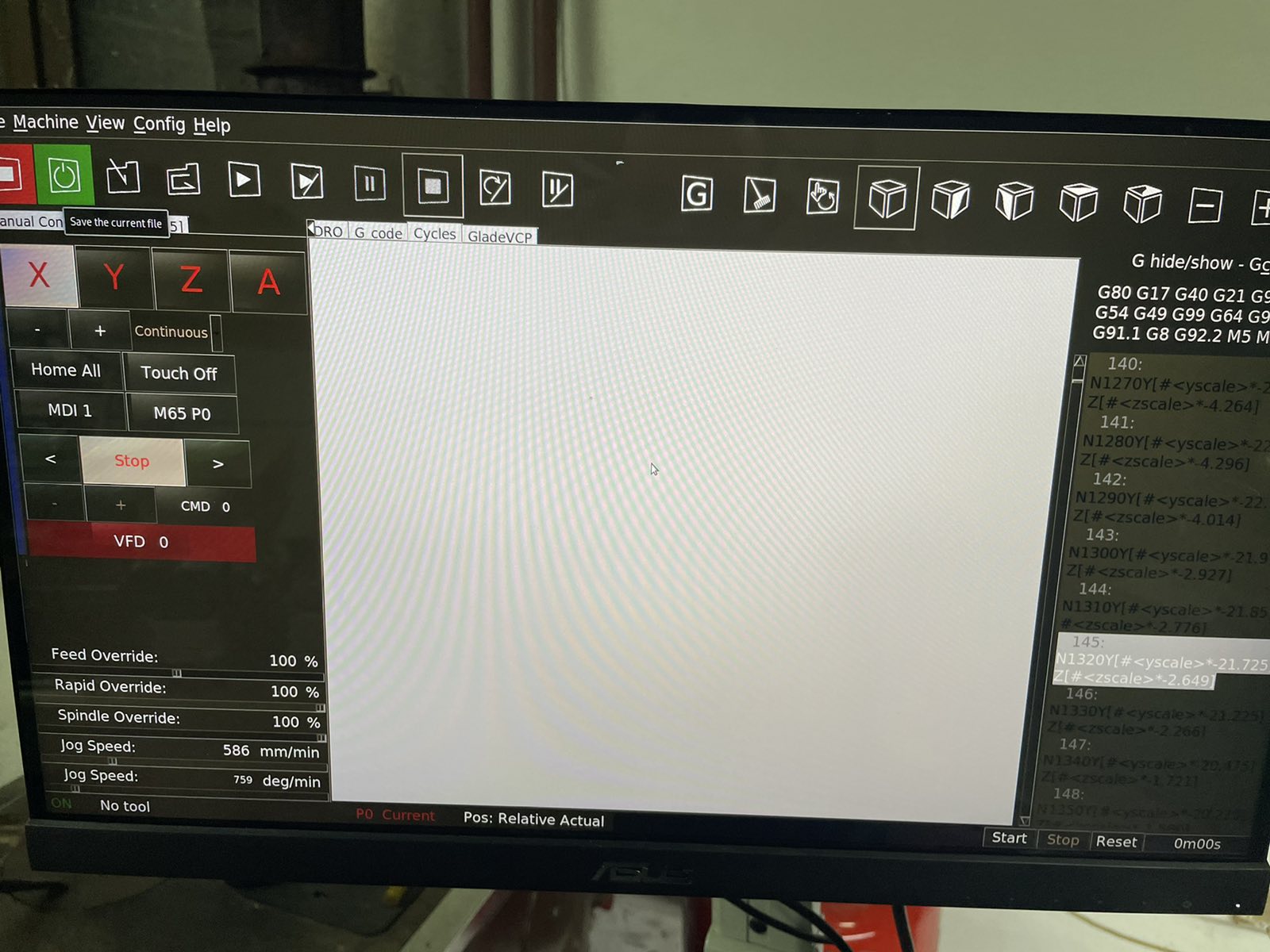

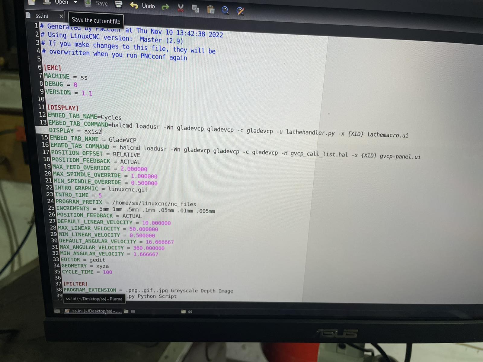

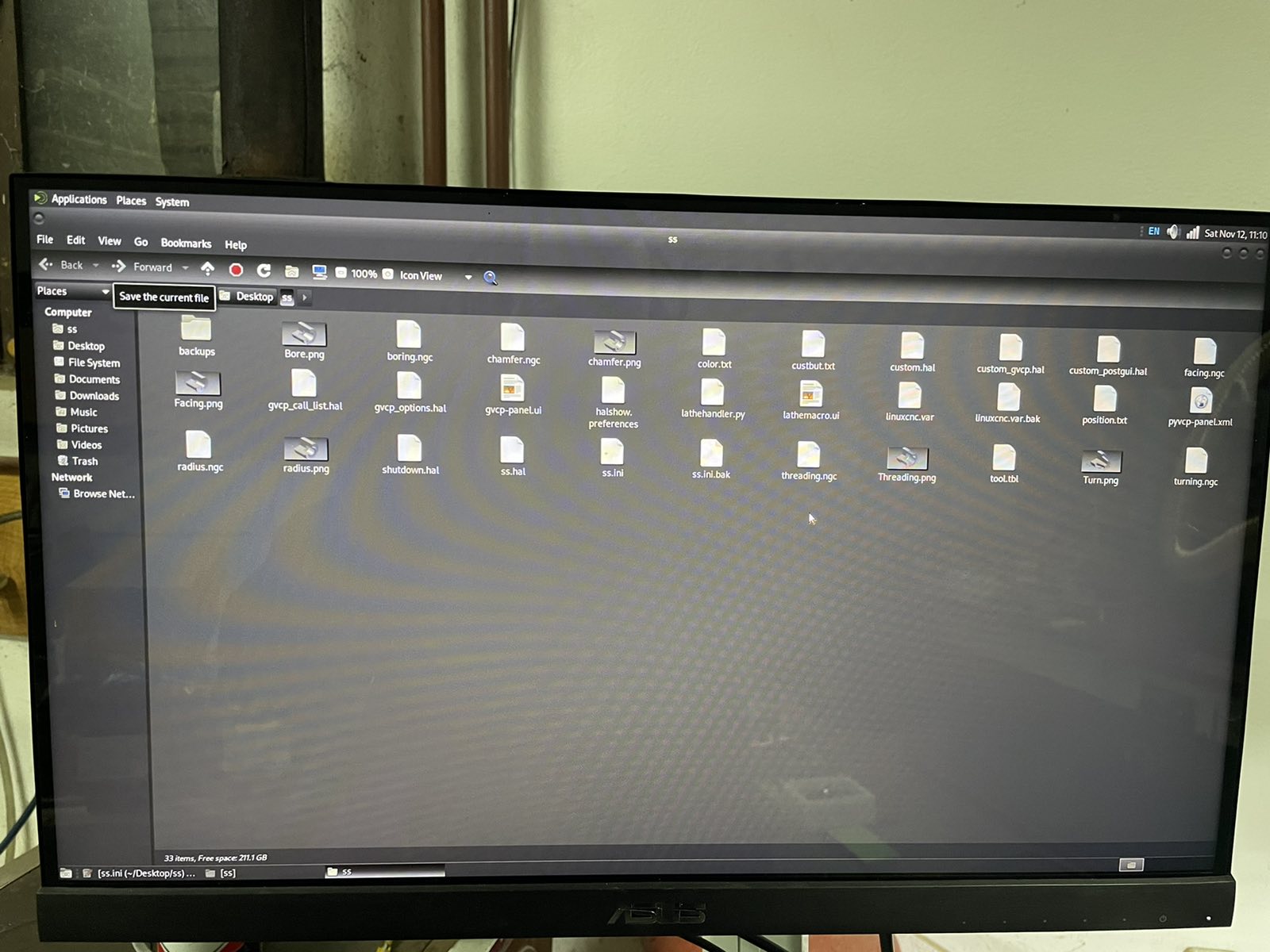

12 Nov 2022 21:25 #256540
by Masiwood123
Replied by Masiwood123 on topic Lathe Macros
- Posts: 19899
12 Nov 2022 21:42 #256542
Replied by andypugh on topic Lathe Macros
Start linuxcnc from the command-line (the command is just "linuxcnc" and see if there is any useful information about what is going wrong.
