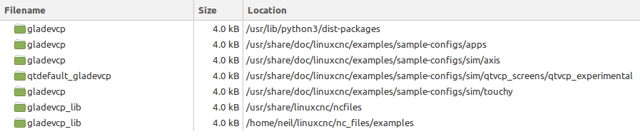

17 Oct 2022 05:55 - 17 Oct 2022 05:56 #254311
by Thompo
Replied by Thompo on topic Lathe Macros
Thankyou for the assistance, really appreciate it!
Im running 2.9.0 on Mint 21 with RT Kernel as below.
I ran a search on my system for GladeVCP as a folder and got this.
Looks like its there but maybe not in the right place for this to work?
Thanks[/code]
[code]Download the RT kernel from:http://ftp.de.debian.org/debian/pool/main/l/linux-signed-amd64/linux-image-5.19.0-2-rt-amd64_5.19.11-1_amd64.deb
Download the LinuxCNC deb from:http://http.us.debian.org/debian/pool/main/l/linuxcnc/linuxcnc-uspace_2.9.0~pre0+git20220906.02744cdef6-1_amd64.debI ran a search on my system for GladeVCP as a folder and got this.
Thanks[/code]

- Posts: 19899
17 Oct 2022 08:53 #254315
Replied by andypugh on topic Lathe Macros
Maybe try installing the linuxcnc-dev package. That might help.

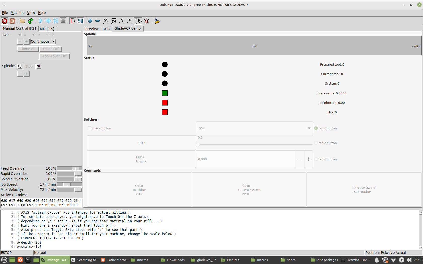

Do any of the gladevcp demo configs run for you? (for example sim/axis/gladevcp)

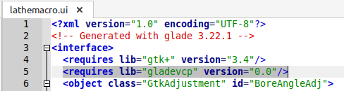

Looking at the .ui file, im guessing line 5 is my problem?

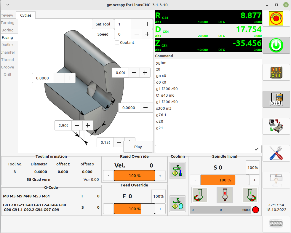

i just seen your bit about trying the sim/Axis options and they seem to work ok, but the gmocappy lathe_macro simulation, displays the tab in the main window but stays on the main screen when clicked.

You could try deleting that line from the .ui file. (It is commented out in the sample files)

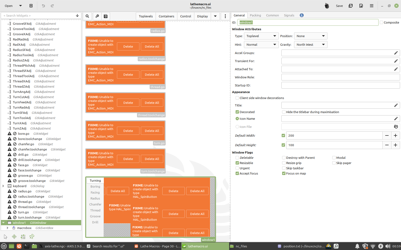

Deleting the line <requires lib="gladeui" version="0.0"/>
Glade opens without error but im not sure it looks correct once inside? Im expecting to see a series of graphics that contain the textbox inputs that feed the macros? but im not sure if linuxcnc generates these when it runs?
Im sure this is something simple and most likely user error

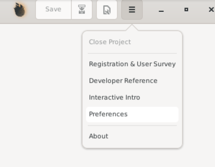

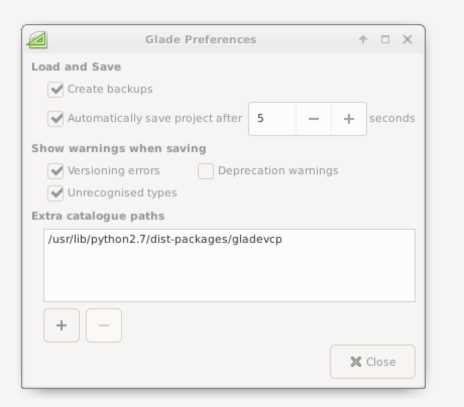

18 Oct 2022 00:27 #254375
- Posts: 19899
18 Oct 2022 00:28 #254376
(But if you can find one under Python3, definitely use that one)
The following user(s) said Thank You: Thompo
