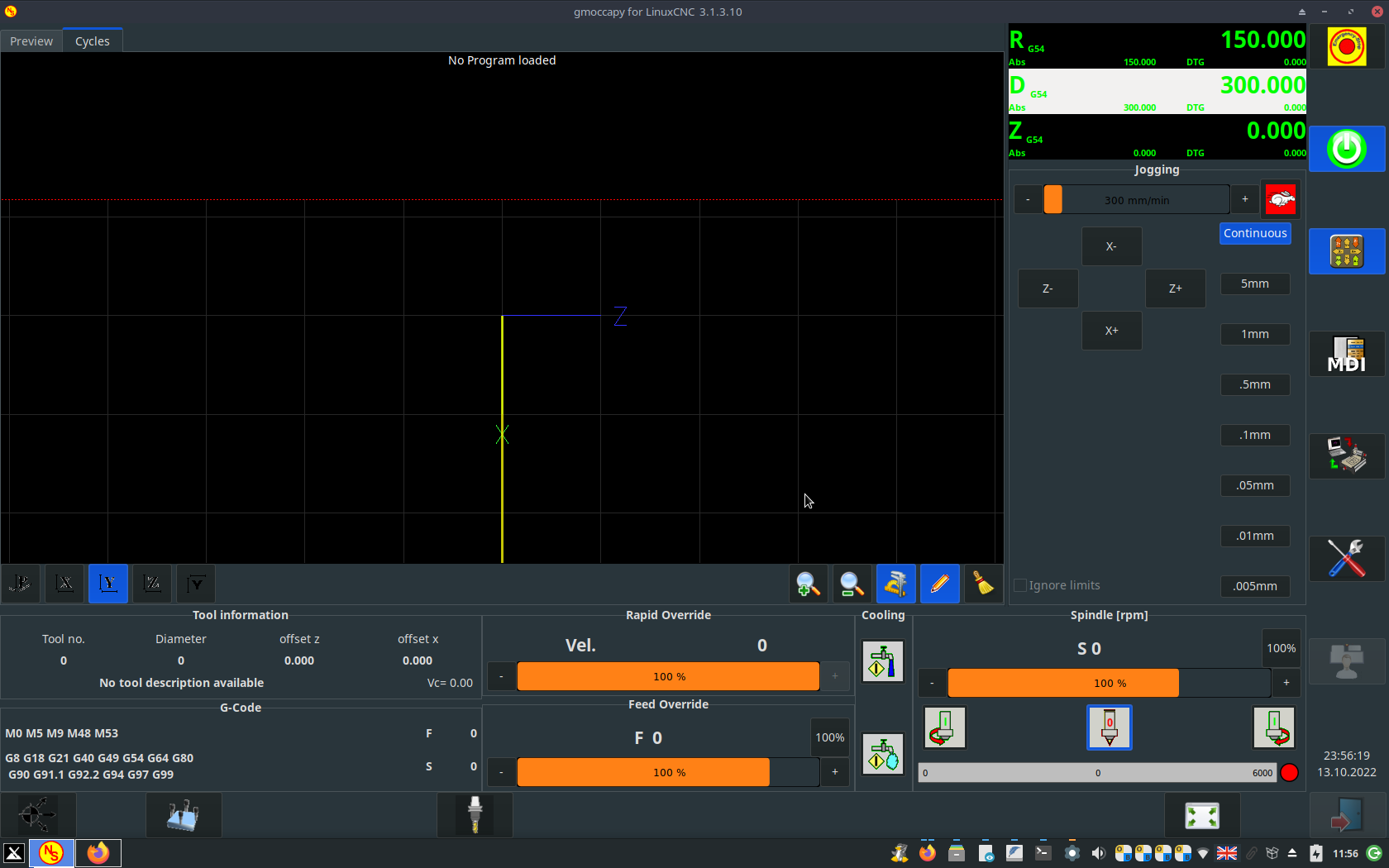

13 Oct 2022 23:07 - 13 Oct 2022 23:23 #254093
by Thompo
Replied by Thompo on topic Lathe Macros
Hi there, im very much a noob when it comes to anything other than g-Code.
I have just installed LinuxCNC 2.9 on MX21.2.1 (using this guide www.qtpyvcp.com/install/bullseye.html) to run an old Orac lathe. It was running on 2.7.14 but wanted the G71 cycles, and figured as i was doing it from scratch id try to get some macros working.
I ran stepconf on the old file and have gmoccapy 3.1.3.10 running (used Axis with no macros on 2.7.14)I went here configs/sim/gmoccapy/lathe_configs / and downloaded all the new macros, svg, .ui. py etc into my . Modified the ini as follows (Embed, RS274NGC, Macros)
I get the tab appearing in the window but when i click on it, nothing happens.
If i go MDI i see the macro buttons and clicking these generate errors such as g1 without feed rate etc, so it looks like its trying to run them from here but i have no interface to input parameters.
Any ideas? These macro look like a real good job fora lot of what i use the lathe for,
