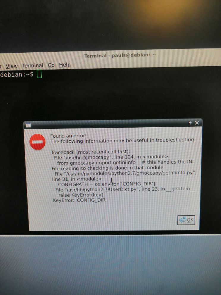

Hello, everyone. Thanks for your input in advance :) Past few days I have been trying to run my spindle using HY vfd drive and RS485 adapter. I could run spindle using windows 10 and Spindle Talker 2 app, so adapter works and my vfd settings are good. Now, it wont work in linuxcnc, nor axis nor gmoccapy interface. I will add all my cnc files, could someone tell me, what is the problem here.. Could there be some other settings, like USB serial etc. to look at. PS. I am new to linux. I do use debian 2.8.  Sometimes I get this error message - see photo.(when linux starting, last photo).

When I start linuxcnc, i get this error:
Debug file information:
HAL: ERROR: duplicate component name 'vfd'
./vfd.hal:1: waitpid failed hy_vfd vfd
./vfd.hal:1: hy_vfd exited without becoming ready
3487
Stopping realtime threads
Unloading hal components
File "/usr/bin/hal_manualtoolchange", line 66, in <module>
nf.start(app); nf.makecommand(app, "_", _)
File "/usr/lib/pymodules/python2.7/nf.py", line 118, in start
source_lib_tcl(r, "accel.tcl")
File "/usr/lib/pymodules/python2.7/nf.py", line 111, in source_lib_tcl
r.tk.call("source", os.path.join(tcl_libdir, f))
KeyboardInterrupt
error reading setup from VFD, retrying
AND if I start one more time, it opens with no errors.

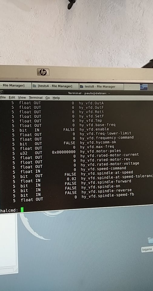

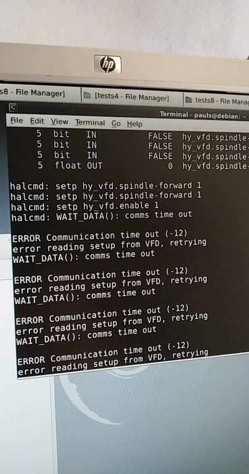

Update:
Now I dont get any errors on starting linuxcnc, but vfd just wont run.
Been trying to change baud rates and other variables.

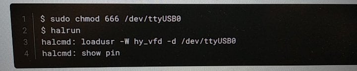

Used these commands:
Does this mean linux sees vfd?? :
And here (I think), I try to run it..

This tells you that the pins from the hy-vfd component are created so the component is running but it is not seeing a reply from the vfd.
So the question is are the setting correct for the serial port (ie baudrate, parity and so on) then the next hurdle is to get the command right that needs to be sent.
Also some VFD's need their serial interface enabled by setting the correct parameters.
Maybe try to swap the TX/RX lines
Setting up serial communication can be a bit of pain if there is no way to monitor what is happening on the line. Even worse trying to troubleshoot from afar.
[edit]
You seem to have used the VFD with the RS485 before so I guess the port settings and the vfd parameters should be ok and it looks like the component should take care of the command structure. Are you sure the RS485 to USB adapter works under linux?
