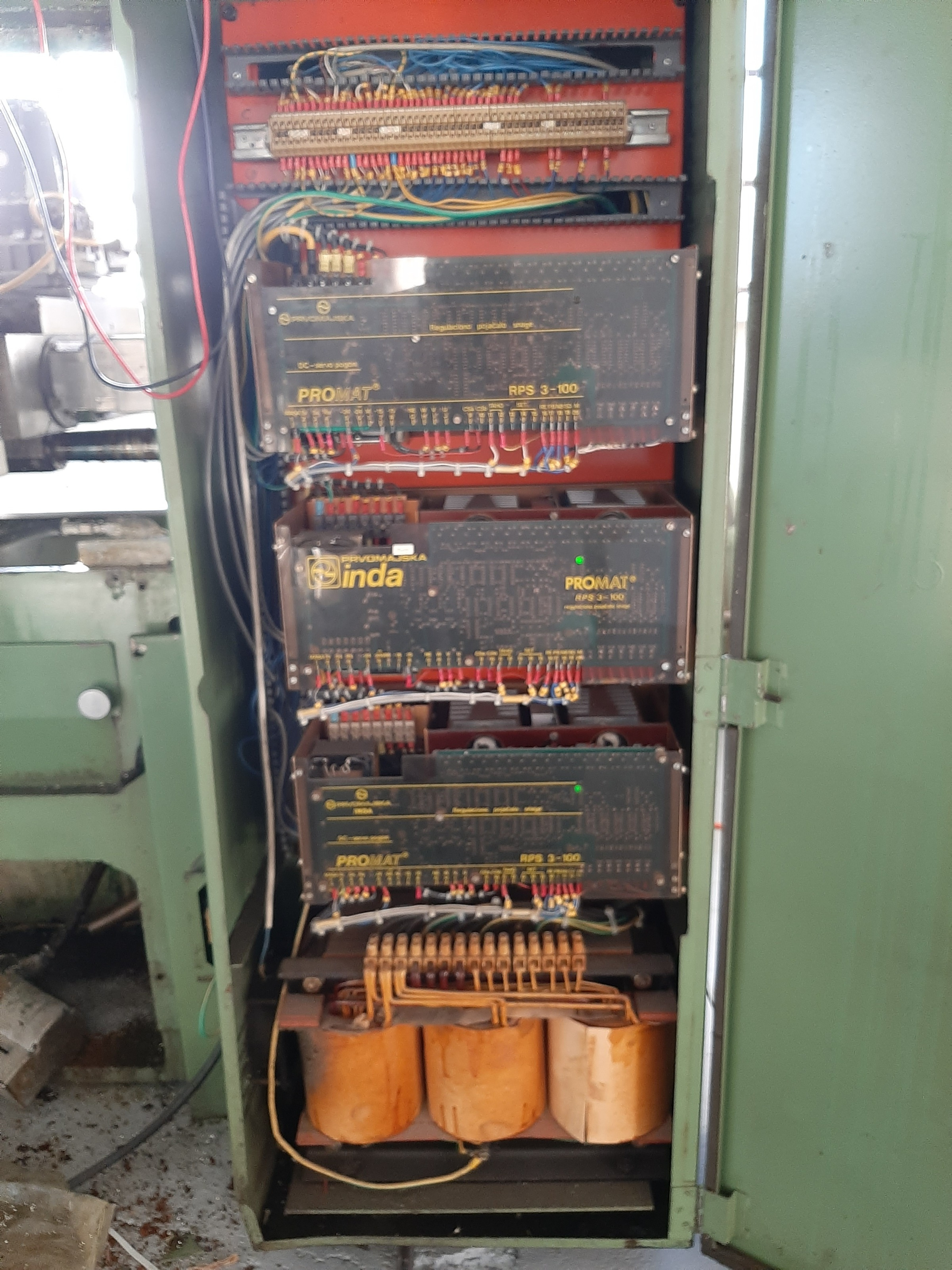

Hi, Tommy , can jou show foto or link of bigger motor.

Prvomajska inda.

Hi , no pictures, did not buy them as i do not have time to do anything with them.
Replied by tommylight on topic Random stuff, reduction, servo motors, ideas and thoughts
Bog Drazene, nemam slike, nisam ih kupio zbog nedostatka vremena.Hi, Tommy , can jou show foto or link of bigger motor.
Translation:

Sjecas se mozda koji su bili? Jesu li jos na prodaji? Od kuda si?
Are they awaleble?
Are they awaleble?

I do not know, they were 4 times bigger than the ones i posted, do not know if they are sold already but i can ask on Monday. I amfrom Peja, Kosovo.
Pojma nemam, bili su oko 4 puta veqi od ovih na slici, ne znam da li su jos uven na prodaji al mogu da pitam u Ponedeljak, Iz Peci, Kosovo.Sjecas se mozda koji su bili? Jesu li jos na prodaji? Od kuda si?
Are they awaleble?

Ok. Pitaj ih .Uslikaj ili saznaj model. Hvala
Ok. Ask them. Take foto or wrote type. Tnx

Prvomajska inda regulators

Will do whenever i get the chance to go there .

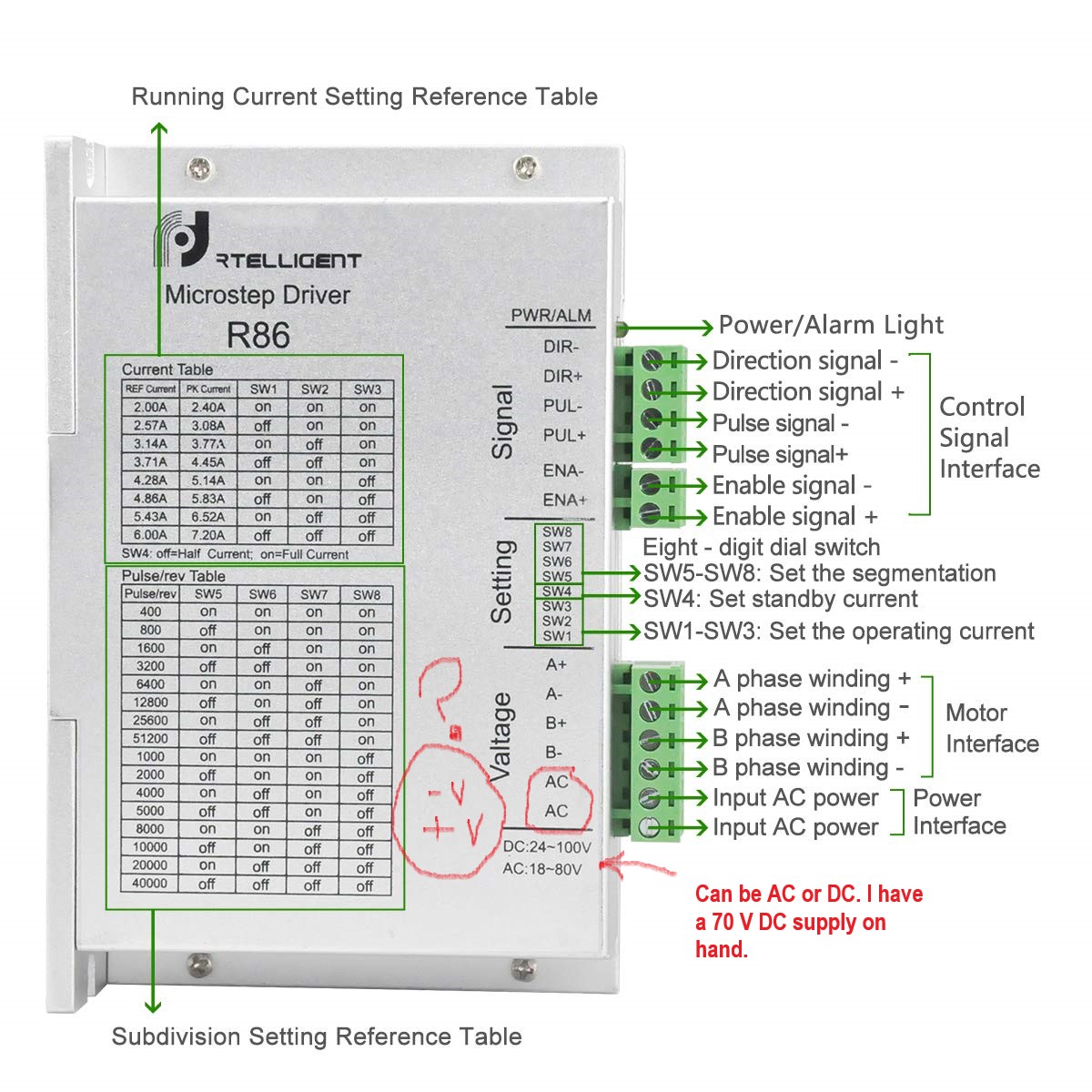

Tom have you ever came across stepper motor drives that can be either AC or DC for the power supply ? i had to pick up some new ones but was in a hurry to get them here ASAP but failed to notice the markings for the motor voltage both being marked AC AC with no polarity marked on them ? all the paper work and marking on the drive say they can use either AC or DC but no way to tell the difference on the polarity for those connections?
long story short i had some drives fail on my temporary set up and was looking for a cheap fix. these drives are far cheaper than the Gecko drives and i'm about broke
