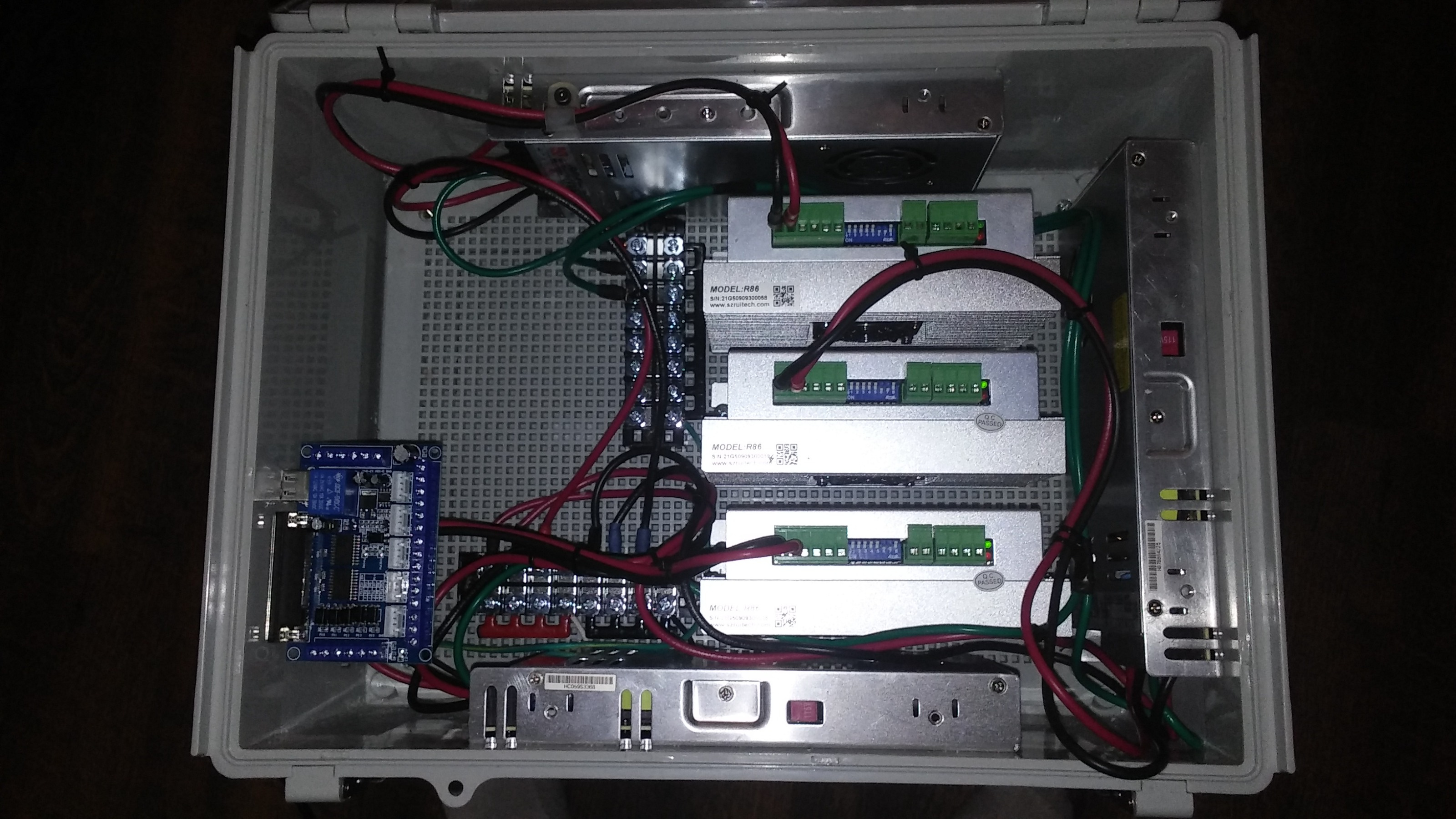

02 Jan 2021 08:52 #193812 by machinedude
I got a few more power supplies and some other odds and ends to at least do a decent control box so i don't have issues again from my laziness :)
this box is on the small side and i had to get creative to fit all this crap inside but at least it's sealed and all in a happy little home :)
this cheap parallel port break out board has zero documentation but seems simple enough to figure out for the control logic wiring. i might have to add a 5V power supply to this depending on this computer? the 5V comes from a USB connection but some computers don't quite put out 5V and if that's the case i think i have just enough room to add one if need be?
so as of now i have the main power end hooked up so i will work on the 5V logic side of wiring it next.
