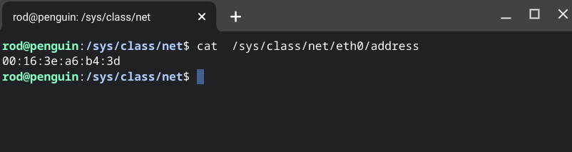

- Posts: 12156
- Thank you received: 4149
16 May 2022 19:22 #243101
Replied by rodw on topic RPI4 - Debian / LinuxCNC / EtherCAT / XFCE
Just check the comments in ethercat.conf. I think you can use eth0 as well as the mac address which may be easier.

16 May 2022 19:52 - 16 May 2022 19:54 #243104
by ftree
Replied by ftree on topic RPI4 - Debian / LinuxCNC / EtherCAT / XFCE
posix / bash has read function
read MAC </sys/class/net/eth0/address
echo $MAC
you beat me to it!
Now how to make a first boot script...
read MAC
write conf
restart services
echo $MAC
you beat me to it!
read MAC
write conf
restart services
