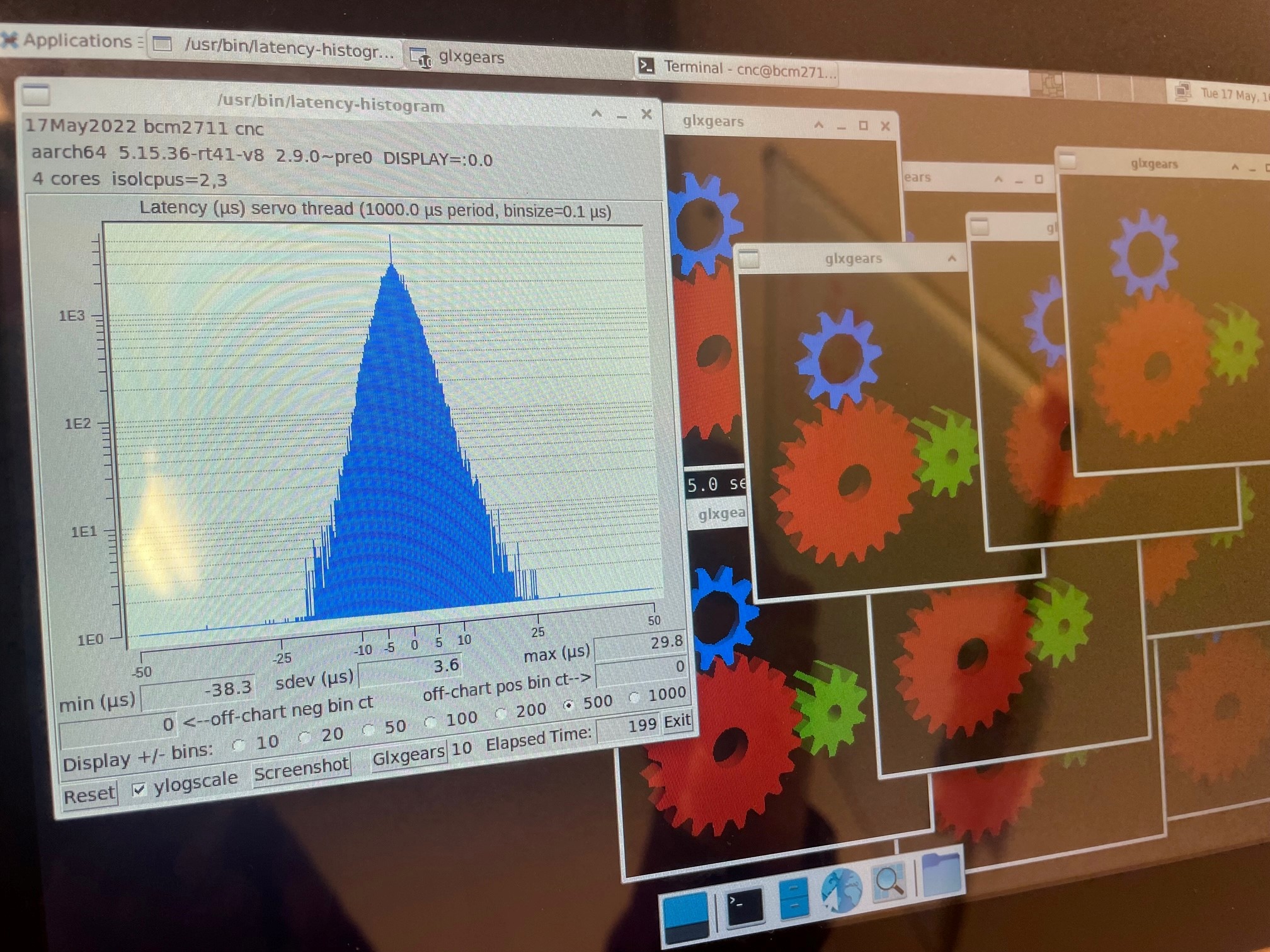

rod, you should be able to mount the boot partition (FAT) and edit cmdline.txt and add isolcpus=2,3 to the end. I don't think any recompile of the kernel is needed.

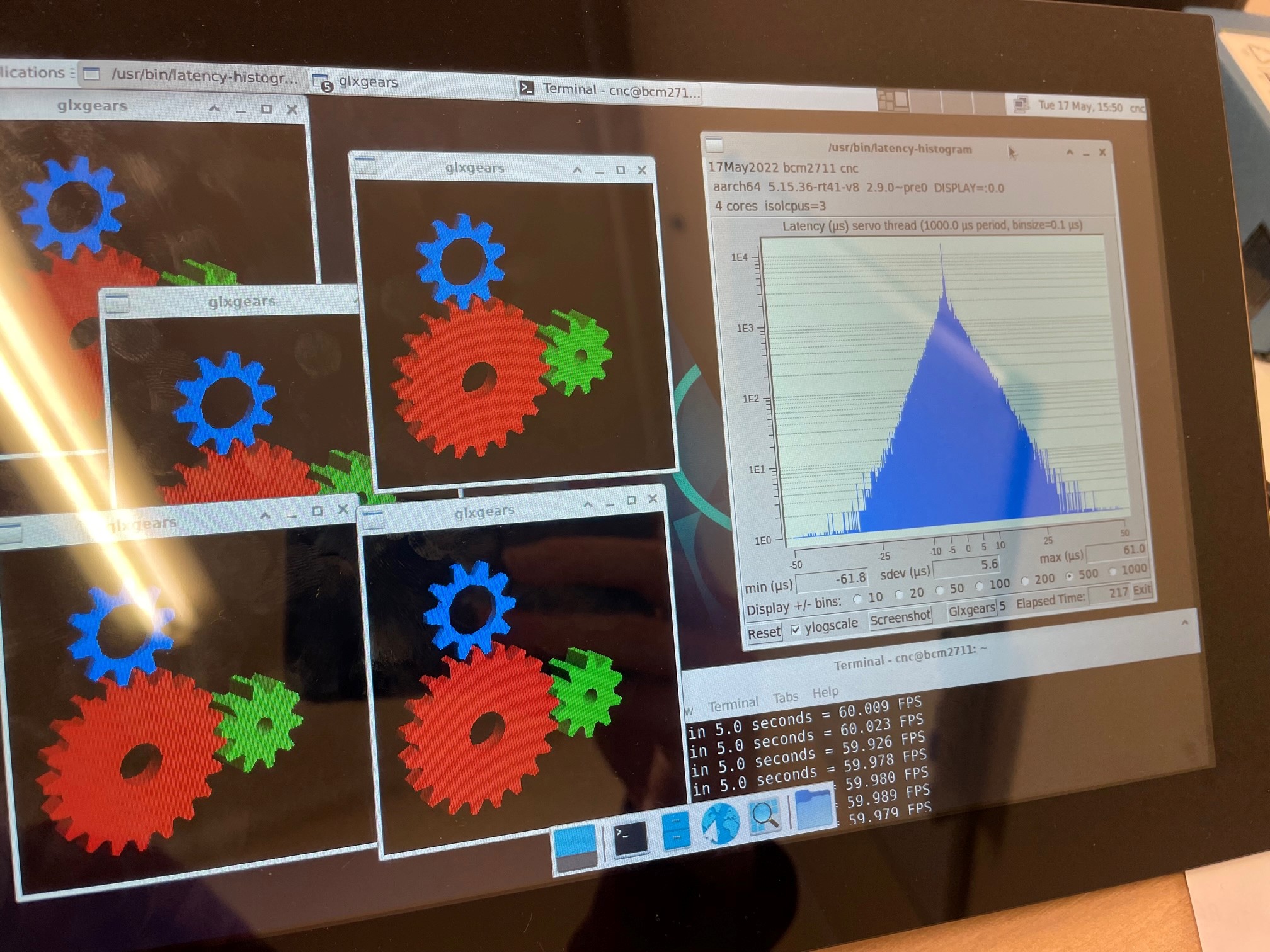

try running
latency-histogram --nobase --sbins 1000
before and after that change and see if you get an improvement. I'll do likewise. on x86 its a basic part of a lcnc install.
Replied by rodw on topic RPI4 - Debian / LinuxCNC / EtherCAT / XFCE
Thanks for reminding me what I did! I had forgotten....rod, you should be able to mount the boot partition (FAT) and edit cmdline.txt and add isolcpus=2,3 to the end. I don't think any recompile of the kernel is needed.
try running

You can check for core isolation by
sudo cat /sys/devices/system/cpu/isolated
the dev of the rpi-builder also have a neat tools to alter the governor / cpu speed
governor -h
-c Conservative
-o Ondemand
-p Performance
governor -h
-c Conservative
-o Ondemand
-p Performance

17 May 2022 21:51 #243206
by ftree
Replied by ftree on topic RPI4 - Debian / LinuxCNC / EtherCAT / XFCE
- Posts: 12156
- Thank you received: 4149
17 May 2022 22:00 #243207
Looks great. Better than my production machines

17 May 2022 22:18 - 17 May 2022 22:25 #243210
by ftree
Last edit: 17 May 2022 22:25 by ftree.
- Posts: 12156
17 May 2022 22:34 #243214
yeh, I thought 2,3 was better but it got up there. leaving it for the day while I go to work.
also need to install xfce4-screenshooter to enable the printscreen button.
So I can save my results.

18 May 2022 00:14 #243230
by ftree
I've left overnight 10 glx gears and two windows of 1080p YT vids going.
I need heavy rain after today!
