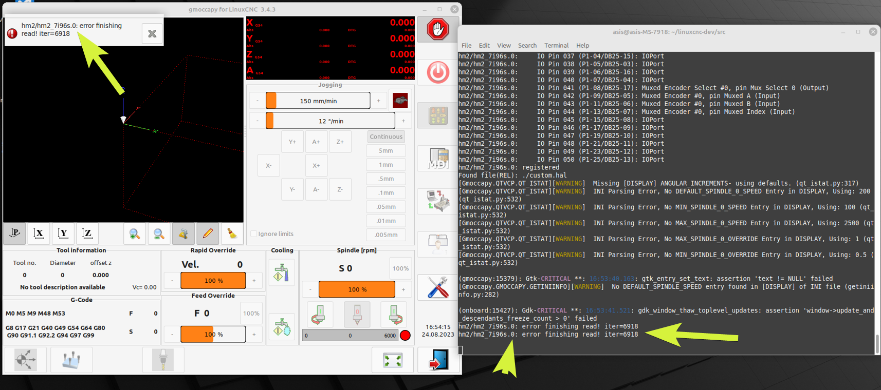

Today I remove Nvidia graphic card and Re-install mint 21.1
install kernel RT 6.1
install linuxcnc via link linuxcnc.org/docs/html/code/building-linuxcnc.html
then
go to create new file linuxcnc name test1.conf then type.....
(in first time can't open cause no install opengl ,I back to solution of mr. Aciera in this topic and it's can run )
then have error hm2/hm2_7i96s.0: error finishingread! iter=6918
mr.Aciera ever told not serious in upper comment about firmware hotmot2 old model (my board 7i96s) but ,I not sure this same or problem.
I must fix it's or not ?

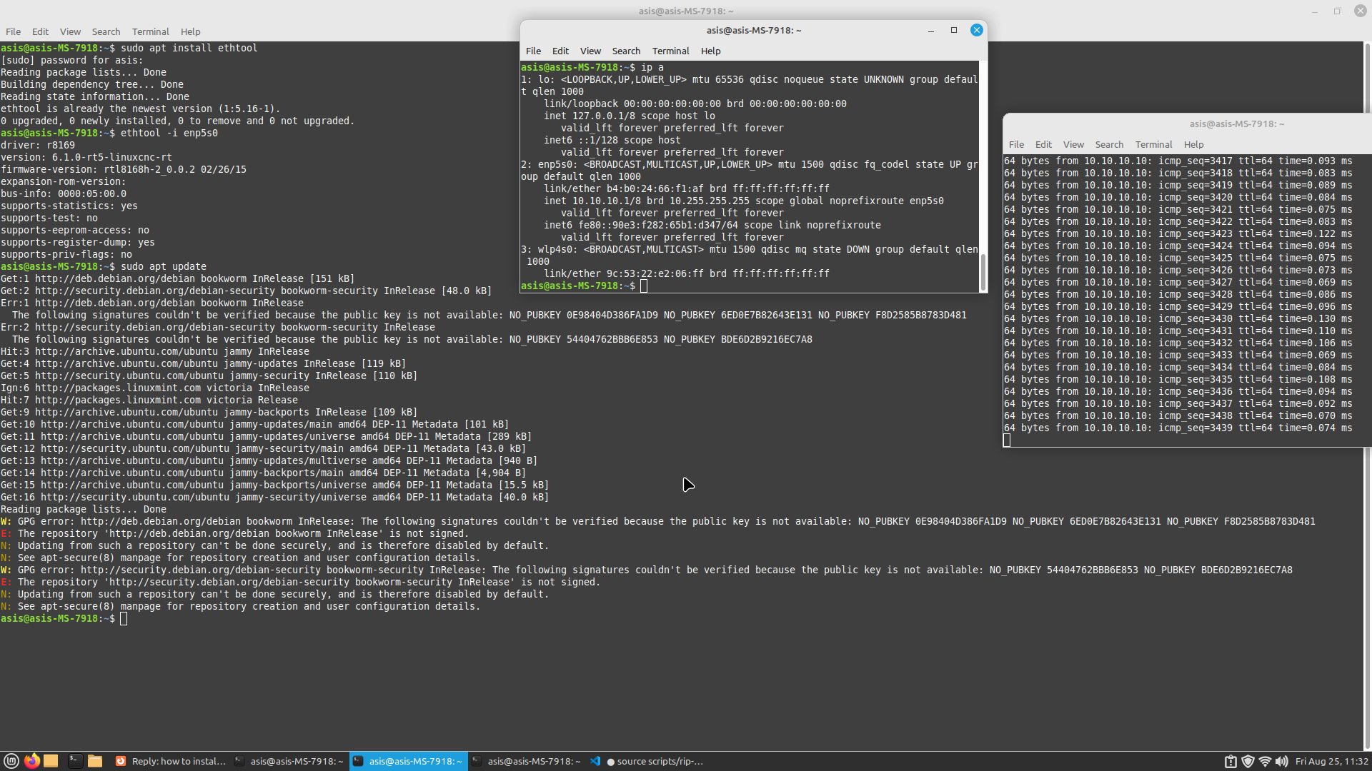

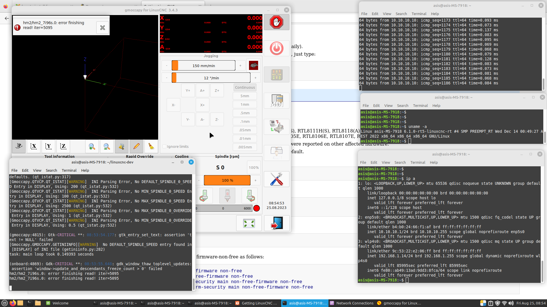

24 Aug 2023 21:02 #278894
by abdulasis12
ping work
but, when call gmoccapyfor linuxcnc up.
ping will stop respond and show massage :hm2/hm2_7i96s.0: error finishing read! iter=2096
I try close gmoccapyfor linuxcnc ,ping will back to respond status again.
maybe I must update driver Lan card ? how to ?

24 Aug 2023 23:35 #278899
by abdulasis12
Now I do10. Realtek network drivers
It's have 2 error when sudo apt update.
but ping to 10.10.10.10 responded.
I tryit's look same result is >>>>

25 Aug 2023 02:13 #278906
Replied by rodw on topic how to install linuxcnc on mint I'm newbie
We can't really help with this sort of stuff. My best advice would be to grab my new installer and revert to Debian
forum.linuxcnc.org/9-installing-linuxcnc...or-linuxcnc-x86-only
As expected, looks like you do have a problem R8168 NIC interface
9 & 10 have proven to be winner for a lot of people.
Using an Ubuntu based distro you are on your own.
