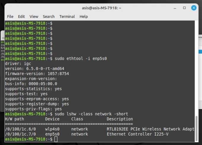

Today I recieved new PciE LAN Card.
I remove Pcie old out (Realtek chip) and install new Lan card intel chip I225 .
I type interminal sudo apt update and sudo apt upgrade done (it's must do or not ?)
I open Linuxcnc.
now it's can operate run.

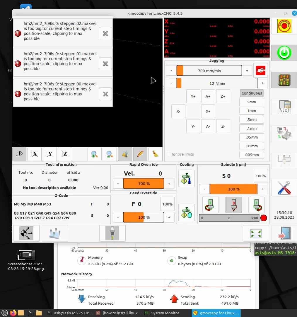

But..... when start linuxcnc GUI up it's have 3 pop-up
hm2/hm2_7i96s.0: stepgen.00.maxvel is too big for current step timings & position-scale, clipping to max possible
hm2/hm2_7i96s.0: stepgen.01.maxvel is too big for current step timings & position-scale, clipping to max possible
hm2/hm2_7i96s.0: stepgen.02.maxvel is too big for current step timings & position-scale, clipping to max possible
this is I setting in pncconf

The problem is that your setup cannot produce the step frequency necessary to drive the step generator fast enough to give you the maximum velocity of 7000mm/min.
The maximum step frequency depends on you jitter (see section 3):
linuxcnc.org/docs/devel/html/config/stepconf.html
Are you sure the 'Step scale' is 2000 steps/mm? If that is indeed the case then I don't think you will be able to get anywhere near 7000mm/min out of this machine using a parallel port.

Thank you for information.
Now I change max vel to 4000 mm/mins
and change 1000step/mm
I will change electronic gear inside servo drive new for match 1000 step/mm again.
now I try open linuxcnc GUI now no pop-up
and can run finish G-code no error.
Thank you.

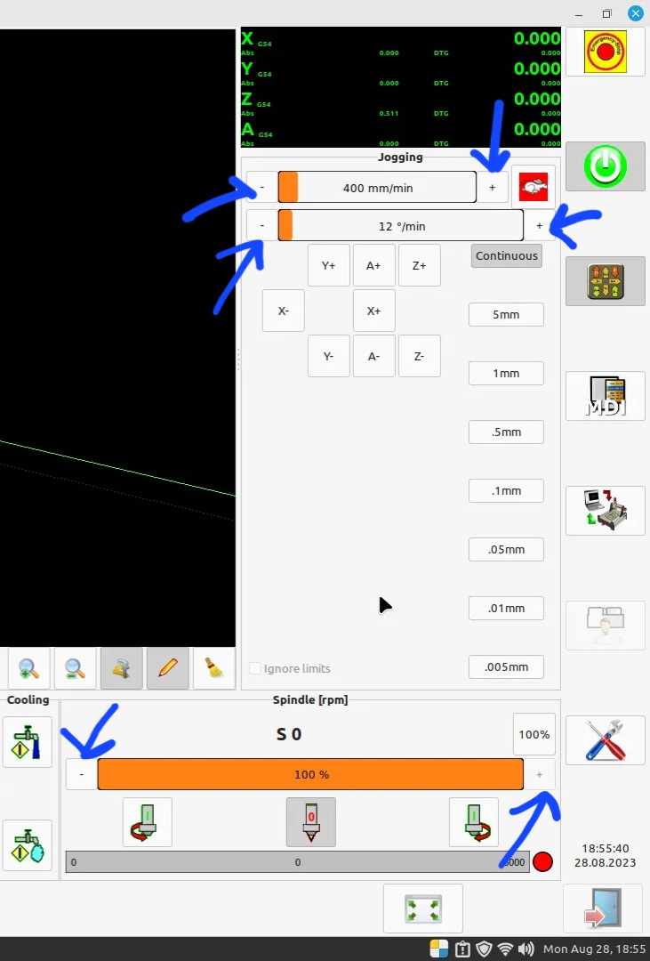

I have 1 more question.......
why I Click button - , + on screen it's not increase,decrease value ?

28 Aug 2023 07:20 #279158
by abdulasis12
In GUI "LinuxCNC Configuration Selector CURRENT :gmoccapy_4_axis.ini"
then I click OK. (sumilation this way can try or not ?)
when new windows up I click Emer Button on screen and Turn machine , Go home.
I try click button - , + can't increase or decrease too.
Replied by abdulasis12 on topic how to install linuxcnc on mint I'm newbie
I Type Terminal linuxcncCan you open a simulation configuration for gmoccpy (eg /Sample Configurations/sim/gmoccapy/gmoccapy) from the configuration picker see if it works there?
If it does then please post the .hal and .ini files of your machine configuration.

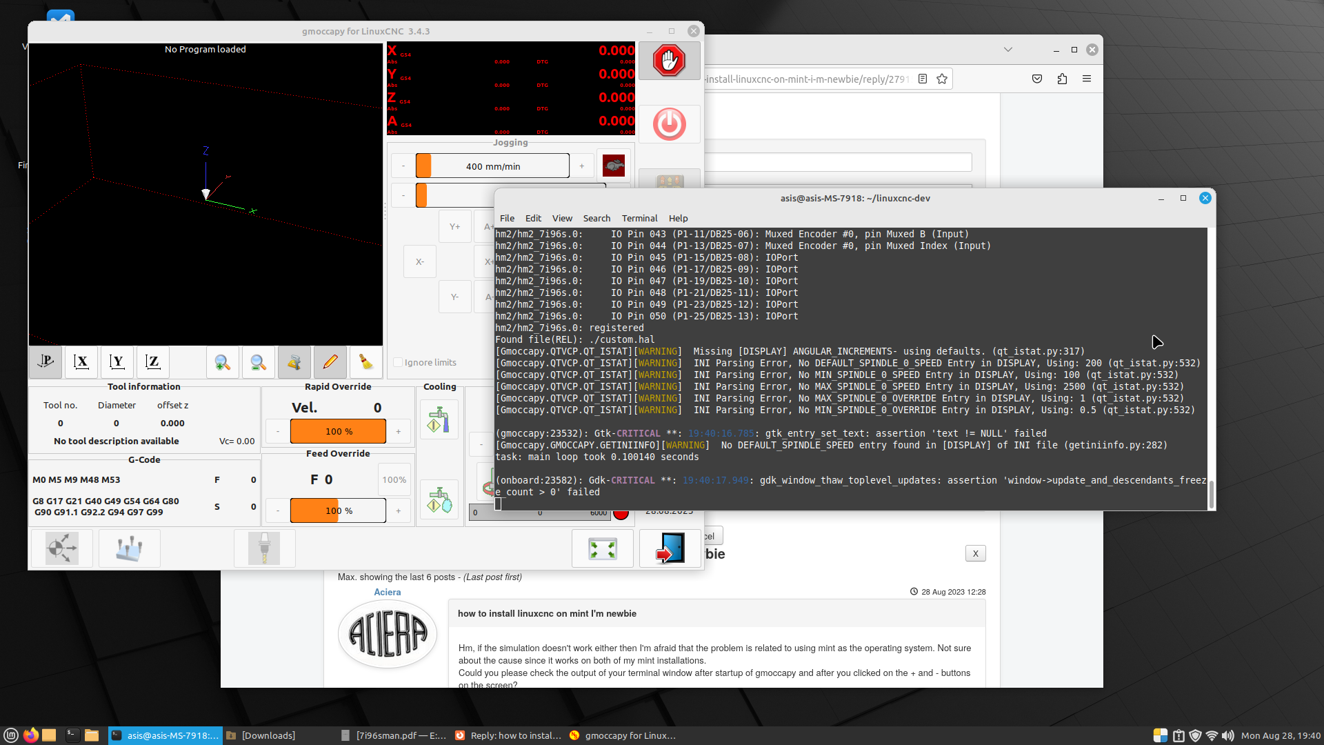

28 Aug 2023 07:41 #279160
by abdulasis12
this clip
it's have 7 WARINING and 2 CRITICAL when start up program.Hm, if the simulation doesn't work either then I'm afraid that the problem is related to using mint as the operating system. Not sure about the cause since it works on both of my mint installations.
Could you please check the output of your terminal window after startup of gmoccapy and after you clicked on the + and - buttons on the screen?
this clip

28 Aug 2023 09:27 #279172
Replied by Aciera on topic how to install linuxcnc on mint I'm newbie
I get the first 'Critical' message on my systems as well but not the second one about gdk 'window->update_and_descendents_feeze_count > 0' failed
I'm afraid I can't really help you with this other than maybe try to upgrade the installtion:
$ sudo apt update
$ sudo apt upgrade
I believe you changed the PC (or motherboard), if so have you tried to install debian bookworm again on this new hardware?
$ sudo apt update
$ sudo apt upgrade
