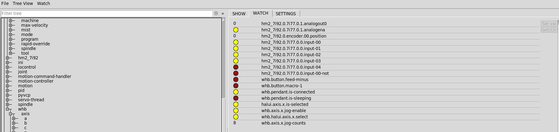

I bought a new XHC-WHB04B-6 pendant and have the buttons working and display reporting the correct positions,  but I cannot get the dial to work.
When I run the xhc-whb04b-6 in event mode (xhc-whb04b-6 -eu)  I see events getting generated when I turn the dial.
When I run the  xhc-whb04b-6 in hal mode (xhc-whb04b-6 -p), I see events for the other buttons and when I switch the setting to select the various axis, but I do not see any events when I turn the dial.   I assume I should...
Attached are my hal files and outputs from the above two commands.
Anyone else have this working and be willing to see if they get hal events?    That would at least give me somewhere to start digging.

14 Nov 2023 04:20 #285338 by SkyMoCo
Replied by SkyMoCo on topic XHC-WHB04B-6 and LinuxCNC 2.9.1
 Getting closer, there must be something in my config as the events from spinning the jog wheel are getting through as the "jog counts" counter is incrementing.
16 Nov 2023 02:53 #285567 by rodw
Replied by rodw on topic XHC-WHB04B-6 and LinuxCNC 2.9.1
Are you in the right mode to enable Jogging? (Teleop)
16 Nov 2023 04:02 #285571 by SkyMoCo
Ah, thanks. I found my problem. Not sure where this line came from but when I removed it my jog dial started worked. Just needed the right hint.
This is the line I removed. Not sure if shows this way on the screen, but this is one line...
net pdnt.mode.is-manual halui.mode.is-manual whb.halui.mode.is-manual whb.halui.mode.is-teleop
