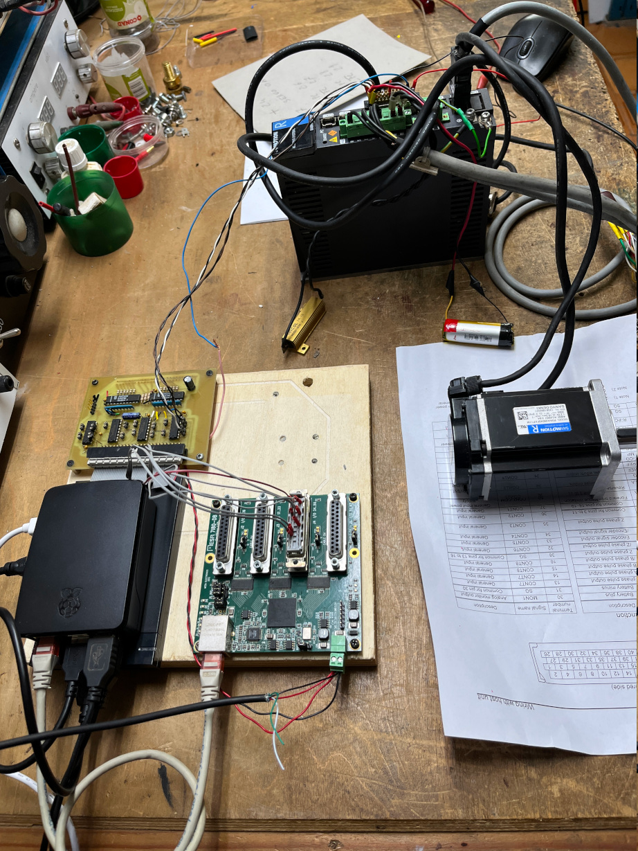

so it's perfect! if I think how much time I wasted with a nuc i3 to improve the latency without succeeding... I need it to tune up some drives that I recovered 2 years ago, now I also have the servos. if anyone knows these maybe they can give me some advice on how to use them in the best way.
drive Sanmotion rs2aa03a0al0 motor r2aa06040fxp
Last edit: 15 Jun 2025 14:14 by billykid. Reason: add image
