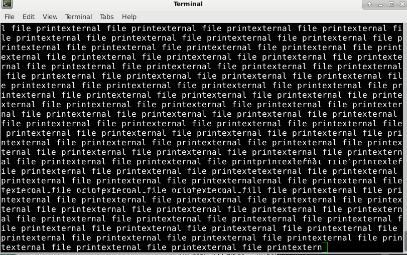

28 Oct 2018 15:18 - 28 Oct 2018 15:30 #119566 by Grotius
Replied by Grotius on topic Ethercat HAL driver
Okey guy's,
I have some news. Struggling with include files in hal.
Done some test's. I needed the "/opt/etherlab/include/ecrt.h" to work with linuxcnc hal. In hal we can couple a lot of stuff.
Nothing happened and linuxcnc refused to load dlopen .....
So i start from zero with a sucesfull test to that directory, to print some info.
Next thing will be integrating a bigger file.
in postgui.hal
loadrt ethercat
addf ethercat servo-thread
ethercat component, ethercat.comp :
(compiled in terminal by : sudo halcompile --install ethercat.comp)
component ethercat"ethercat";
description
Test Component
author "Grotius CNC Machines, started Oktober 2018";
license "GPL";
option singleton yes;
//Input hal connection :
pin in bit Testpin_in            "Enable this component";
//Output hal connection :
pin out bit Testpin_out          "Connect to user gui led";
function _;
#include <stdio.h>
#include "/opt/etherlab/include/external_file.h"
typedef enum { INIT, SELECT} state_T;
state_T state = INIT;
FUNCTION(_) {
    switch(state){
         case INIT:
         state = SELECT;
         break;
    case SELECT:
        // do something with the include file
        function_print();
        break;
The external_file.h is located in directory : /opt/etherlab/include/external_file.h
The file below is : external_file.h (it is a short file, only containing a function with a print message, for fun, function is in fact : () )
Inside the function we say only print some info :
#include<stdio.h>
	int function_print()
		printf("external file print");
	    return 0;
Output in linuxcnc terminal :
So i think this is a first start to use Ethercat to Linuxcnc hal for me.
Last edit: 28 Oct 2018 15:30 by Grotius.
