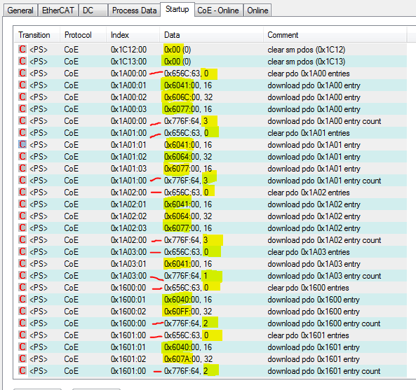

Hello all
I am still striking out with my ProNet servo drive. Totally.
You'll recall that, using the generic driver, hal loads lcec with dmesg errors:
My ProNet drive remains in PREOP, and all my hal pins are zeros.
Every time.
Chimeno suggested that I "should load the whole servo configuration through the generic module before reaching your OP status."
Using the attached pronet_5.xml, I tried to do so with sdoConfig stanzas, with the usual, familiar result.
Can you confirm that my byte ordering is correct? In this code fragment, for example,
I am trying to assign data meaning "idx=0x6041, subidx=0 bitlen=16" to the sdo at 0x1A02:1. (I tried it a couple ways)
There is a 'startup' tab in TwinCAT which lists a startup sequence which includes initialization of the un-used TX- and RXPDOs.
The items flagged in red look mighty odd to me for an 8-bit field, but I suppose that, with the right endian-ness it might work.
I tapped this startup sequence, in order, into a bunch of sdoConfig tags and fed them to lcec's generic driver.
This xml is attached as pronet_6.xml and, once again, I got the same old error.
Chimeno also suggests that "a clue would be to look at the error report in the driver through the TWINCAT3 program to see what error it gives you." I'm afraid I have no clue how to do that.
Attachment not found
