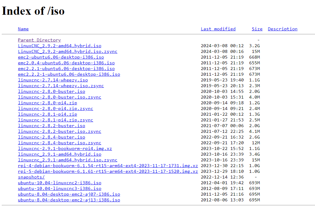

- Cristian_g
- Posts: 5
05 Jun 2024 16:33 #302392
by Cristian_g
Replied by Cristian_g on topic Notes from installation of ethercat on Raspberry Pi 4
Hi, sorry for asking too many questions. In the linuxcnc downloads web page,there is this note";“linuxcnc-uspace” will also run on a standard Linux kernel for use as a simulator, but it should not be used to control hardware."
Does it mean that in order to actually run a machine, I have to use the “linuxcnc” with specific RTAI kernel?
Please let me know which package I have to download! Thank You!
- Posts: 22021
- Thank you received: 7496
05 Jun 2024 16:39 #302393
RTAI version is more for use with parallel port.
Replied by tommylight on topic Notes from installation of ethercat on Raspberry Pi 4
This can be used to control machines when using the RT-Preempt kernel, it can not be used to control machines when using normal "generic" kernel.“linuxcnc-uspace” will also run on a standard Linux kernel for use as a simulator, but it should not be used to control hardware."

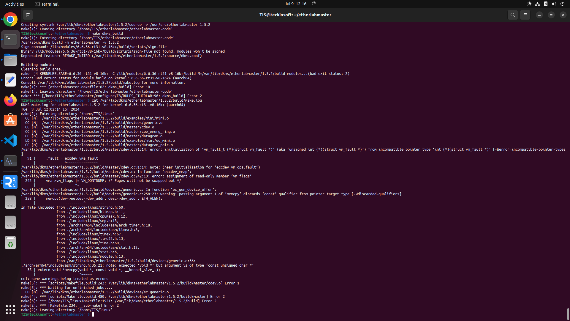

09 Jul 2024 06:55 #304732
by seyad
Replied by seyad on topic Notes from installation of ethercat on Raspberry Pi 4
- Posts: 12171
- Thank you received: 4153
09 Jul 2024 08:06 #304733
Replied by rodw on topic Notes from installation of ethercat on Raspberry Pi 4
3 years is a long time in this space.
I would try installing the Raspberry pi 5 image on the downloads page and then follow these instructions
forum.linuxcnc.org/ethercat/45336-etherc...-how-to-step-by-step
The ethercat repositories should be installed for you already so hopefully, you will find there is no need to build from source if iGh supports the pi5 now.

- seyad
- Posts: 23
31 Jul 2024 12:33 #306513
by seyad
At the point of "Test ethercat with linuxcnc " i am facing issues like "lFound file(REL): ./ethercat.hal
lcec: dlopen: libethercat.so.1: cannot open shared object file: No such file or directory"
But path my directory (path=$PATH:/usr/local/lib)
- bkt
- Posts: 1111
- Thank you received: 114
31 Jul 2024 16:46 #306547
by bkt
Replied by bkt on topic Notes from installation of ethercat on Raspberry Pi 4
you check id uefi or not as rodw explain here: forum.linuxcnc.org/ethercat/45336-etherc...-how-to-step-by-step ??
In my case need (not uefi but have that error because not all libs needed was installed) to install libethercat 2 time second one using synaptic. After it goes ....
- Posts: 12171
31 Jul 2024 19:44 #306560
Thanks for reminding me of this. This is probably the issue I have with installing ethercat.
