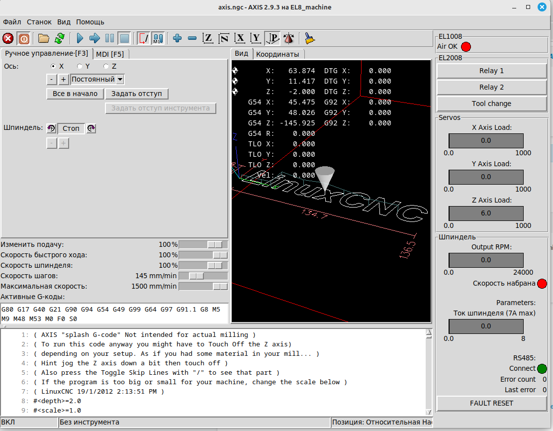

Hi. If you figure out how I can send you 10GB of data, I can send you an acronis image of my system, the drivers are already installed and the configuration runs.
Thank you very much for the offer. wouldnt this be full of configurations made exactly to your hardware? not sure this is the best method to fix...
01 Sep 2024 20:38 #309168 by jimwhiting
Replied by jimwhiting on topic Marco Reps video on youtube about EtherCAT
You might want to check the ethercat_conf file name... You config uses ethercat-conf (hyphen) where the files is usually an ethercat_conf (underscore).
02 Sep 2024 02:02 #309184 by COFHAL
02 Sep 2024 02:27 - 02 Sep 2024 02:28 #309185 by chrisfischer
Replied by chrisfischer on topic Marco Reps video on youtube about EtherCAT
Thanks for the comments guys, running this fixed my issue.(not sure why)

I pulled myself together and added a spindle frequency drive control panel via RS485 modbus
I did it through vfdmod and it works great
