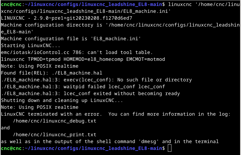

When I configured my xml file I used the halrun to load lcec_conf from the command line without the GUI to check it was all okay.
I don't quite understand what I should do
Can you do "ethercat -v slaves" to grab the model numbers etc just to check they match your XML. After that you will need to catch a more specific error out of the lcec_conf output to narrow down what is wrong.

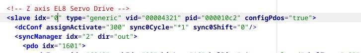

HI
I think in the .xml file slave idx should start from 0
Hello
Yes, it confused me too, I redid it, but it didn't change anything

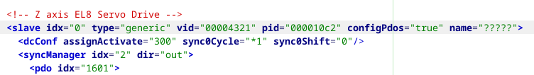

<masters>
  <master idx="0" appTimePeriod="1000000" refClockSyncCycles="5">
    <!-- Z axis EL8 Servo Drive -->
    <slave idx="0" type="generic" vid="00004321" pid="000010c2" configPdos="true">
      <dcConf assignActivate="300" sync0Cycle="*1" sync0Shift="0"/>
      <syncManager idx="2" dir="out">
        <pdo idx="1601">
          <pdoEntry idx="6040" subIdx="00" bitLen="16" halPin="cia-controlword" halType="u32"/>
          <pdoEntry idx="6060" subIdx="00" bitLen="8" halPin="opmode" halType="s32"/>
          <pdoEntry idx="607A" subIdx="00" bitLen="32" halPin="target-position" halType="s32"/>
        </pdo>
      </syncManager>
      <syncManager idx="3" dir="in">
        <pdo idx="1a00">
          <pdoEntry idx="6041" subIdx="00" bitLen="16" halPin="cia-statusword" halType="u32"/>
          <pdoEntry idx="6061" subIdx="00" bitLen="8" halPin="opmode-display" halType="s32"/>
          <pdoEntry idx="6064" subIdx="00" bitLen="32" halPin="actual-position" halType="s32"/>
          <pdoEntry idx="606C" subIdx="00" bitLen="32" halPin="actual-velocity" halType="s32"/>
          <pdoEntry idx="6077" subIdx="00" bitLen="16" halPin="actual-torque" halType="s32"/>
        </pdo>
      </syncManager>
    </slave>
    <!-- Y axis EL8 Servo Drive -->
    <slave idx="1" type="generic" vid="00004321" pid="000010c2" configPdos="true">
        <pdo idx="1601">
        </pdo>
      </syncManager>
        <pdo idx="1a00">
        </pdo>
      </syncManager>
    </slave>
    <!-- X axis EL8 Servo Drive -->
    <slave idx="2" type="generic" vid="00004321" pid="000010c2" configPdos="true">
        <pdo idx="1601">
        </pdo>
      </syncManager>
        <pdo idx="1a00">
        </pdo>
      </syncManager>
    </slave>
    <slave idx="3" type="EK1100"/>
    <slave idx="4" type="EL1008"/>
    <slave idx="5" type="EL2008"/>
  </master>

28 Aug 2024 21:35 - 28 Aug 2024 22:20 #308916 by jjdege
Replied by jjdege on topic Marco Reps video on youtube about EtherCAT
I think the device name that is displayed in HalShow is missing
I looked at Rod's configuration here , and the device has no name.
maybe with cia.402 it is not needed
Last edit: 28 Aug 2024 22:20 by jjdege.

29 Aug 2024 07:42 #308922 by rodw
its not finding your xml file, try
loadusr -W lcec_conf ./ethercat-conf.xml
29 Aug 2024 22:16 - 29 Aug 2024 22:20 #308983 by Evgeny
Replied by Evgeny on topic Marco Reps video on youtube about EtherCAT
I think I can help you. You can add me on WeChat: 304394405. I will use AnyDesk to assist you remotely.
Hi, I can't register in WeChat, I can't verify my account in my country
Is it possible to use another method of communication? Telegram?
loadusr, command not found
Last edit: 29 Aug 2024 22:20 by Evgeny.

30 Aug 2024 00:15 #308994 by tommylight
Replied by tommylight on topic Marco Reps video on youtube about EtherCAT
That line has to be in the ha; file, not in a terminal.

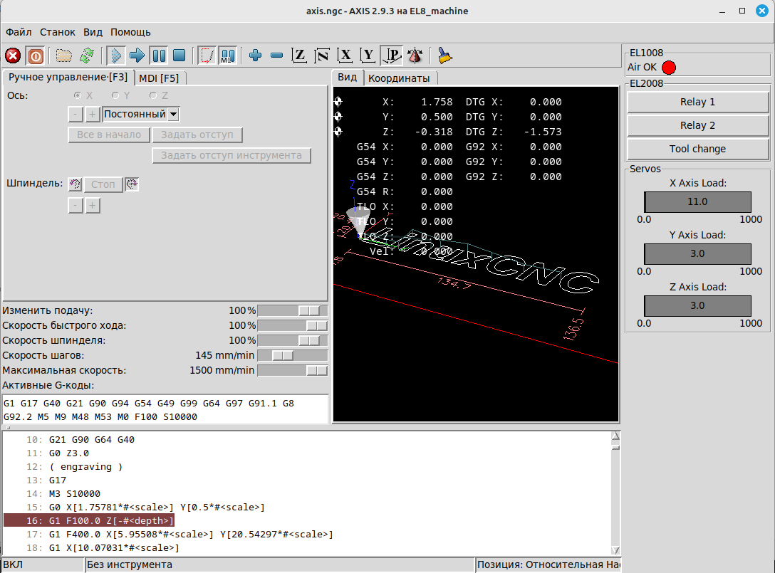

31 Aug 2024 21:16 #309114 by Evgeny
Guys, tell me how to set up a search for a home position with a torque limitation on mechanical stops as in the video by Marco Reps, onceloved   helped me a lot to get the configuration up and running, but I still have one problem
onceloved , Thank you very much for your help!
Please see my configuration, it starts and can control the motors! But I can't set up the home position detection with torque limitation
File Attachment:
File Name: linuxcnc_l..._EL8.zip
File Size:21 KB
31 Aug 2024 23:42 - 01 Sep 2024 00:03 #309119 by Aciera
Replied by Aciera on topic Marco Reps video on youtube about EtherCAT
Seems you are not actually using the custom homing component 'el8_homecomp.comp'.
[edit]
see this earlier post:
forum.linuxcnc.org/ethercat/51830-marco-...rcat?start=20#302562
[edit 2]
Note that the commands in the above linked post look wrong to me:
'sudo homecomp --install el8_homecomp.comp'
should actually be:
sudo halcompile --install el8_homecomp.comp
for halcompile you need to install the 'linuxcnc-dev' package.
Last edit: 01 Sep 2024 00:03 by Aciera.
