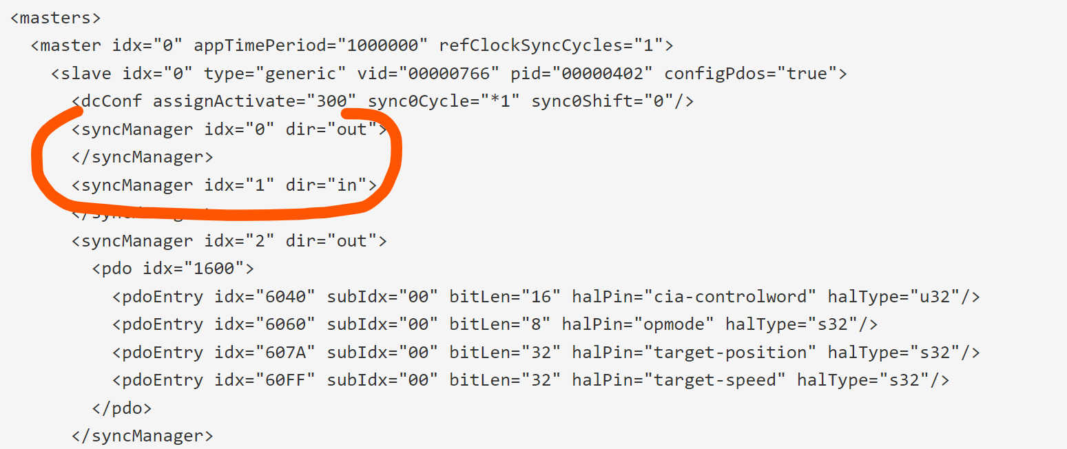

Has anyone managed to get DO to work?
I added the following lines inside <pdo idx="1600">, but to no avail.
<pdoEntry idx="60FE" subIdx="01" bitLen="32" halType="complex">
<complexEntry bitLen="16"/>
<complexEntry bitLen="1" halPin="do-0" halType="bit"/>
<complexEntry bitLen="1" halPin="do-1" halType="bit"/>
<complexEntry bitLen="1" halPin="do-2" halType="bit"/>
</pdoEntry>
Last edit: 22 Aug 2024 20:54 by avive.
