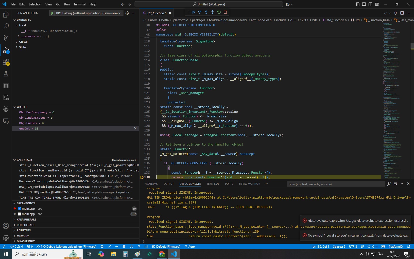

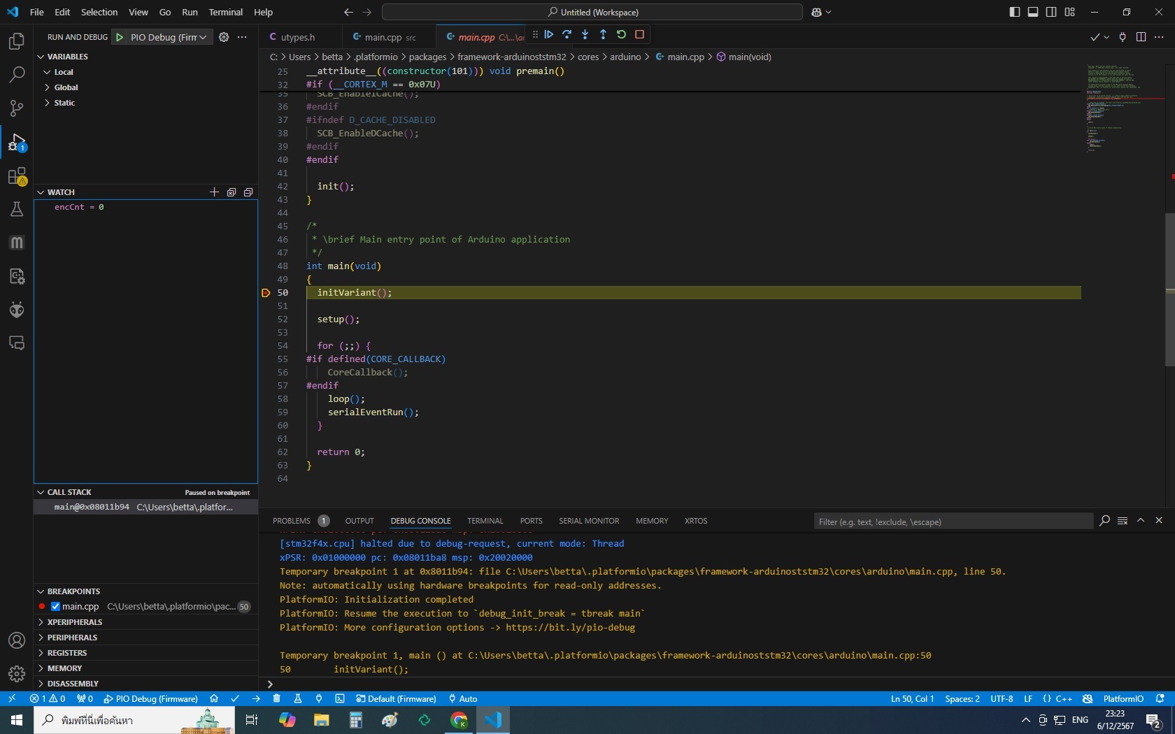

06 Dec 2024 16:32 - 06 Dec 2024 17:25 #316117 by SOLD
Replied by SOLD on topic AX58100
I think I successfully entered debug mode, but when I rotate the shaft, no change is detected in encCtn. Or I am viewing incorrect information.
Eventually, as I tested the method further, I found that it actually counted…it worked.
Last edit: 06 Dec 2024 17:25 by SOLD.
  • Hakan
  • Away
  • Platinum Member
  • Platinum Member
06 Dec 2024 18:05 #316122 by Hakan
Replied by Hakan on topic AX58100
Congrats to that, the debugger is a big big help, for some problems.
As you found out, the variable updates when the program is paused, or stepping.
The following user(s) said Thank You: SOLD
