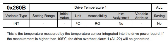

$lcecObject.pll-error-count is holding at 2. I haven't seen it increase yet.
I want to read some more data from the drives, and it won't work. See attached iX7NH.xml, line 23. I want to see the temperature values from the drive, but I can't read them. As shown, where pdoEntry idx="260B", the drive stays in PREOP (see dmesg output in dmesg260B.txt). If I change the index to "2606", the drive will go to OP (see dmesg output in dmesg2606.txt) and I can see the number through HAL (that I don't want). Registers 2606 and 260B are both 16 bit signed integers.
Any of 260B, 260C, or 260D (all temperature sensors in the servo system) have the same effect.
I can read the values manually with "ethercat upload -p0 -t int16 0x260B 0" and I get some number.
The drive manual says I can read up to 10 registers with one TxPDO: I have 6.
It also says that I am limited to 28 bytes in one TxPDO: I have 13.
How do I do this?
How do I do this?

With pll-reset-count steady at to 2 it should be fine.
Try to locate temperature sensors in the pdo listing from "ethercat pdos".
I suspect you are addressing a sdo with 2605 and that won't work.
You'll find out from the ethercat pdos listing.

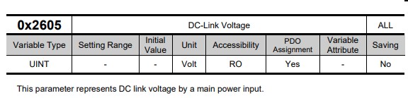

Output from "ethercat pdos" in attached file.
0x2605 works just fine: that's the DC link voltage and I can read that from all 3 drives.
0x260B does not.
The drive manual doesn't discuss SDOs, or whether some data index is a PDO or SDO. I would hope a temperature sensor would be continuously readable, which would require it to be a PDO.
0x260B does not.
Last edit: 04 Dec 2025 18:33 by nanowhat.

I figured it out. The manual doesn't explicitly mention SDOs but it does say whether an index can be assigned to a PDO and I ignored that information the first time around.
260B, 260C, and 260D cannot be assigned to a PDO.
Is there another way of getting this information into HAL, or do I need to write a custom component?
