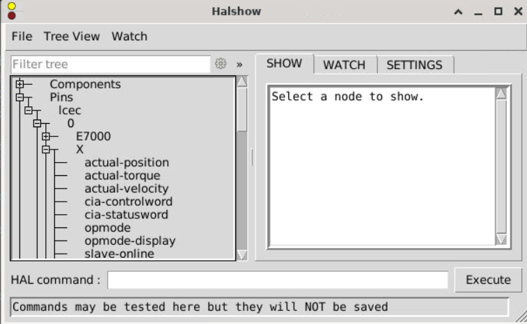

- Posts: 12156
- Thank you received: 4149
24 Oct 2025 07:29 - 24 Oct 2025 07:29 #337025
Replied by rodw on topic Help with Delta E3 Ethercat drives - hal and ethercat-conf.xml
with just one drive, the cia402 is probably numbered 0. Your 3. is coming from these lines in your hal. If in doubt, comment them all out so LinuxCNC ipens, then use halshow to work out the correct pin names# ethercat to cia402 driver
net x-statusword lcec.0.3.cia-statusword => cia402.0.statusword
net x-opmode-display lcec.0.3.opmode-display => cia402.0.opmode-display
net x-drv-act-pos lcec.0.3.actual-position => cia402.0.drv-actual-position
# cia402 driver to ethercat
net x-controlword cia402.0.controlword => lcec.0.3.cia-controlword
net x-modes-of-operation cia402.0.opmode => lcec.0.3.opmode
net x-drv-target-pos cia402.0.drv-target-position => lcec.0.3.target-position
Last edit: 24 Oct 2025 07:29 by rodw.

24 Oct 2025 07:32 - 24 Oct 2025 07:33 #337026
by Hakan
Replied by Hakan on topic Help with Delta E3 Ethercat drives - hal and ethercat-conf.xml
Here is a way to check pin names without modifying the hal file.
Use the halrun command (linuxcnc off), load lcec and lcec_config. The start halshow in another window and explore names.
debian@plasma:~/linuxcnc/configs/QtPlasma$ halrun
halcmd: loadusr -W lcec_conf ethercat-conf.xml
halcmd: loadrt lcec
Note: Using POSIX realtime
halcmd:
halcmd: loadrt lcec
halcmd:
Last edit: 24 Oct 2025 07:33 by Hakan. Reason: bbcode

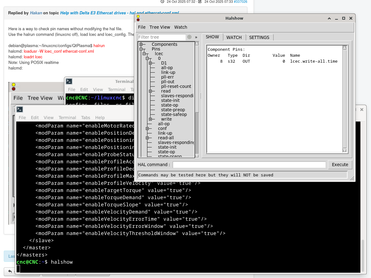

- SPH
- Posts: 109
- Thank you received: 6
24 Oct 2025 10:49 - 24 Oct 2025 10:50 #337038
by SPH
Replied by SPH on topic Help with Delta E3 Ethercat drives - hal and ethercat-conf.xml
Here's the result of halshow after following your instructions. Is my drive perhaps not defined correctly or something like that? I don't seem to have any pins like your screen shot shows.
Last edit: 24 Oct 2025 10:50 by SPH.
- Hakan
- Posts: 1317
- Thank you received: 454
24 Oct 2025 11:19 #337040
by Hakan
Click the D1 node. Obviously it is called D1 in ethercat-conf.xml
- SPH
- Posts: 109
24 Oct 2025 12:13 - 24 Oct 2025 12:14 #337045
by SPH
*facepalm* I must have clicked every option except that one.
Well at least now I understand how to rename the drives in the xml file to make organising things simpler.
Here's the output from halcmd show pin
What are the basic pins I need for motion?
And a massive thank you to everyone who takes the time to offer help and guidance, it's genuinely amazing.
