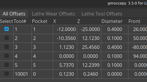

(Solved) Probe Basic - HAL pins not being created
Category: QtPyVCP
Ok, HalLedIndicator is now showing up in halshow.
Every time I tried to edit probe_basic.ui I couldn't save it due to permissions.  And trying 'sudo editvcp probe_basic' resulted in an error before opening.
Had to
  • make a copy of probe_basic.ui and probe_basic.qrc
  • paste copy in some non-root folder
  • open sudo -thunar and rename the original
  • open the copy in vcp
  • open the user_tab.ui file and edit/save both ui files
  • using sudo-thunar paste the probe_basic.ui & .qrc file copies back in to the python3/dist-packages/probe_basic folder.
I suspect my earlier failure is that I didn't have probe_basic.ui open, or the right .qrc file in the right place.
The user tab is not showing up on the screen (see attached), but at least I've made some progress.
Category: QtPyVCP
so the dro's were not really meant to be customized in that manner so they went last in the loading sequence using a timer to stop any conflicts during load, that being the case the hal widgets do not get registered for the dro ui's only for the usertab uis.. i will see if there is some magic i can do to include the dro's and post back when i have an answer on it!
Category: QtPyVCP
works fine!  how are you creating things?  are you opening using editvcp probe_basic and then opening the user ui?
No, I edited the user ui directly.  Sounds like that may be my problem.  I'll have another go at it and report back.
I'm on trixie, did a pull just a week or so ago so I should be up to date.
Category: QtPyVCP
maybe try bringing over the latest user files, there have been some changes and some may no longer be up to date with the porting we did.  the testing i was using used the latest develop branch for the trixie debian 13 probe basic for reference, i do not have a bookworm machine at the momenht while im working on another project so cannot test there if that is what you are on. if so i would recommend updating to the trixie version
  • Lcvette
  • Lcvette's Avatar
03 Sep 2026 02:12
Category: QtPyVCP
  • spumco
  • spumco
03 Sep 2026 02:07
Category: QtPyVCP
Awesome, thanks!
Can you try a HalLedLight and see if it shows up too?  That'd confirm I'm off the rails somewhere.
  • Lcvette
  • Lcvette's Avatar
03 Sep 2026 02:01
Category: QtPyVCP
here it is working.. i did not change anything at all just dropped the halbutton widget in the usertab and gave it a pinbase name saved then started probe basic and everything was there!
  • Lcvette
  • Lcvette's Avatar
03 Sep 2026 01:57
Category: QtPyVCP
ok i just tested and i see the test button i created in halshow, i can set and clr it to enable and disable it, it is under Pins/qtpyvcp/hal_test_button. sooo it is working here, not sure what you might be doing differently?
