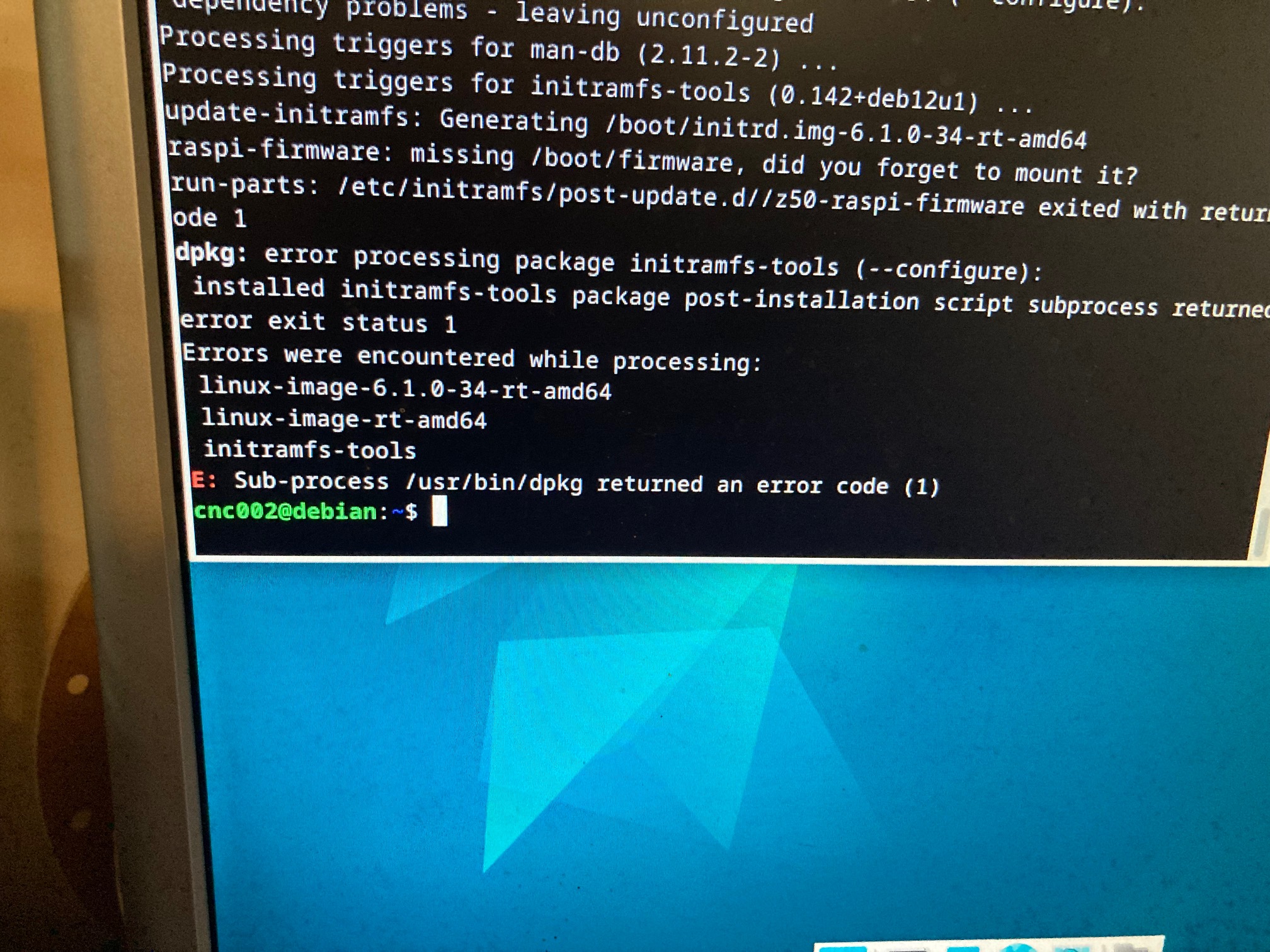

08 Aug 2026 18:03
Replied by tommylight on topic Update and upgrade debian bookworm.
Does the error report mention "raspi" anywhere?
