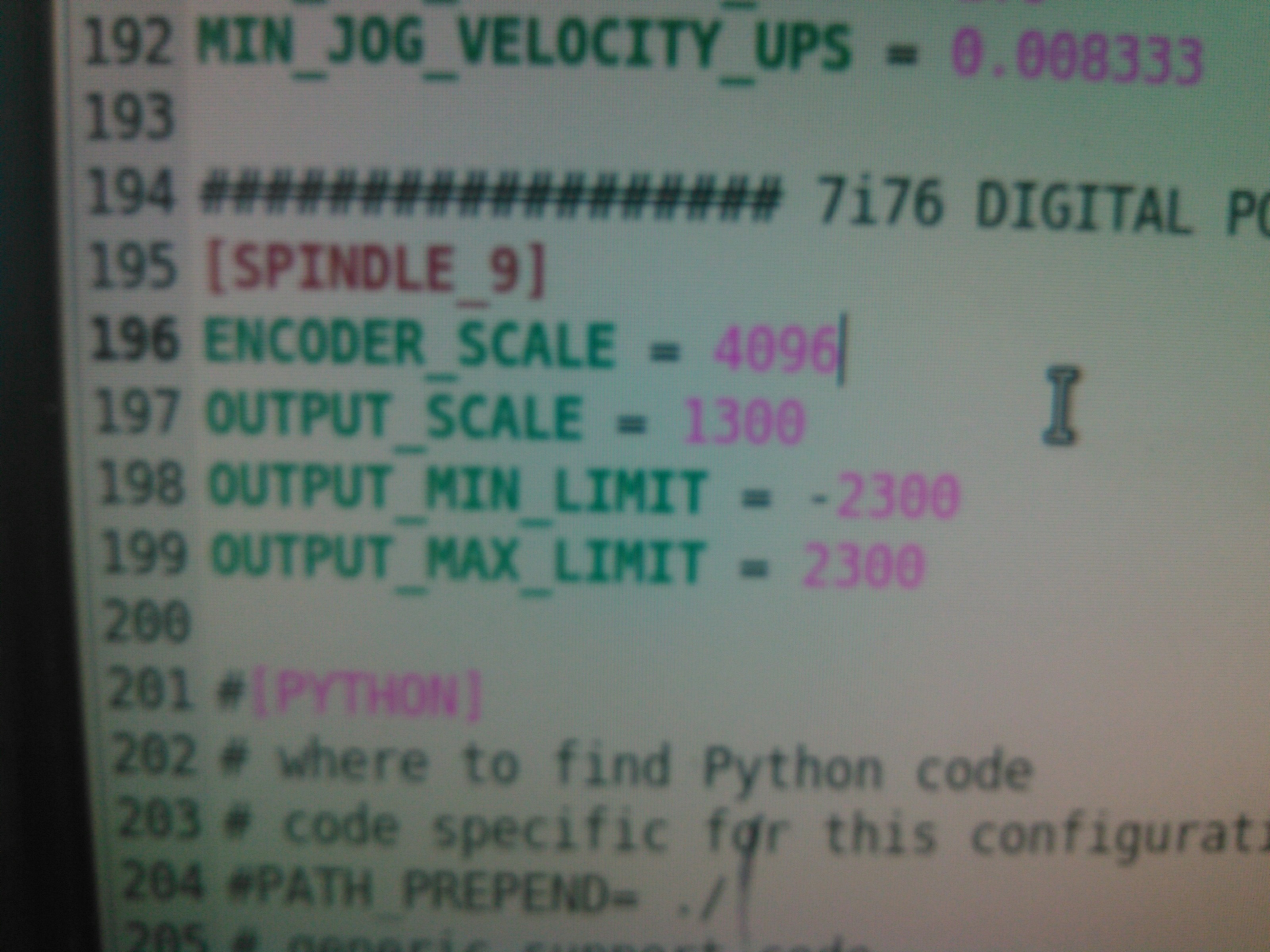

I set the encoder scale to negative in the ini file, it change the count direction in path pilots encoder count readout but hal stayed the same.

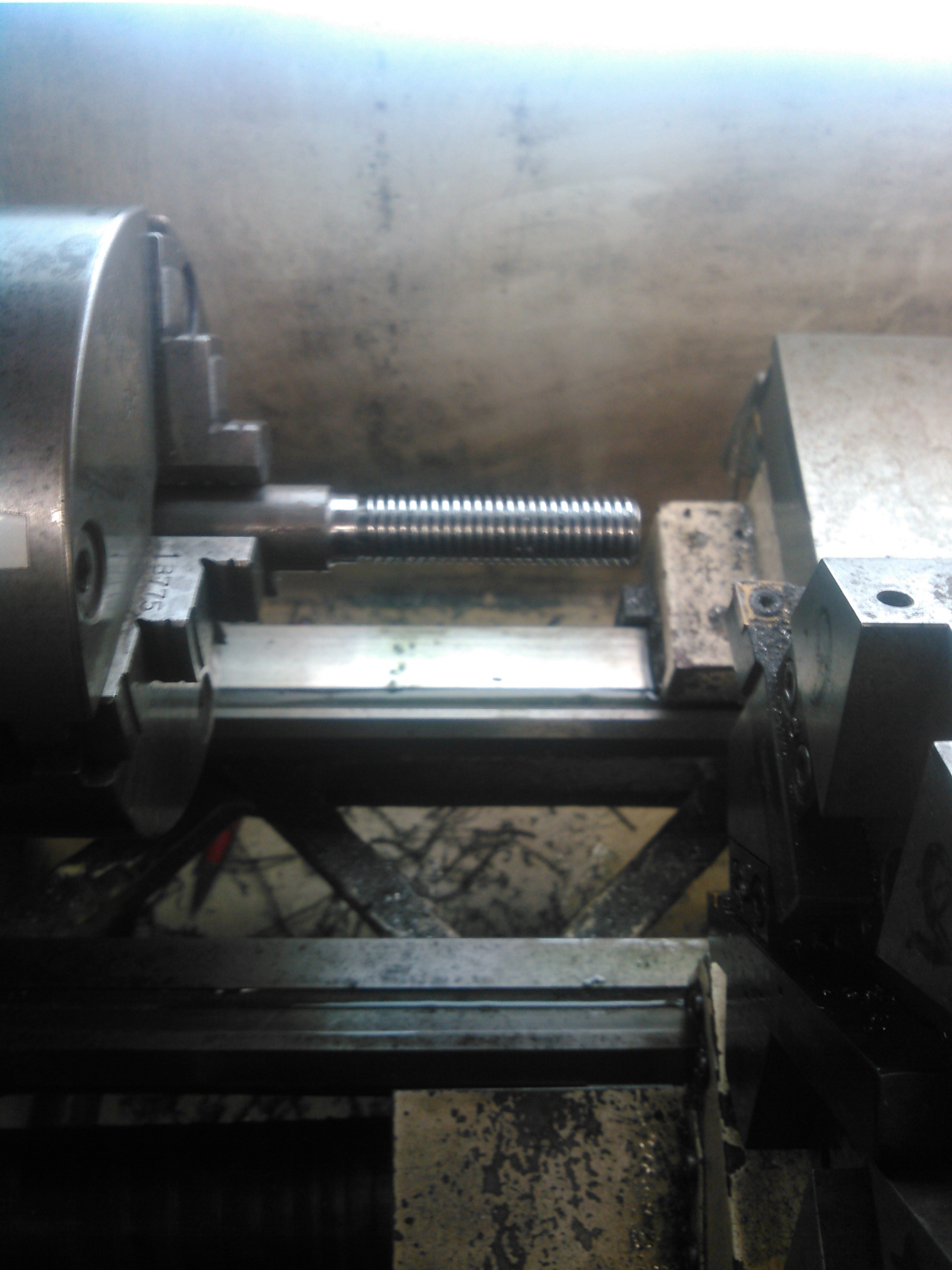

I changed the wires around. I've owned this lathe for 10 years and this is the first time it has turned the outer diameter and changed tools and then threaded. :) :) :)
Thank All of you for helping me get this working !!
