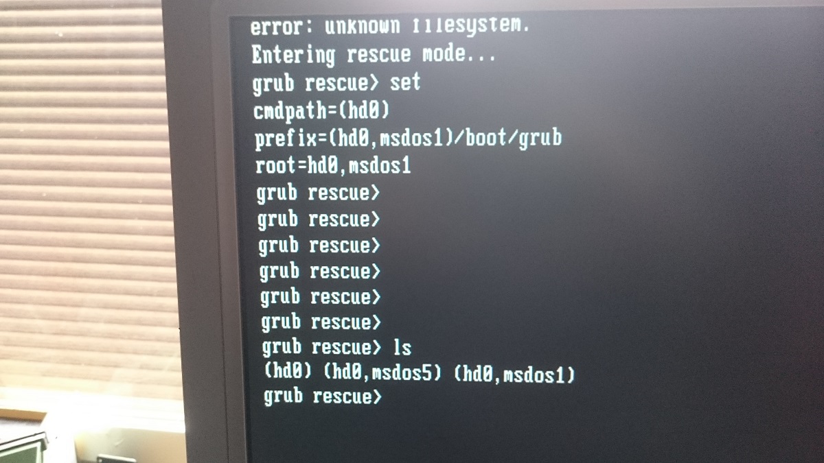

Obviously MrMurphy was here, disconnected my PC in workshop to work here in my office and my SSD went south.
Works OK with other HDD and non RT LCNC and WiFi is also working.
error: unknown filesystem.
Entering rescue mode...
grub rescue > blinking prompt
Is there a way to rescue?

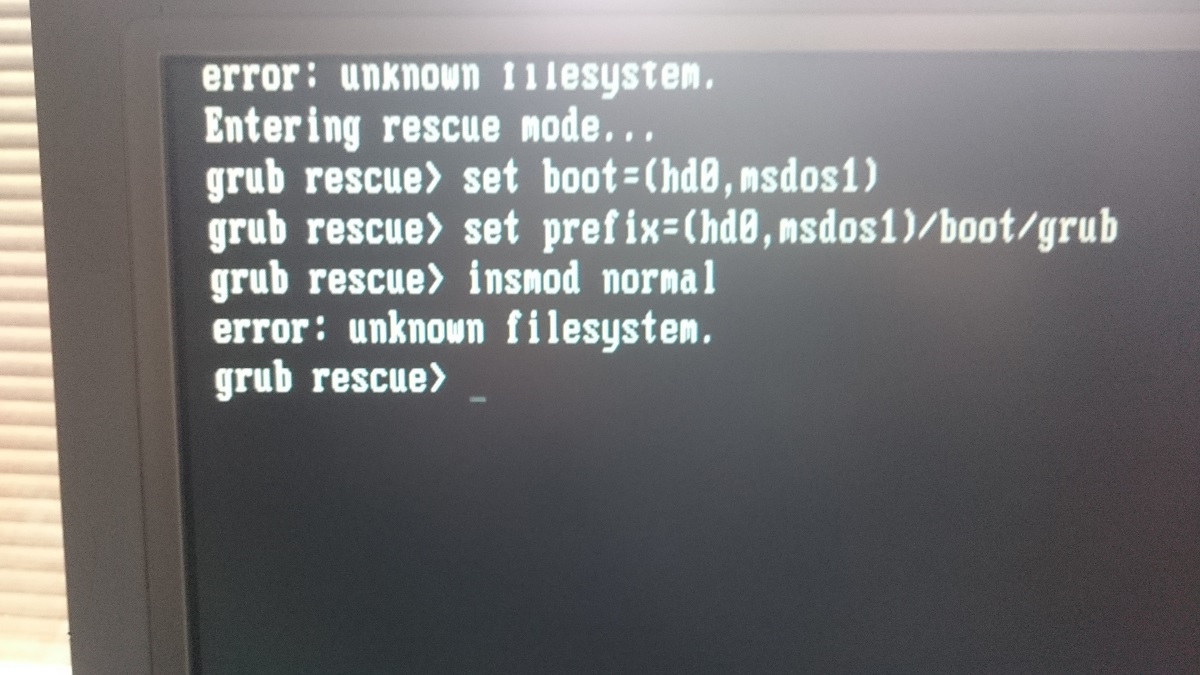

Found info on Youtube
use this:
1. grub rescue/ set boot=(hd0,msdos5)
2. grub rescue/ set prefix=(hd0,msdos5)/boot/grub
3. grub rescue/ insmod normal
error: unknown filesystem <<<<<<<<<<<<<<<<<<<<< errors our after step 3
4. grub rescue/ normal
ls
(hd0) (hd0,msdos5) (hd0,msdos1) <<<<<<<<<<<< so what to use?
use this:
ls

Taking an educated guess I am going to say that
(hd0,msdos5) is your swap partition
(hd0,msdos1) is your root partition
(hd0,msdos1) would be the one you want to deal with
Grub can be a bit of a pain sometimes
This page has some good info: help.ubuntu.com/community/Boot-Repair
As suggested download the boot repair disk from here: sourceforge.net/p/boot-repair-cd/home/Home/
Read the instructions before doing anything and ask any questions if you feel unsure.
Another option would be to boot linuxcnc from a USB stick and try to mount the drive you have been trying to boot from, do not reinstall linuxcnc just boot.

Downloade Boot-Repair and did run repair.
paste.ubuntu.com/25901798/
Now I get GRUB and boot but a lot of FAILED lines during boot and it is only terminal not graphical.
CNC3000 login:
Can not login
CNC3000 login:
Can not login

Looks like the file system has some major issues.
When you said your ssd went south what actually happened......did have a power outage or did it just raise it's ugly head ?
I'd be inclined to save any configs you have and any other files you deem to be important and try a reinstall. Things appear to have gone quite bad.
Mostly I try to install /home on a separate partition just in case things go bad and you need to reinstall.
Before trying a reinstall I'd download this: www.system-rescue-cd.org/ have a good read through the docs and run some checks on your ssd.
Smartmontools is on the above mentioned livecd....here's some info www.smartmontools.org/wiki/TocDoc
Good luck mate seems you have hit a bit of a bad bump
