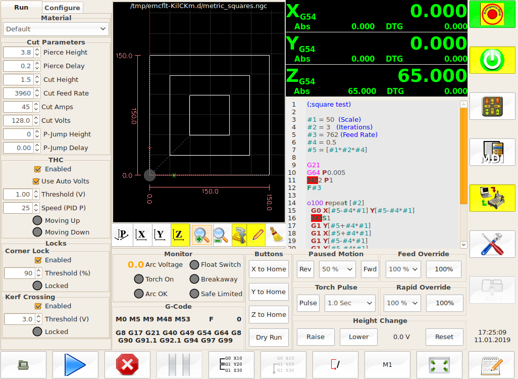

I have pushed an example config for Gmoccapy which is still a work in progress.
It appears under Gmoccapy in the Configuration Selector.
I am not sure about SpinButtons as I do not have a touchscreen so I am not sure what are the correct widgets to use.
github.com/phillc54/linuxcnc-plasmac
Warning: Spoiler!
Cheers, Phill
